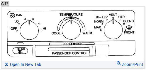

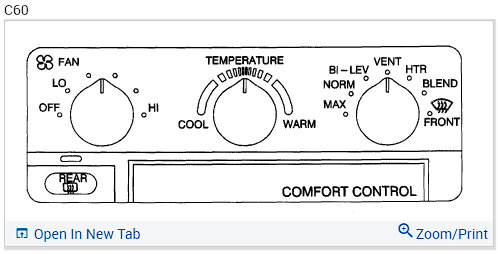

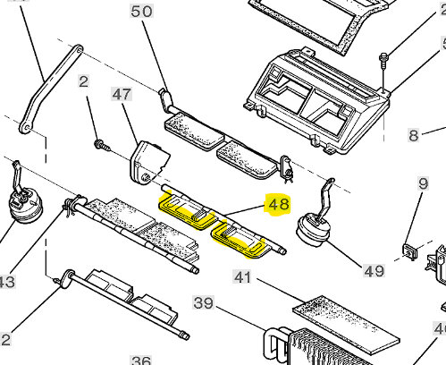

Well, it sounds like the refrigerant system is working well if the suction line is getting very cold. The description you give certainly sounds like a dual zone issue. I uploaded 2 images, could you please tell me which HVAC control head you have? C60 or CJ3? I want to make sure we are diagnosing the right system. Thanks.

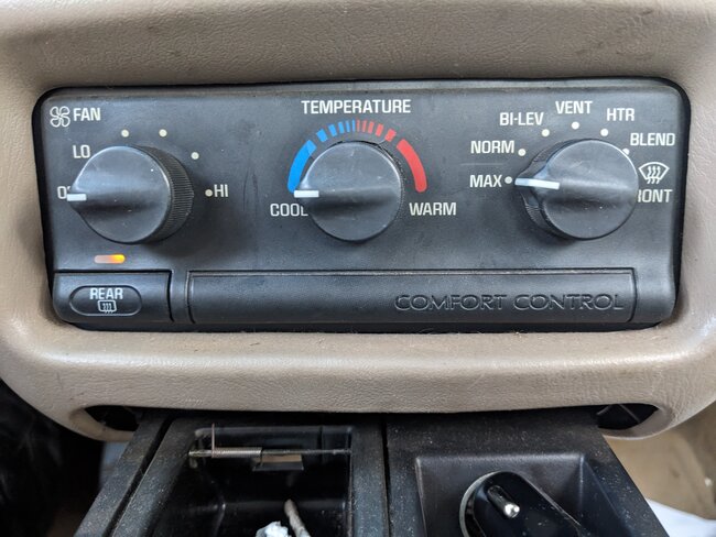

Okay. I did say it was not a dual zone system. Pretty sure I'd have seen a passenger cold-warm slider. But here's a picture.

Thank you very much for the picture. I've been looking through parts catalogs and it looks like they use the same HVAC housing design for both single and dual zone systems. It's possible that the temperature door may not be sealing properly. As you can see in the image there are two parts to the temperature door. The driver's side may be warped or missing insulation. If you have access to a borescope, you might be able to feed it into the vents and see.

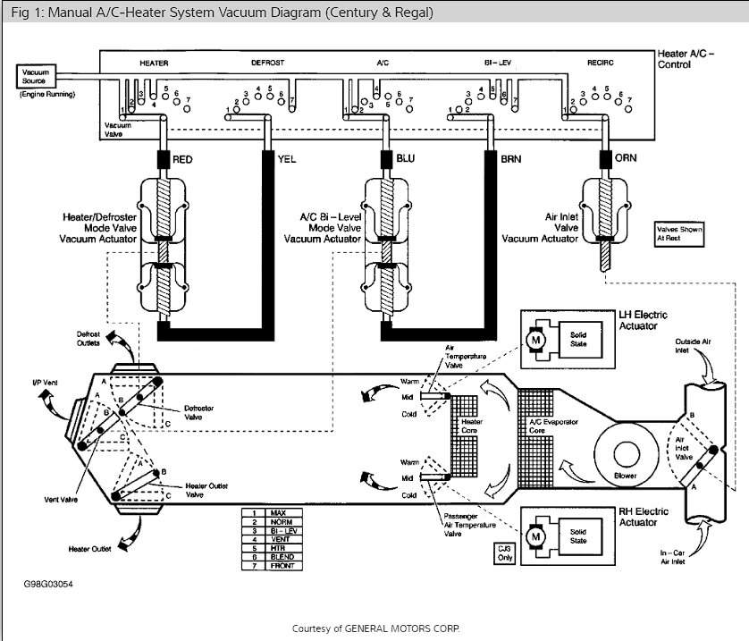

1) this is an older car. Some GMs in the late 90s-early 2000s still used vacuum actuators back there. Is this one of those cars? If so, can I get a vacuum diagram please? The car was sitting awhile and is 24 years old so there could easily be dry rotted lines that aren't holding pressure.

No apology necessary. I think sometimes it's hard to have a conversation by way of the printed word only. Hehe. Anyway, thanks for the additional information. First off, if the refrigerant system is working as it should, it will not cause a temperature difference between sides. You can kind of get the idea about the airflow from the vacuum diagram.
Basically, the temperature door changes or blocks how much air flows across the heater core. On your car the temperature door is controlled by an electric actuator. All of the other mode doors are vacuum controlled.

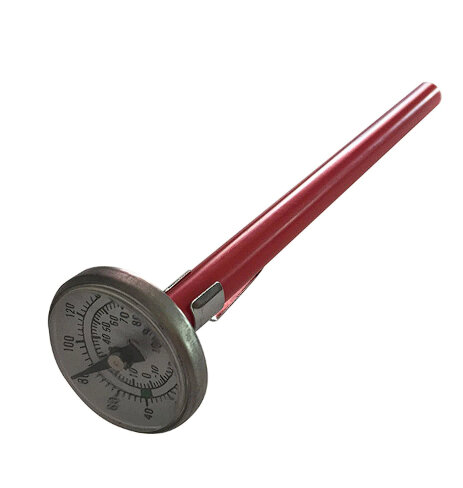

As long as all of the settings work correctly, airflow modes, blower speed, etc. I think your A/C control head is probably fine. The only thing I would say to double check is to see if the temperature goes through it's full range, hot to cold. Start at full cold and move the knob a little at a time and see how it feels. You can pick up a little thermometer pretty cheap if you need one.
So, based on what I found on the parts diagrams and the illustrations in the repair guides, I still think you most likely have a problem with the temperature door itself. Although the door is made as one piece, it still has two separate sealing areas. The duct work seems to be made for a dual zone system as well as single zone.

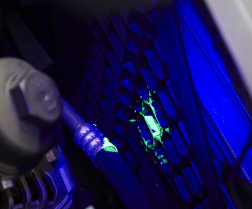

Well, I just poked around in the dark with the UV light. When I took the cap off of the Schrader valve, it nearly blew away. Plenty of green inside the valve and cap too. That's the low side port anyways. I pushed on the valve stem a few times to try and reseat it, but no change. I put the cap back on as tight as possible to try and slow the leak until I can get a new stem.

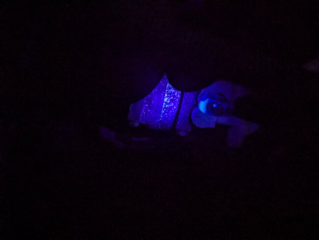

I also found some more questionably greenish stuff around the compressor. I know those are common issues, but I'm not 100% sure that's what I'm seeing. It's not the same shade of green, and I can see hints of it without the UV light. And there's 0 wetness around it. I'm adding a pic of that here. Keep in mind, I did it with my phone reaching way down into a hot engine bay with my Incredible Hulk hands, so the pic isn't great.

That doesn't look like the compressor is leaking to me. Porous aluminum will show that speckled pattern. Go ahead with the Schrader valve replacement. You'll need a way to recover the old refrigerant and pull a vacuum on the system before recharging the system.
