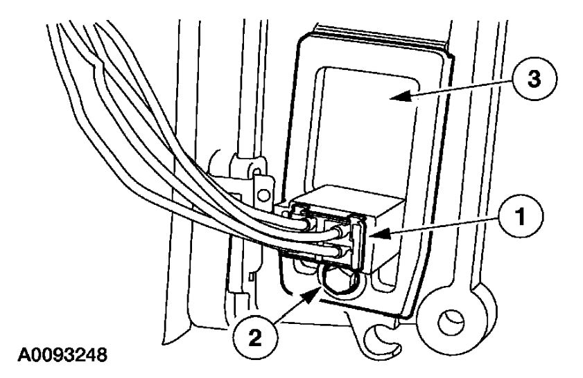

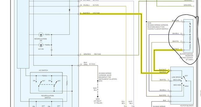

The compressor kicks on but nothing blows out the air vent. When I turn the A/C switch to second setting the A/C light goes out and A/C compressor kicks off, cold air blows out for just a few seconds and then turns to hot air out the vent.
Aug 10, 2019 at 2:01 PM
Good afternoon,
This sounds like you have a bad blower resistor. It is right behind the glove box door. I attached a picture for you.
I attached a wiring diagram as well.
You can get the part at any parts store.
Aug 11, 2019 at 5:44 AM

SILVERFOX14
You hit the nail on the head problem fixed. Thank you again.
