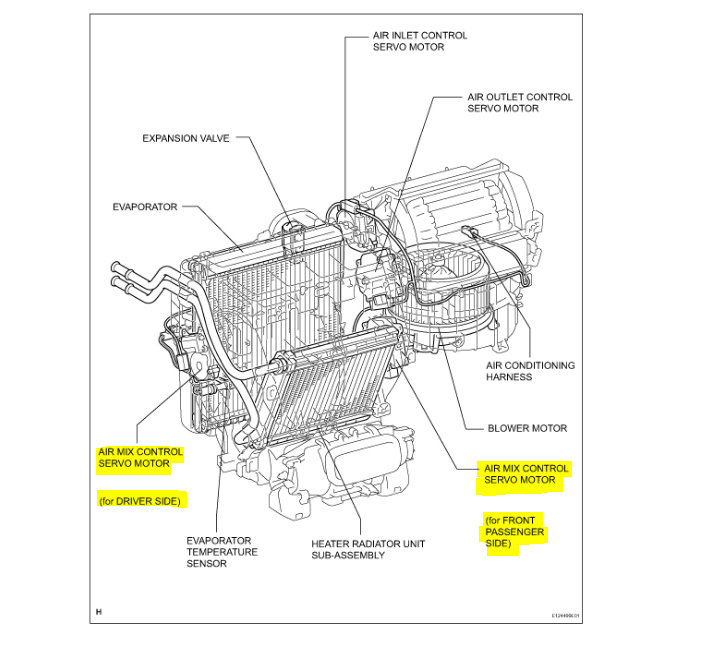

The only A/C vents that work on the car are the legs and front defogger and the mode selector switch does not appear to change the mode. The mode selector switch blinks for about 30 seconds when i start the car and then stops blinking and the A/C comes on. I have both hot and cold air. My car has single manual climate control. I tore up the driver's side but could not see the servo motor on the driver's side.
Sir, my questions are:
where will i find the door actuator for the mode selector in my Toyota Camry LE, 2007 model?
How to proceed with fixing it?
I really appreciate your help, time and effort.

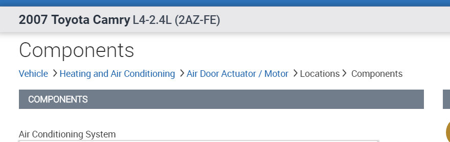

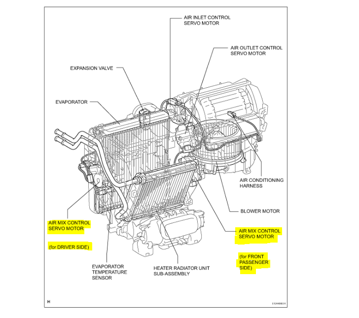

In the diagrams down below I have included a diagram of your vehicle's Heating Ventilation and Air Conditioning (HVAC) system. I have the actuators in question highlighted for you. I have also included a link below for you to go to down below.
Please go through these guides and get back to us with what you are able to find out.

Which motor should I go after? which one is at fault if I cannot change the mode on the A/C air flow?

The air outlet control servo motor.

I can see the part i need to change. I cannot figure out how to remove the A/C duct that is directly in front of the actuator.

I don't have any instructions for how to do this in either of the two reference materials that we use. They should either snap into place or may have a few screws or small bolts holding them in place. I'm sorry, I can't be of more help here for this. Please keep us informed as to how things are progressing.
