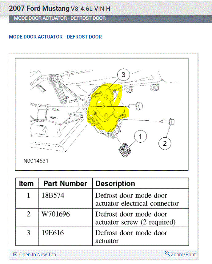

It sounds like there is a problem with the mode door actuator. This actuator is what changes the airflow direction.
To get you started on the repair, take a look through this link. It covers in general how to repair this issue.
https://www.2carpros.com/articles/air-vents-stay-in-the-defrost-position

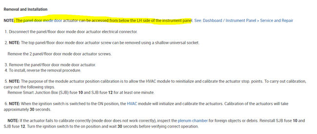

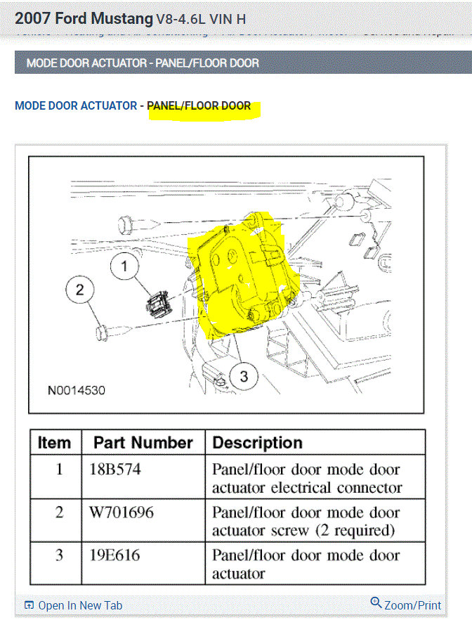

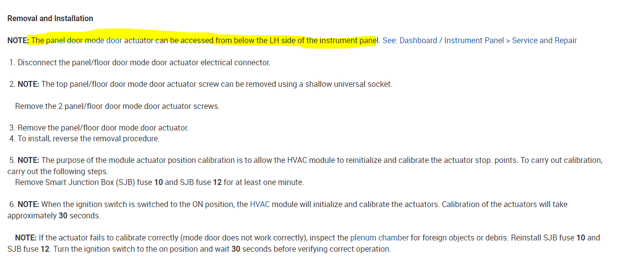

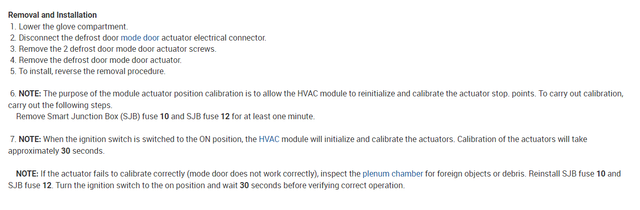

Now, this vehicle has a mode door actuator for the defroster door and one for the floor and vent. Here is what I would suggest. Remove the floor/vent actuator and see if it responds when you change airflow directions. Do the same with the defroster actuator if the other one doesn't work.
I attached directions for the removal and replacement of both in the attachments below. The defroster mode actuator is behind the glove box. The floor/vent actuator is on the left side of the instrument panel. Both are attached to the HVAC unit.

You mean remove the connector or remove the whole actuator? I removed the harness of the defrost one and nothing happened. And when you see the other one is on the left of the instrument you mean on the driver side?

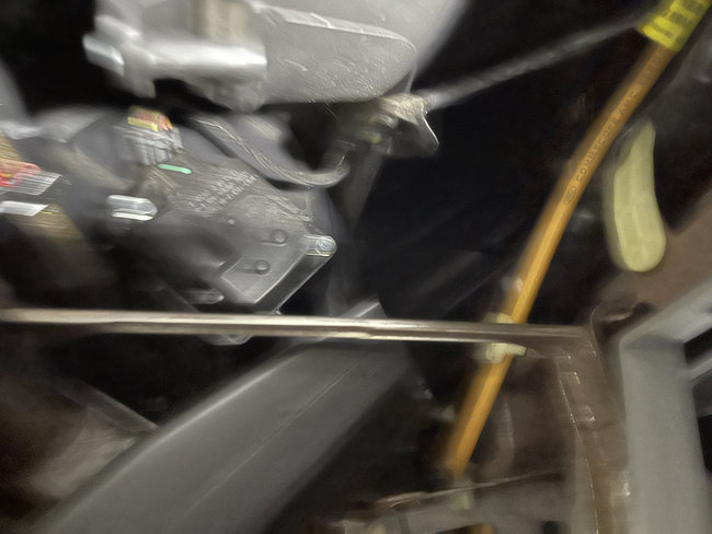

This:

Yep, the driver's side is correct. And I believe your picture shows it.
When checking these, it's easier to have the actuator removed to see if it responds when you change settings.

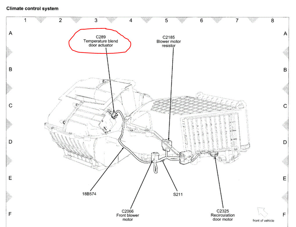

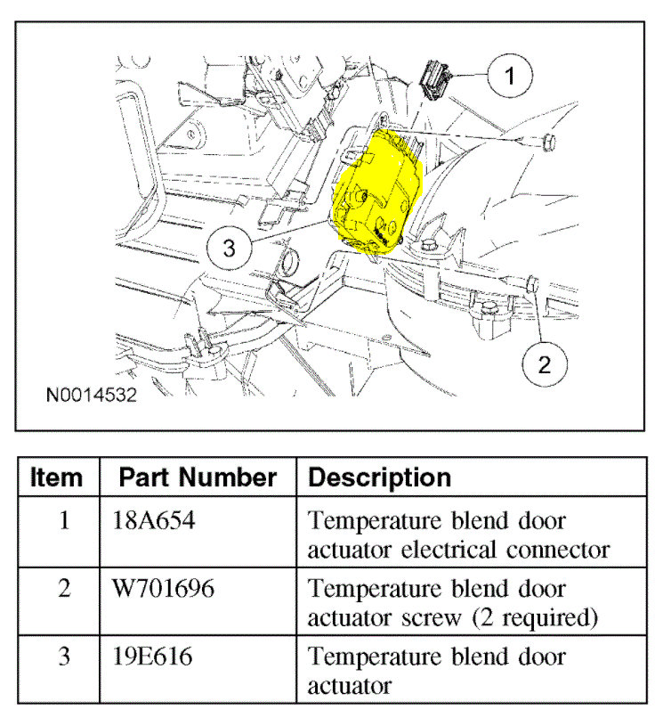

Do you know what flap controls the heat/cold? Air coming out of vents now at decent amount, but it is not hot at all. I may have done something while working on these vents.
Tuesday, December 21st, 2021 AT 9:04 AM
  • 110,068 POSTS
The blend air door is responsible for air temperature. I attached two pics below showing the location of the actuator. The door is behind the actuator.
