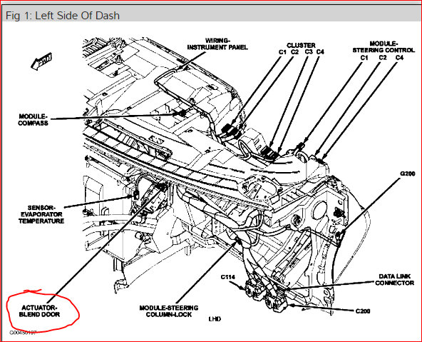

During driving all of a sudden my AC starts blowing air to the floor for few minutes then came from the defrost vents only. Nothing coming from the dash. Can it be all three blend door actuators damage? In the past there were some clicking noise coming from under the dash board.
Sep 19, 2018 at 11:34 AM
DANNY L
  • 5,648 POSTS
Hello, I am Danny.
Yes, it sounds like you are having a problem with the blend door actuator. I have attached a picture of it location and a tutorial show what is involved to replace. Hope this helps and thanks for using 2CarPros.

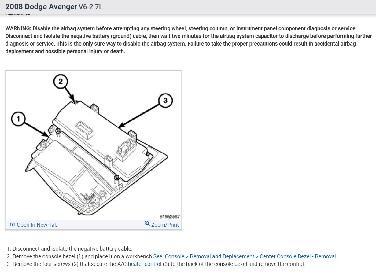

I’m having the same problem with my car. But the only things is that I already replaced all 3 door actuators. Could it be that one of them has stoped working or could it be something else.
Sep 1, 2019 at 12:36 PM
  • 55,168 POSTS
It sounds like the control head is out and needs to be replaced. here are the instructions in the diagrams below. Please let us know what you find. We are interested to see what it is.
