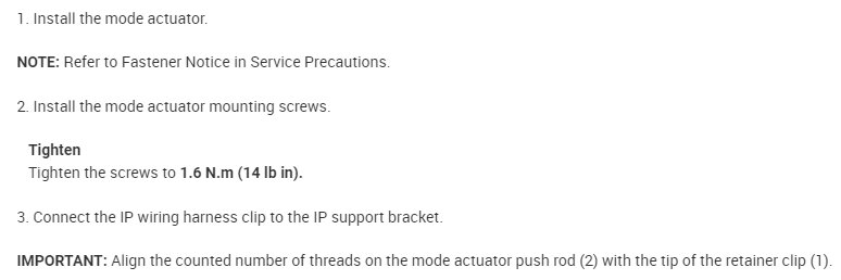

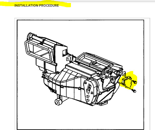

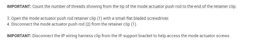

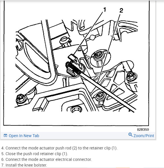

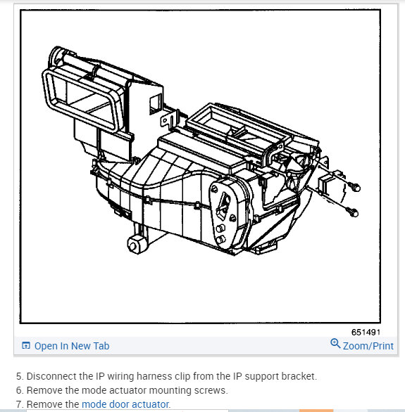

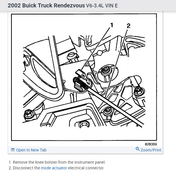

Based on the description, the problem seems to be related to a mode door actuator. This actuator is responsible for changing the airflow direction.
Take a look at this link. You may find it helpful.
https://www.2carpros.com/articles/air-vents-stay-in-the-defrost-position
Next, I attached the removal and replacement directions below for a manual climate control system. If you have automatic climate control, let me know.
