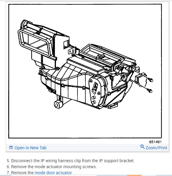

The AC/heater blows just fine, but only through the defroster and through the back vents slightly but not at all through the front facing vents. please help. Thank you all in advance!
Apr 27, 2023 at 11:00 AM
  • 110,244 POSTS

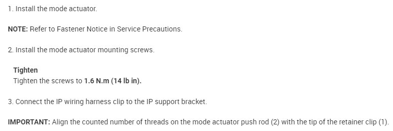

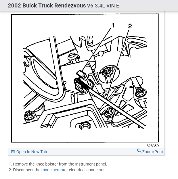

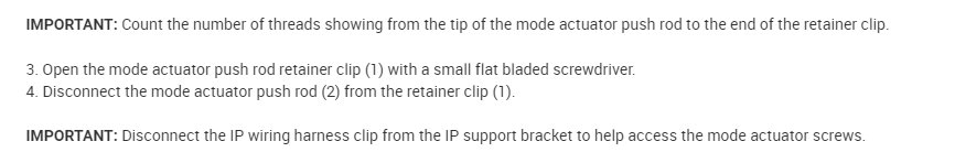

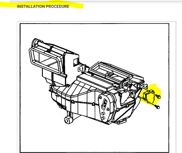

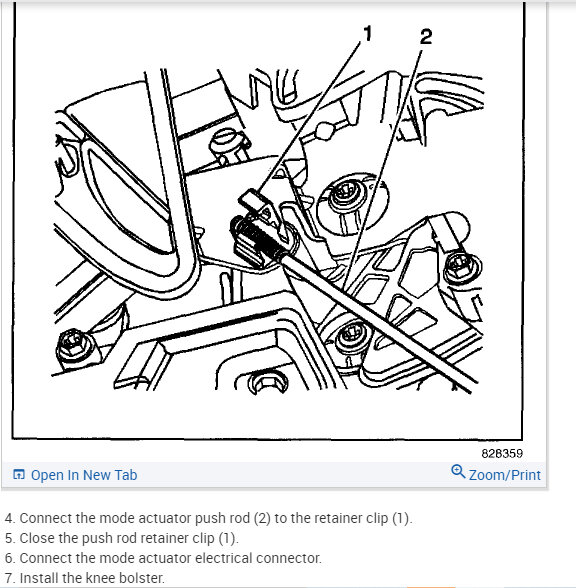

Based on the description, the problem seems to be related to a mode door actuator. This actuator is responsible for changing the airflow direction.
Take a look at this link. You may find it helpful.
https://www.2carpros.com/articles/air-vents-stay-in-the-defrost-position
Next, I attached the removal and replacement directions below for a manual climate control system. If you have automatic climate control, let me know.
