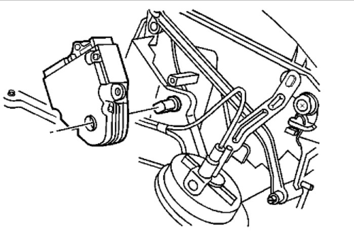

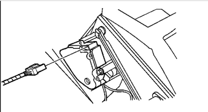

A/C unit climate control blows cold air on the passenger side hot air on the driver side.
Aug 5, 2017 at 3:24 AM
Experienced Mechanic
55,711 POSTS
You have a blend door actuator that has gone bad. Here is a guide to help you get the problem fixed:
Here are some diagrams (below) that will show you on your car.
