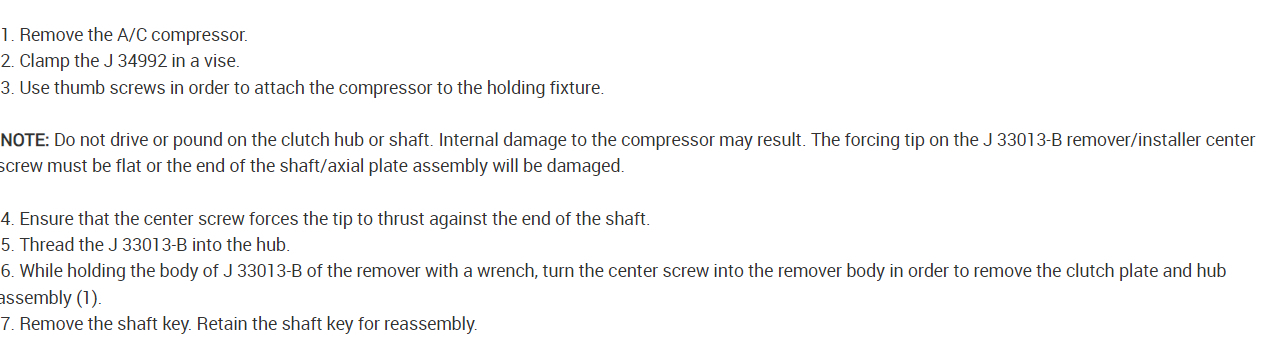

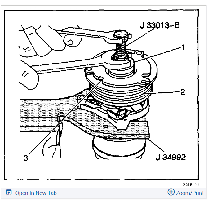

Thanks for the advice, guys. i checked the compressor and sure enough my clutch isn't engaging. My refrigerant levels are good so i think with your help I've solved the problem. I'm going to order a clutch and intend on doing the install.is there any certain steps or tools I will need to perform the job. and thanks for the insight. every time I've come to 2CarPros my problems get resolved. Very Professional!
Sep 26, 2024 at 3:10 AM
  • 55,447 POSTS

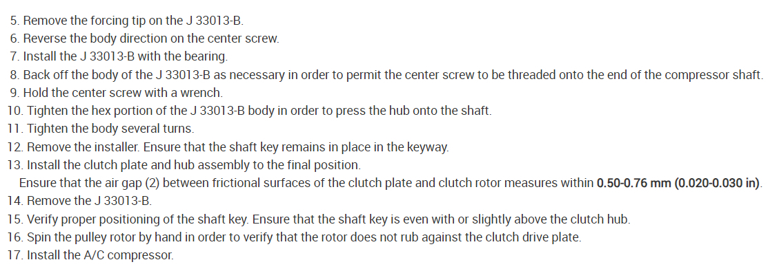

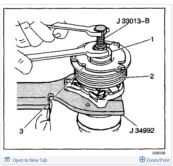

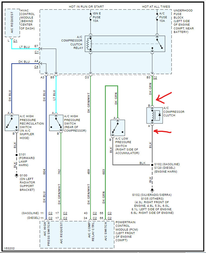

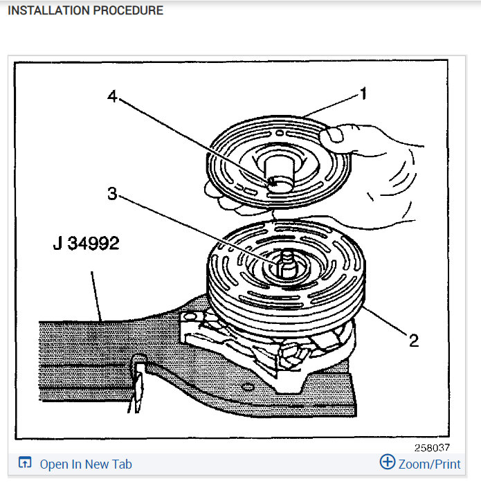

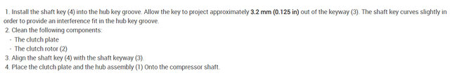

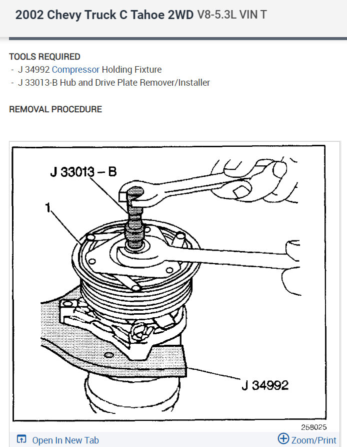

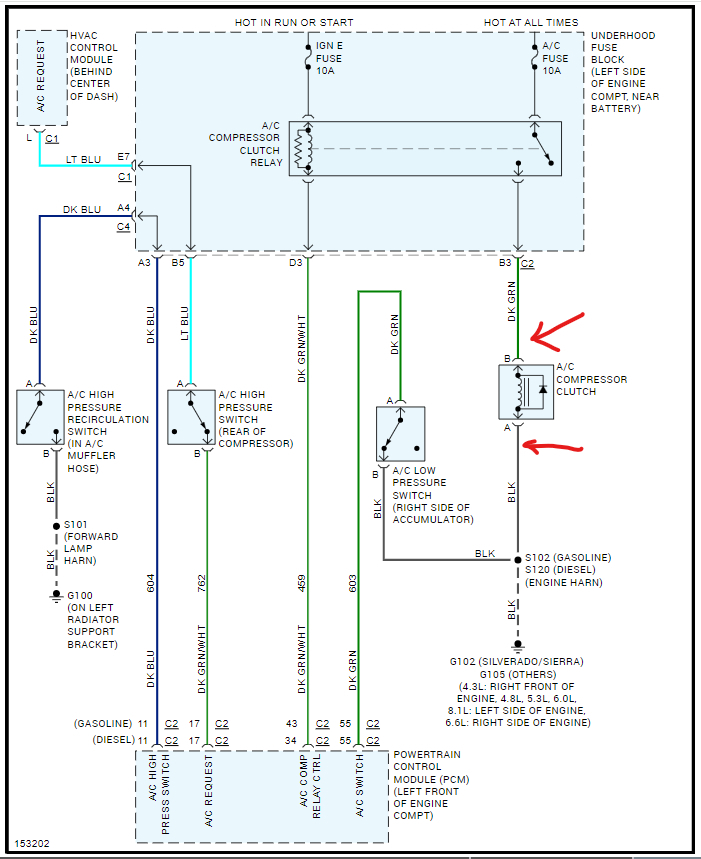

Thank you for your comments :) we try to do our best. Here is how to change out the compressor clutch and coil to help fix the problem, but to be sure the clutch is getting power with the system on with a good ground correct? This guide can help:
Check out the images (below). Let us know what you find.
