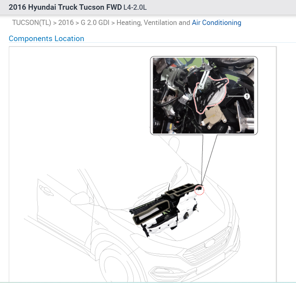

Just purchased the vehicle listed above and as soon as I drove it off the lot the A/C temperature started fluctuating from ice cold to kind of cool. I took it in, and they put a new compressor in then I got it back and was still doing same thing, so I brought it back. Then they claimed to flush out the system 2x and recharge it. They did not see any fluctuation after driving for about 15 miles and car idling. I had it back for a week and am noticing it doing it again just not as frequent. I'm in AZ and the temps have gone from high 80's to mostly high 90's with a few days in the 100's it is noticeable on all days.

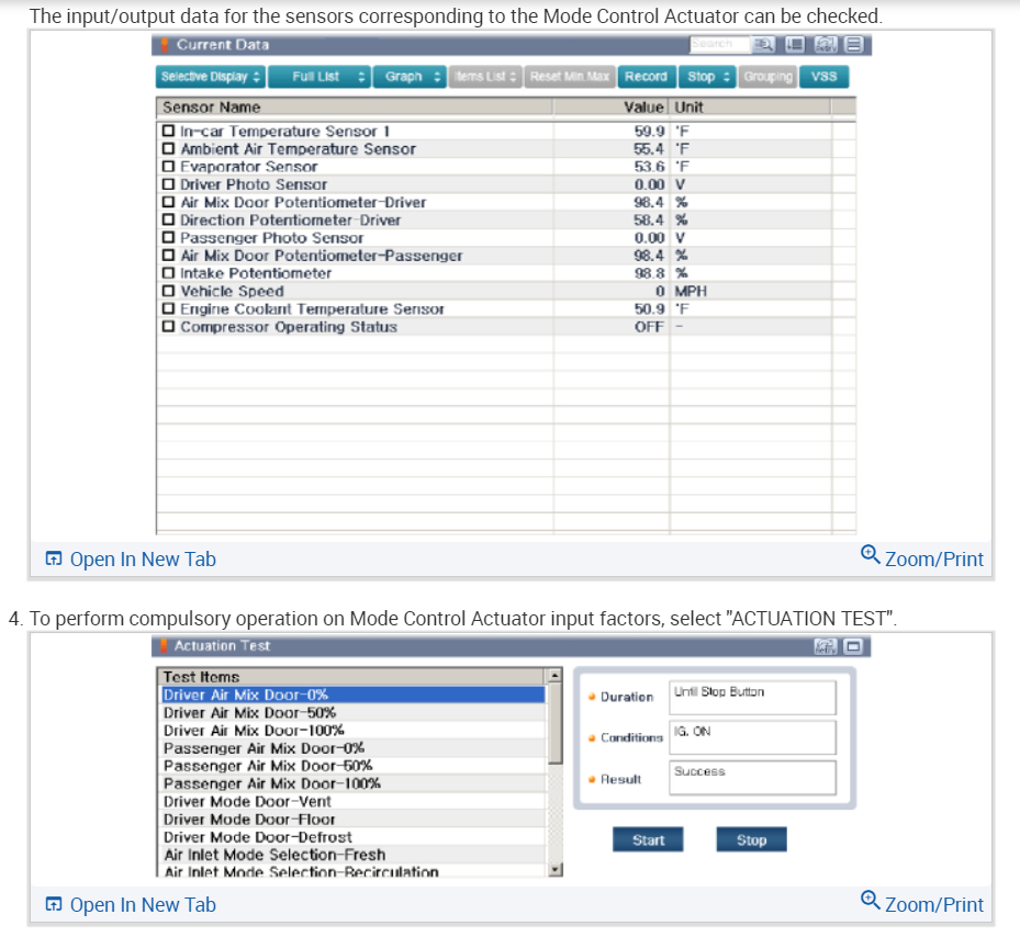

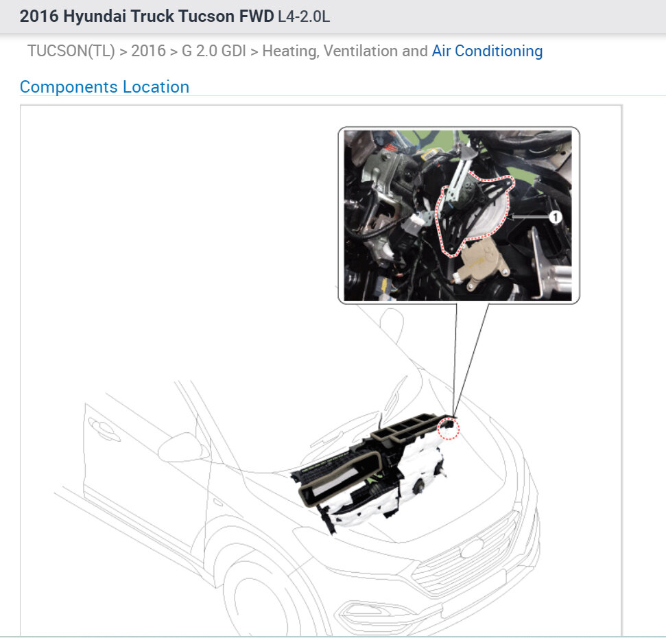

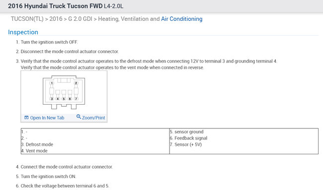

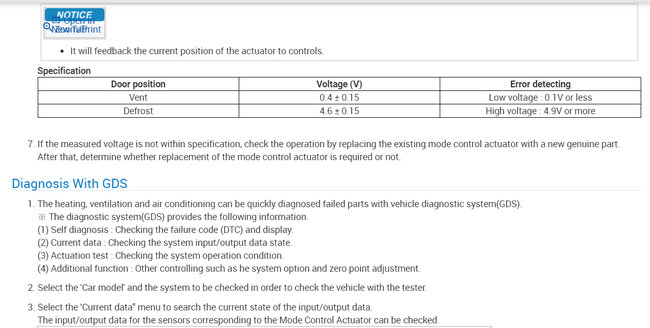

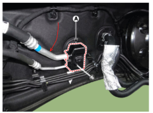

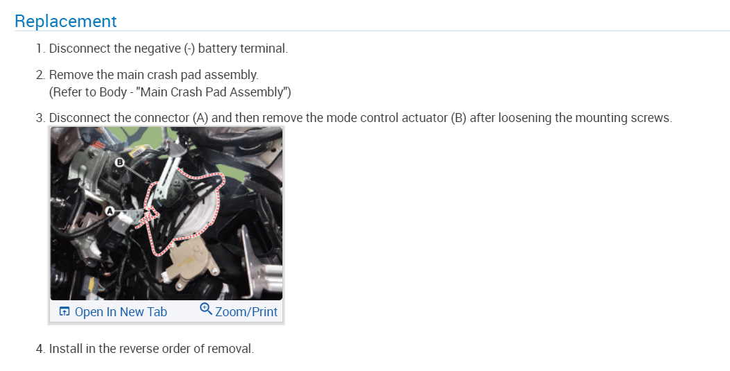

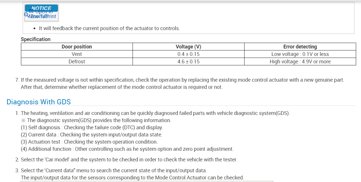

When the system seems to be not working correctly, I would lift the hood and at the fire wall grasp the large refringent tube, it should be cold if the system is full, also listen for the condenser/radiator fan which should be on. If it is cold and the fans are on the refrigerant side is working correctly and the problem lies in the air management system aka the temperature blend door actuator is malfunctioning. Please check out this guide as well:
https://www.2carpros.com/articles/comprehensive-guide-troubleshooting-intermittent-automotive-air-conditioner-problems
