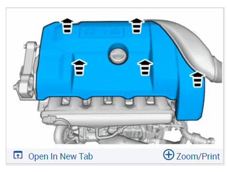

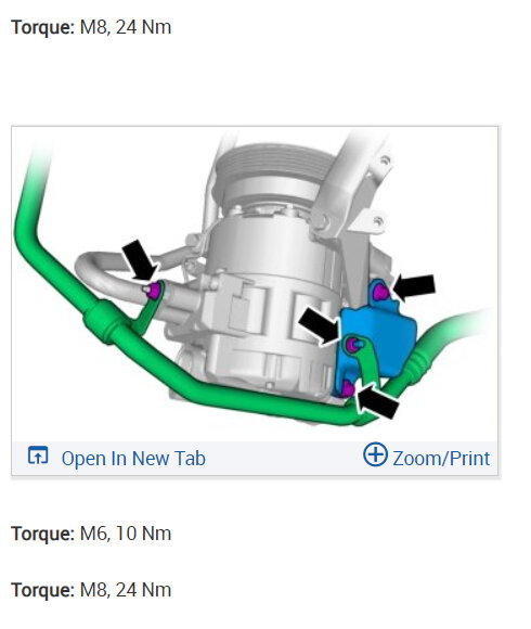

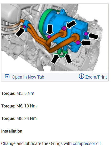

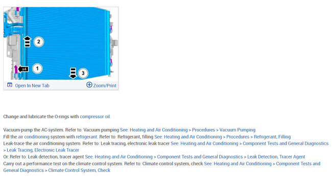

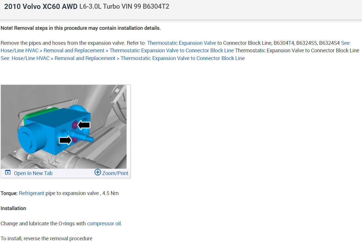

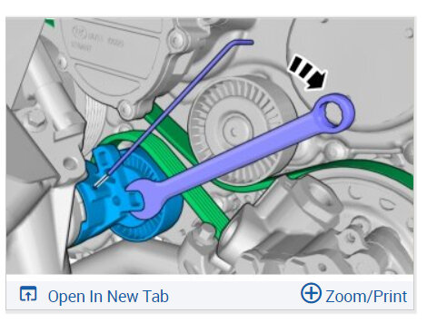

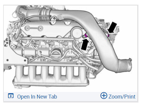

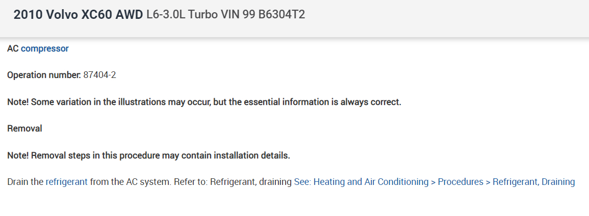

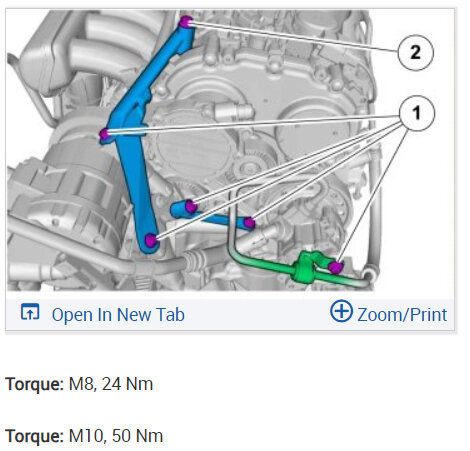

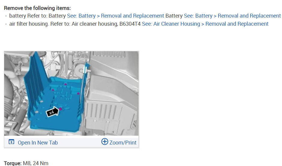

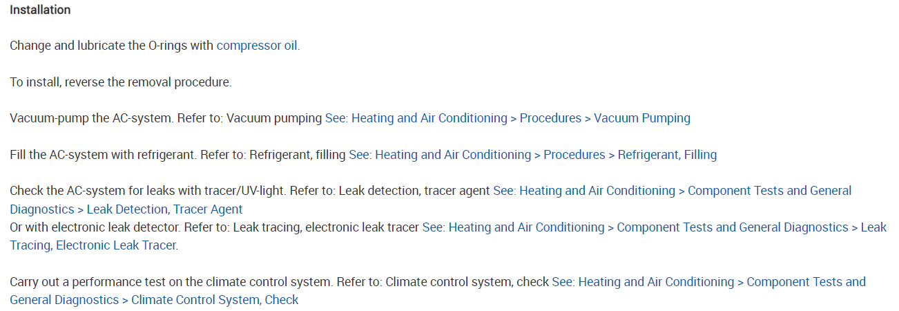

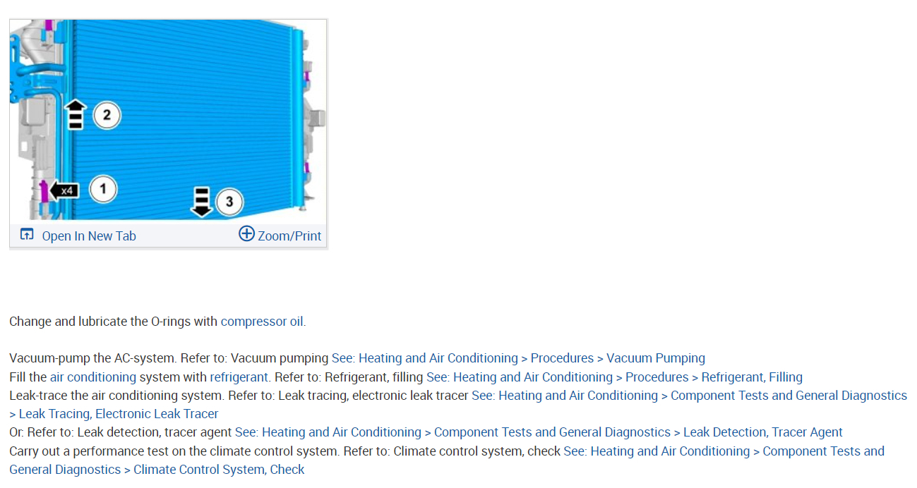

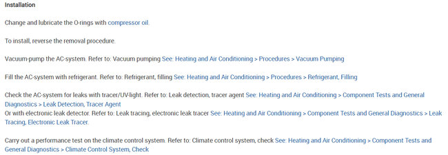

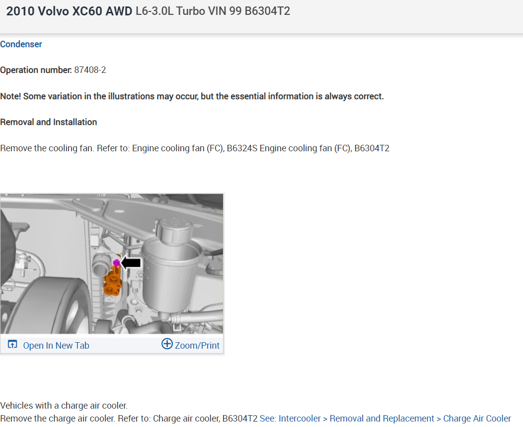

When I replace the compressor and condenser do I need to clean out the lines before installing the new components? Do I need to replace the expansion valve as well? How do I remove the condenser on this model car? Thanks!
Jul 21, 2024 at 8:07 AM
  • 55,433 POSTS
Yes, anytime the compressor seals are spread throughout the system you need to flush the lines, replace the receiver dryer and the expansion valve. They sell A/C system flush at the auto parts store. Here is how to remove the condenser, expansion valve and compressor and this video should help the vacuum down and recharge.
https://youtu.be/4EqdrBVb0sY?si=NHqmLtwslZM9KNWW
Check out the images (below). Let us know how it goes.
