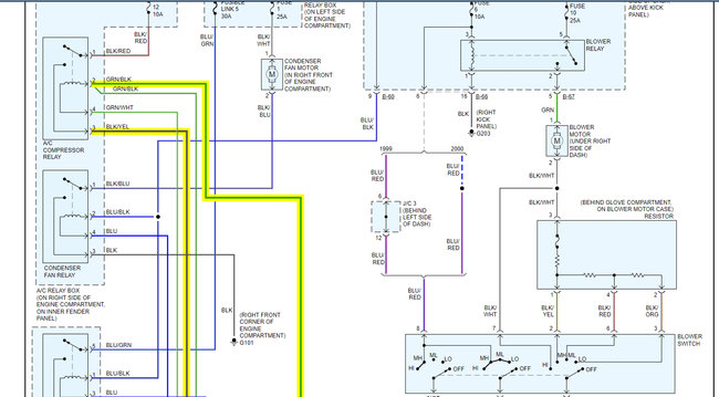

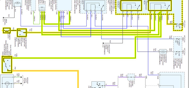

Do the 2 relays for the A/C system in the car listed above always have 12 volt power going to them even with the key off and removed from the ignition? There are 2 relays and 1 10 amp fuse.
Both the A/C clutch and condenser fan relays have 12 volts present at all times.. Key on, key off and removed.
Would this mean a worn ignition switch, or perhaps a ECM problem?
Apr 8, 2021 at 3:26 PM

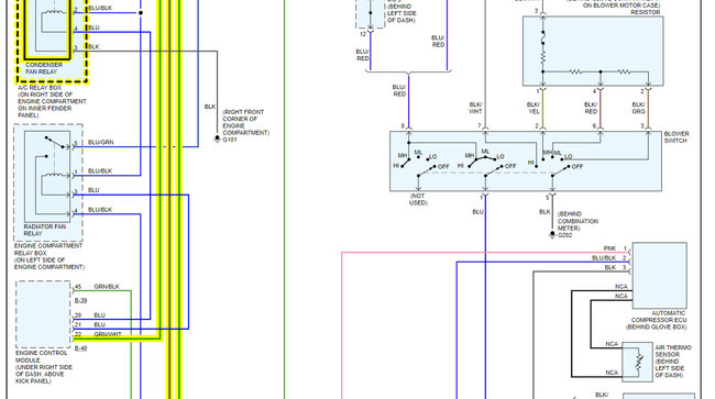

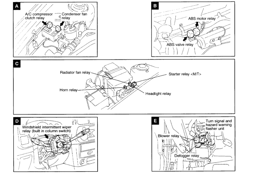

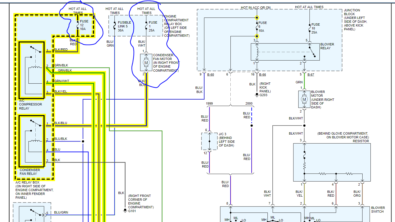

Good afternoon,

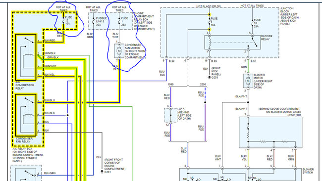

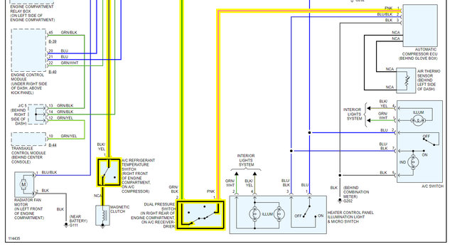

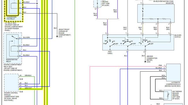

I attached the wiring diagram for you of the relays.
Yes, they should have power to them when the key is off. The fuses that supply power are hot all the time. I circled that for you.

Follow the guide for the relay test. If you power a ground, you will damage the relay so be careful jumping out the pins.
I would start by checking the high and low side pressures on the system to be sure there is enough pressure in the system.

Thanks Roy, I'll double check my hi/lo pressures. I have a manifold gauge set, so no worries. Question about the 2 relays in the A/C box (fig A) w/1 10 amp fuse.
If those relay's are always hot, wouldn't that mean the relay is always energized, thus closing the circuit and sending power to the A/C clutch? When you turn the dash button on for A/C, just what is it turning on if the relay's are already hot?
Plus in 3rd diagram, left side, there is a J/C 5 located behind right side of dash. Passenger side with 12 13 14...what is that item?

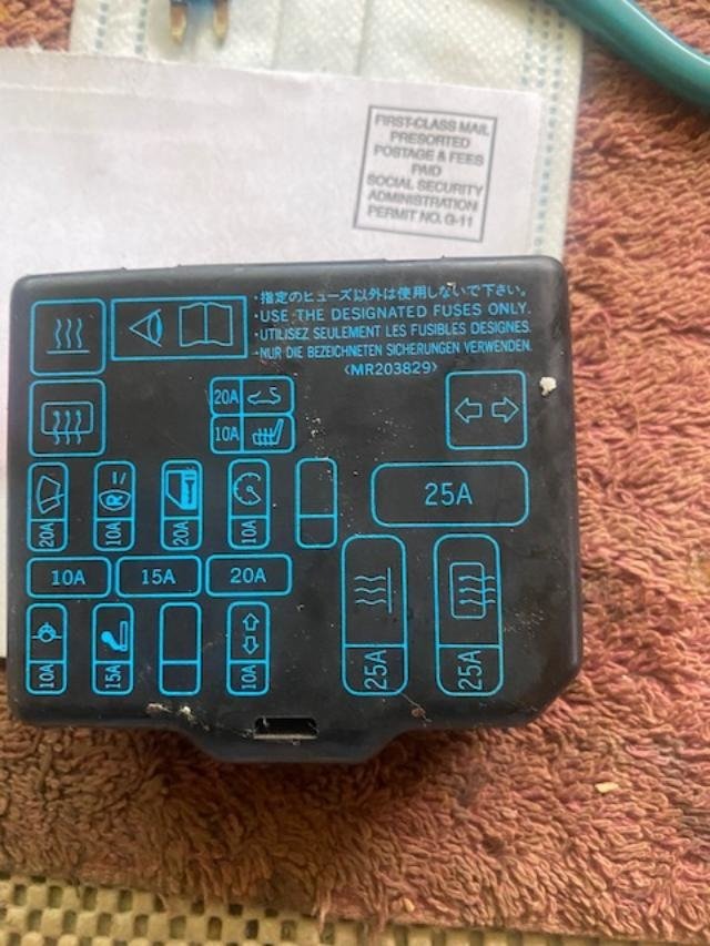

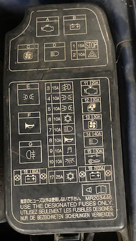

Is there a fuse in the box under the drivers side that plays any roll in the A/C system?
I don't think there is, but worth asking.

Okay, again, there should be power at all times to the pins. That is normal. So far, I see no issue with the relays.
Did you check for power to the fan motors ?

I can jump pins 1 and 3 on both relay's (assuming they are pins 1 and 3) and I can engage the compressor clutch, and I can engage the condenser fan. They continue to work okay.
Pins 2 and 4 don't seem to be engaging the relay as they should. So whatever feeds those 2 pins in each relay is perhaps part of the problem??
As a footnote: I did swap out the ECM today, and installed my original ECM when the car had some other issues only to find those were really more or less self inflicted problems. since resolved. So my original ECM was okay.
In the first diagram you provided (attached) upper right side, references a junction box under left side of dash behind the kick panel for the blower motor relay.. I don't see those fuses or relay in that box. am I missing something? Attached picture of the cover for that box. Is fuse 6 actually in the engine compartment left side #6 (attached cover) and the 25 amp fuse referenced as fuse # 10, 25amp.. where is it actually? Perhaps #17 under the hood as well? Anyway, all the fuses in that junction box check out as well. Only fuse blown was the cigarette lighter, so I replaced it.
The A/C switch on the dash appears okay or so says the warning light that comes on when you depress the A/C button. The blower motor works with all speeds just fine as well.
Short of chasing down actual wiring from terminal to terminal.. is there anything that jumps out for you now? Or is it chase down each single wire now from end to end?

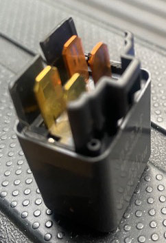

How many powers in each relay? You need 2 powers to the relays.

I'll have to recheck. What I originally called pins 2 and 4 in a previous response, are the pins 1 and 3 I jumped to get both the compressor and condenser fan running. So I'll re-check for power on the other pins, and those would be the coil side of the relay.

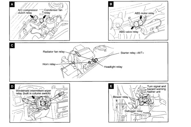

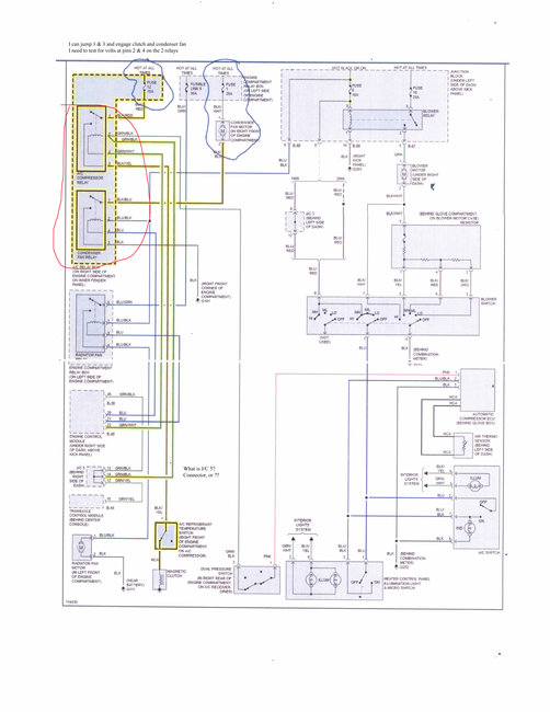

You know, thinking of it, I'd have to say the temperature switch on the compressor itself is okay.
The clutch will engage when jumped, and it has to pass through that switch to engage the clutch. Attached, combined diagram of the 3 you sent, with some questing in the drawing.
Circled in red the 2 relays, and below in the drawing asking about J/C 5. Thanks Roy.
Apr 12, 2021 at 1:56 PM
Okay, I need to know if you have the 2 powers to the relays.

Okay, you need power on pin 1 and pin 4. Once the ECM grounds the control side, power will be sent to the compressor. The power that is missing comes direct from the ECM.
You may have a bad ECM.

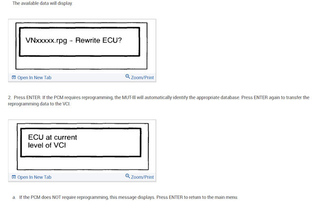

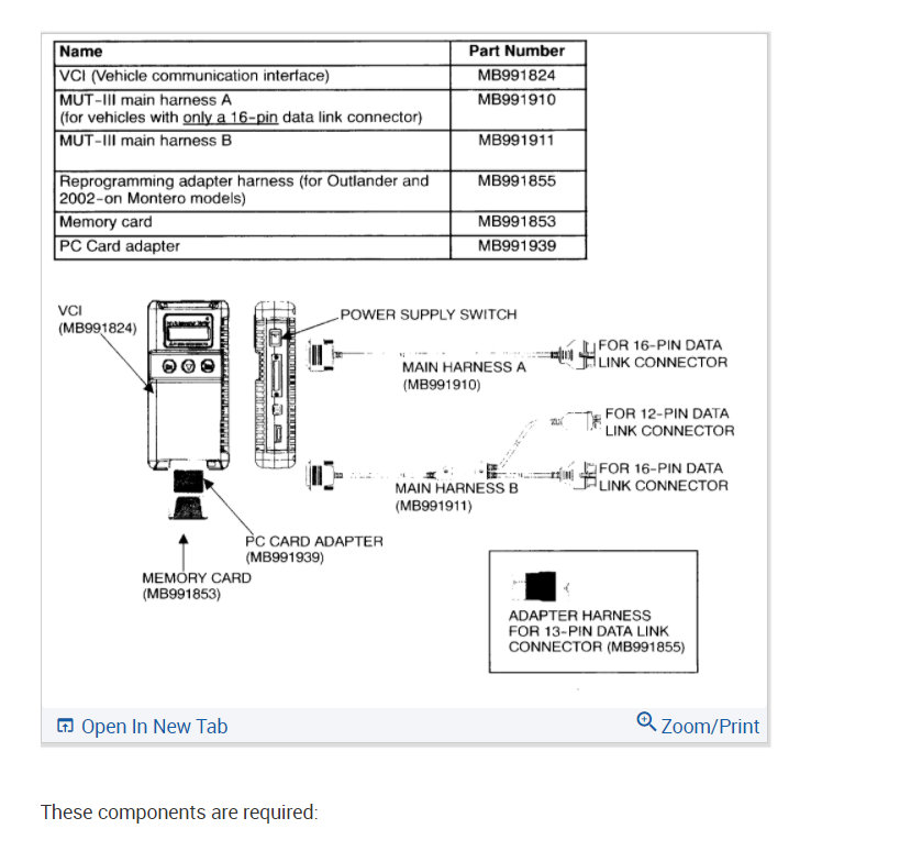

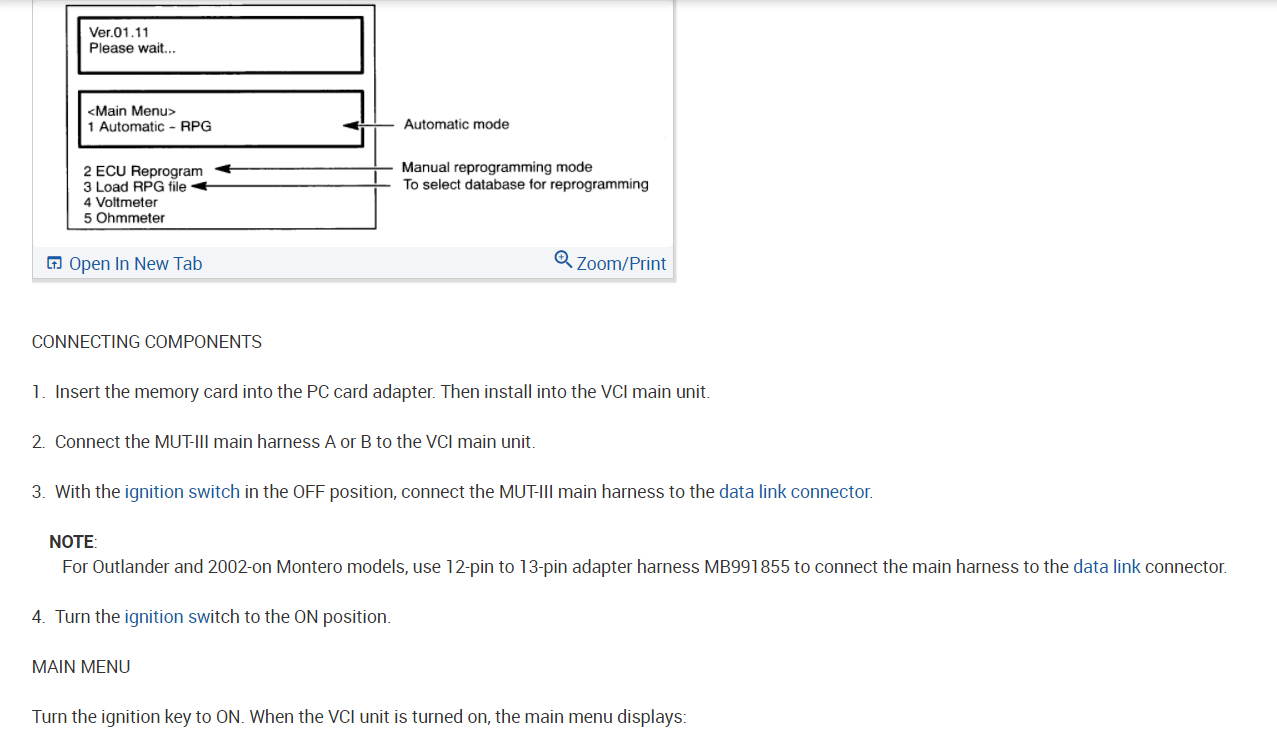

Did you have the ECM programmed to your VIN?
Apr 13, 2021 at 12:45 PM
TF43
  • 99 POSTS
For the 2000 model no programming is required for the ECM's.
Apr 13, 2021 at 1:01 PM

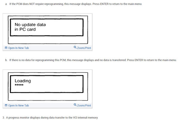

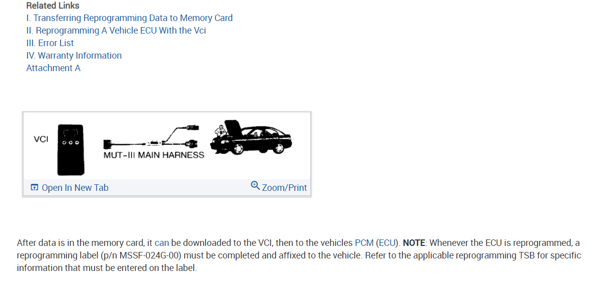

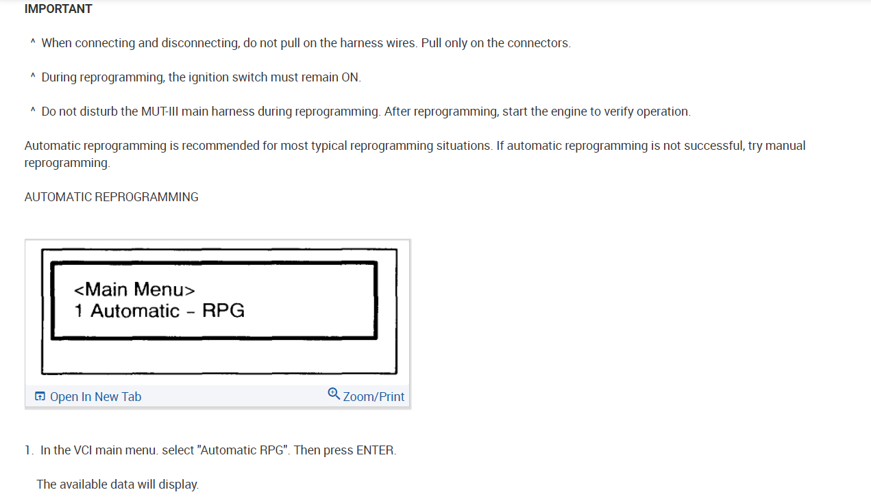

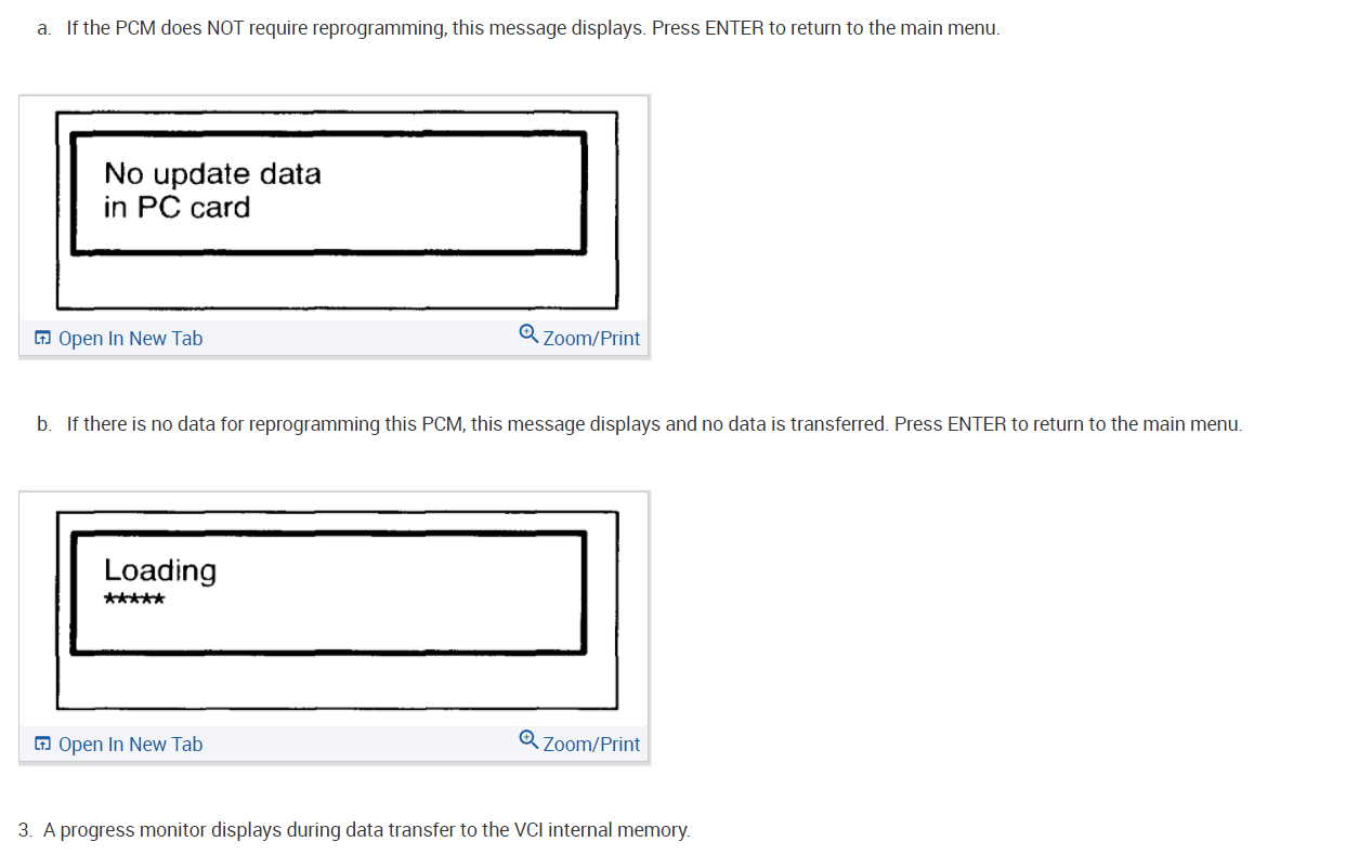

The ECM must be programmed to your VIN number or some of the functions will not work due to VIN mismatch.
I attached the process for you. Get to step 5 and see what it says.

Okay, but both ECM's have been working fine without programming. The original (the car came with) is back in the car now, and the replacement I installed last year was working okay as well. I don't have any method of programming a ECM, and on this little island.. there isn't a Mitsubishi Dealer that would be able to handle programming. So guess I stuck.. should it ever need programing. The VIN is: JA3AY26AlYU008779 believe it is a Federal emissions unit, and not California for what all that might be worth. The ECM is MR420741, and even per RockAuto.. no programming required.. guess the car has no special bells and whistles requiring it.

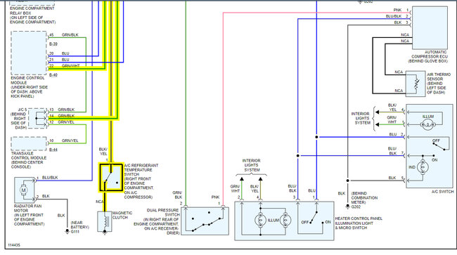

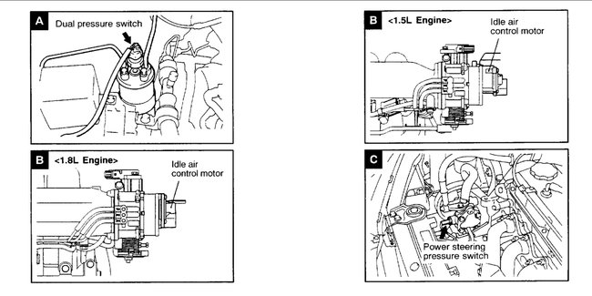

I attached another diagram for you.
Check for power to the pressure switches and verify power on both sides.

Voltage at the pressure switch on the dryer reading across the pins...key on...no 12 volts.
There is voltage, but not 12. How should I test it? It's two wires.
I cannot locate the other pressure switch either.

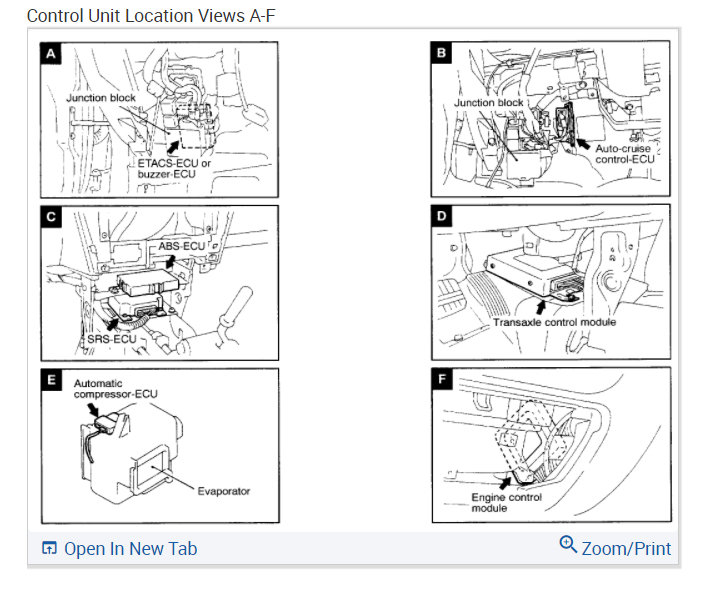

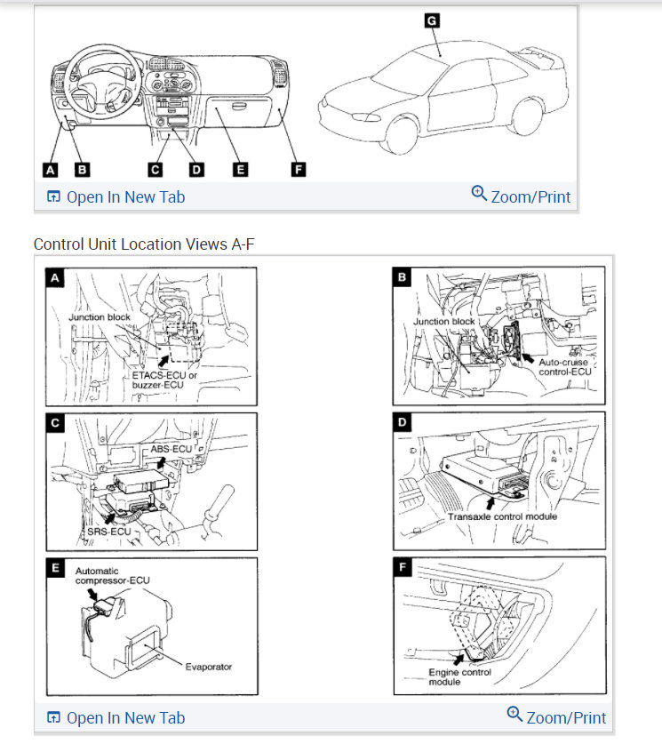

I'd like to know where this compressor ECU is suppose to be that shows behind the glove box. I don't seem to have one on this 2000.
this link: https://www.2carpros.com/questions/mitsubishi-mirage-1999-mitsubishi-mirage-no-code#last
shows it to be item 4 on a 1999 model.

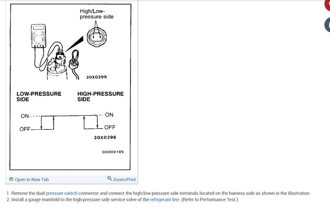

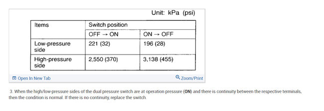

I attached the procedure for testing the dual pressure switch on the receiver/dryer below.
What voltage was at the switch?
Apr 19, 2021 at 1:11 AM
TF43
  • 99 POSTS
The pink wire has voltage: positive to pink wire.. negative to negative battery.. the voltage starts at 2.35, and will climb up to 2.42 volts and I stopped letting the meter rise from there.
Apr 19, 2021 at 5:59 PM
Terry,
You need 12 volts at that wire. It comes from the A/C relay as in the diagram I sent.

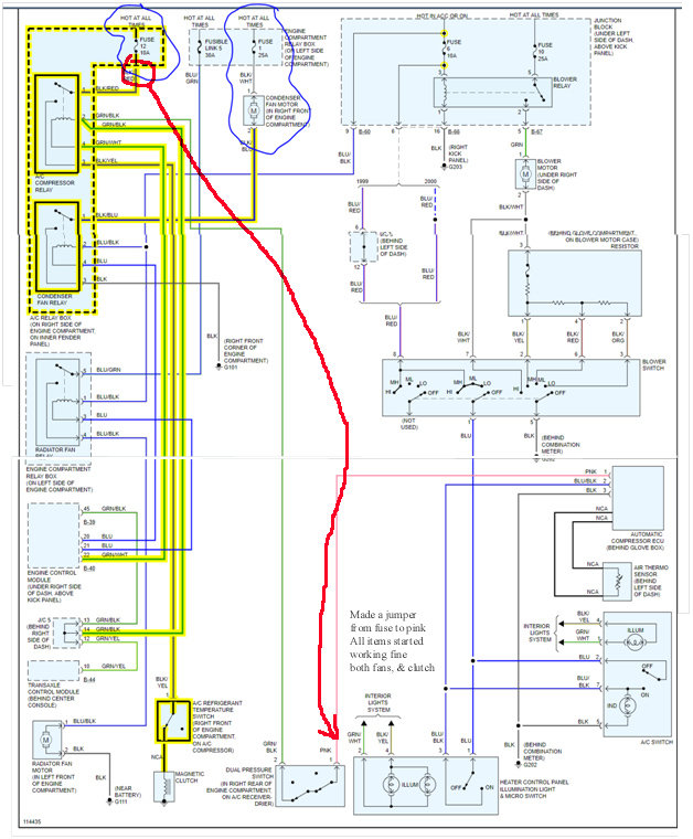

So what I did was pull 12 volts from the 10am fuse and made a jumper wire with toggle switch and ran it to the pink wire of the pressure switch. Shown in my picture. Once you toggle it on, the compressor will engage, and both fans start running as they would normally. So the problem appears to be the ECU, or related...is not sending 12 volts to the pressure switch. The pink wire on the pressure switch feeds pin 2 of the compressor relay and will energize the coil.
Now the A/C switch on the dash the little light does come on when you depress the A/C switch on. In the lower right of the picture below the ECU. it says AC switch. is that the AC switch or Accessory Switch it is talking about?
The blower motor works fine at all speeds as well. ECU problem???

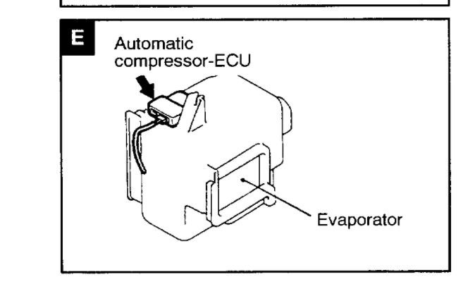

The pink wire is supplied power from the compressor module. I attached the location for you below. It provides the power to the switch or the pink wire and then the power goes to the relay when the switch is closed.
May 2, 2021 at 2:22 AM
TF43
  • 99 POSTS

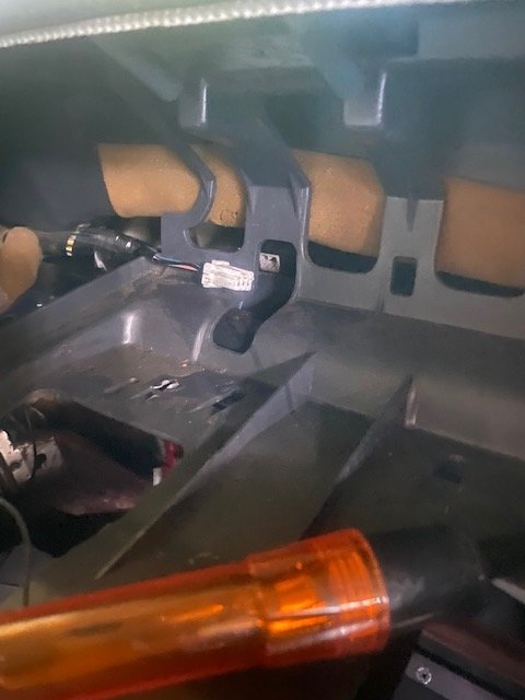

I located the ECU switch the other day, but it is buried and appears the only way to get it out is to drop the evaporator box.. disconnecting the lines. It is behind the glove box, but also on top of the evap box and that is behind a bunch of body supports that one cannot remove. Perhaps I can get to it enough to unplug it and see if the plug will come out far enough to probe it to see if power is getting to it.
May 3, 2021 at 12:24 PM
Yes, you can try. The wire for power is in the diagram I sent.

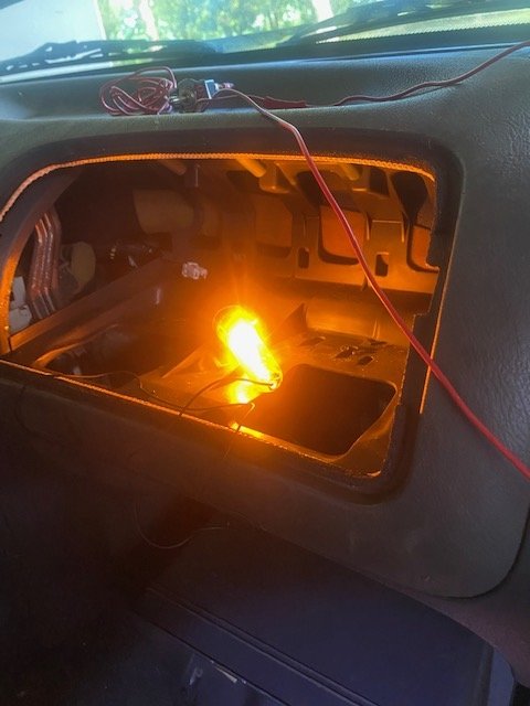

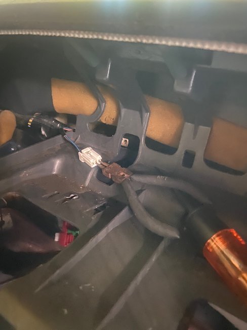

So today I finally fiddle with it some more and was able to unplug the AC Switch harness from the ECU that is behind the passenger air bag in the dash...which you have to remove to get to. Along with the glove box as well. Attached, left to right P1, P2, P3, P4
P1 - using jumper on plug...engine running AC switch on, all systems work
P2 - testing for power at the plug (blue wire) from the AC switch on the dash - all is good
P3 - AC switch harness and visible is the ECU above the evaporator
P4 - Schematic you provided,
So I tested for power at the harness...it has power...I plugged in back in and tested for power the AC pressure switch (pink wire) no power, engine on and running.
Conclusion...ECU is bad
Resolution...cut large paper clip and jump blue and pink wire on harness - seems to work just fine with the engine running, both fans running, compressor engaged.
I have no idea about the Thermo Sensor wires that come off the ECU to the left side of the dash somewhere. System seems to work.
I suppose the only way to find the actual part is from a salvage yard. I have no idea what the part number is. Rock Auto shows it, but they show a fuel injector/fuel pump relay that is the same located under the driver side console. Not the same part at all.
Any idea what the actual part number is?

You have a wiring issue with the pink wire. It is open somewhere between the module and the switch. I would do an overlay of the wire so it gets power with the key on.
May 24, 2021 at 2:01 PM
TF43
  • 99 POSTS
How's that possible to have a problem with the pink wire? If I jump the blue and pink wire at the harness plug under the dash (that connects to the ECU) and it works fine then.
The pink wire runs from that plug to the pressure switch. The ECU isn't allowing the blue wire and pink wire to complete the connection. So jumping it was my solution, and it only powers up with the key on. Not sure I follow how the pink wire is at fault. Thanks Roy for the help. : )
May 24, 2021 at 2:12 PM
Was that just a connector or did you remove the connector from something?
May 24, 2021 at 2:35 PM
TF43
  • 99 POSTS
Yes, the connector was plugged into the ECU just above the evaporator. You can see the little white box/plug just above the P1 and P3 I sent. The harness plugs into it. : )
May 24, 2021 at 2:53 PM
Okay, I see. Based on that, I agree it needs an ECM.
