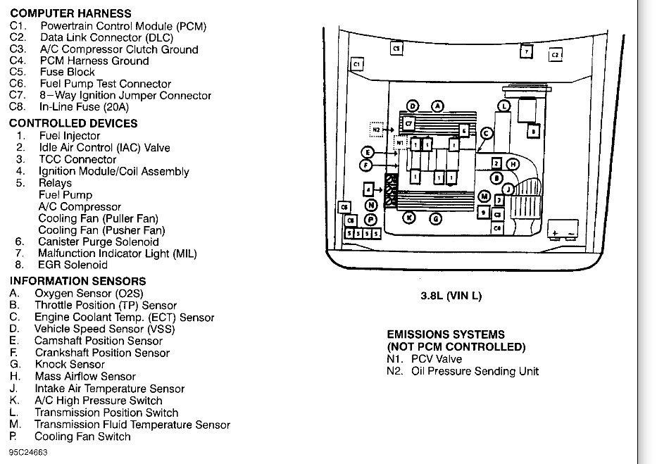

the relay rack is as follows its near pass fendero header. from fender relay 1 2 3 are gry 4 is blck 5 is green.

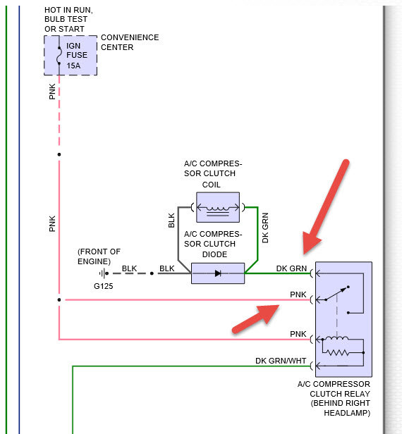

hint if compressor won't start it may be out of Freon, if that is case then there is a leak and should be fixed...... see pic ac compressor relay behind right headlight

it may have a slow leak which is seasonal that is quite common. if not recharged eventually to low for compressor to start. your pic is nonspecific as to which relay is compressor

It looks like it #5 in the description. Can you double check the year, Mitchell1 does not show a transport for this year.

my latest news is its #2 from fender but still dont have wiring diagram and all the wires on #2 are the same size.

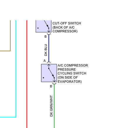

unplug relay if you are going to jump it there. also pic of pressure switch.

o which wires am i jumping? pink to green?
Apr 13, 2016 at 10:17 AM
  • 54,832 POSTS
You will jump the pink to the green
Apr 13, 2016 at 11:25 AM
FIXITMR
  • 9,990 POSTS
yup that makes the compressor run gonna try to test for leaks before attempting to charge its completely empty as far as i can tell.
