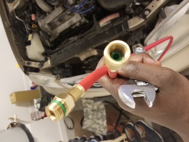

Hi thank you for the sound advice and prompt response. I went and got a pressure gauge manifold from AutoZone and attempted to pull vacuum. When I turned the vacuum pump on and opened the low pressure gauge valve, it only sat at 5 in Hg after forty five minutes. I tried to check, adjust, and tighten the yellow hose and still got nothing more than the 5 in Hg. I noticed the yellow valve o-rings were not in good condition; one had some tears. Even with securing the hose tight, would this be a contributor to a leak in the system when the pump is turned on? I checked the hi and low pressures without the pump and verified both are at zero.

Hi again. Are you referring to the o-rings under the caps? If that is the case, they are there to help prevent leakage. The actual valve should not leak, but yes it is possible. If you are getting 0 psi readings on both the high and low sides, the system is empty and needs recharged.
If it is possible, could you send me a picture of the o-rings you are referring to so I can confirm what I am telling you?
