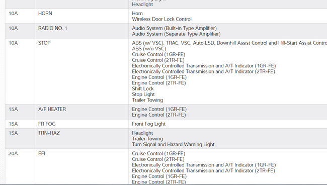

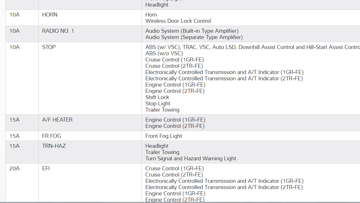

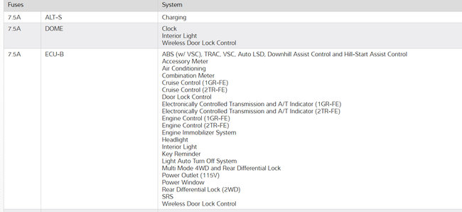

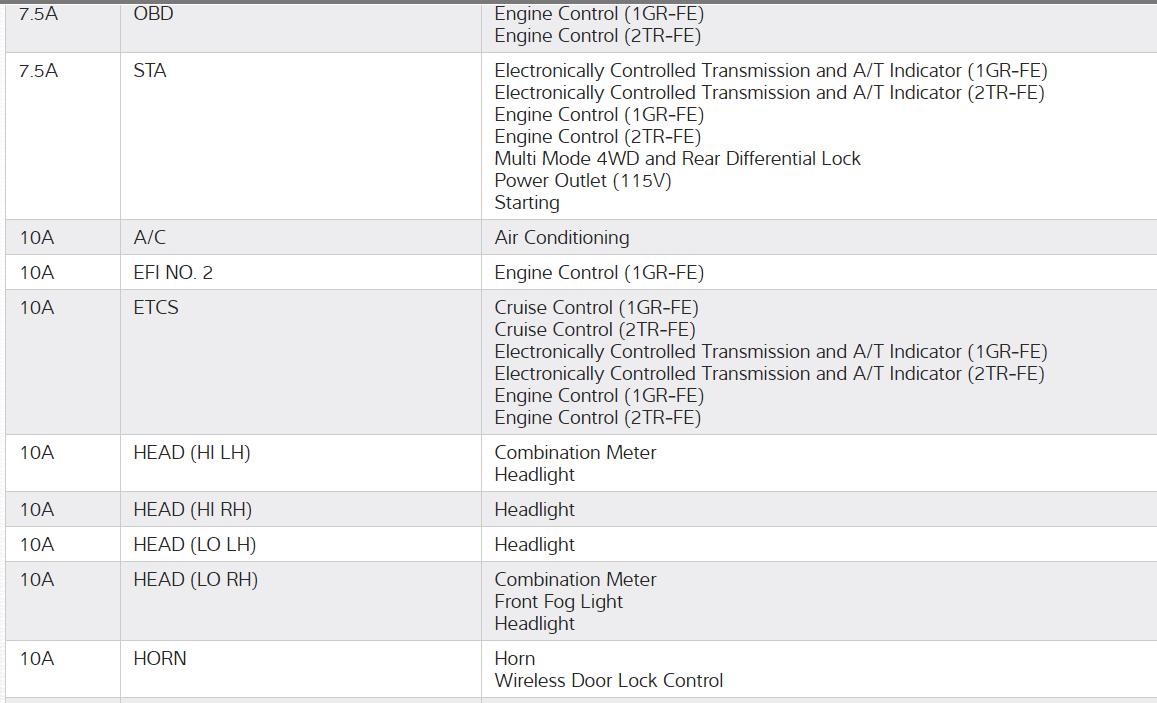

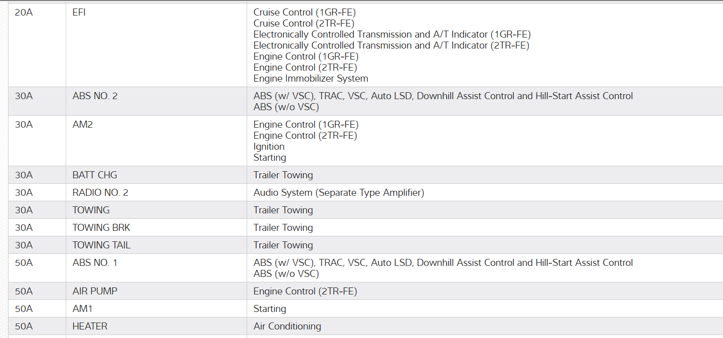

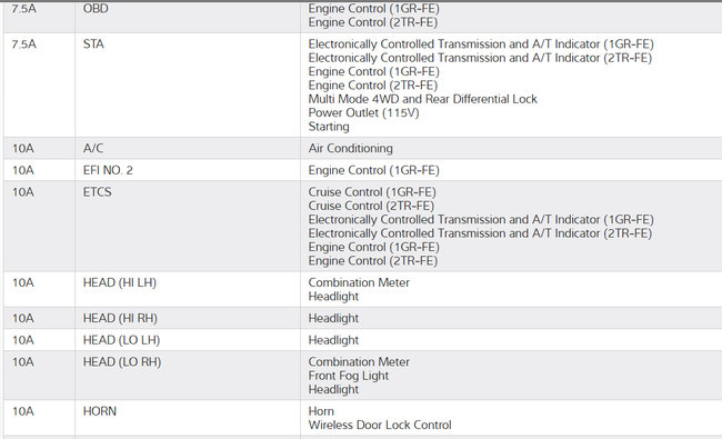

I just finished installing a new stereo in my 2005 Toyota Tacoma - I had the AC Control unit out because that is how you access the stereo to install a new one.
When I replaced the AC control unit the AC button light and the outside air circulation button light would not light up. I removed the panel and checked to see if the connections were plugged in correctly. All was good there so I unplugged them and I made sure they were lined up correctly and carefully plugged them back in again and still no lights on either switch.
I turned on the vehicle and turned on the AC... no AC defroster only...

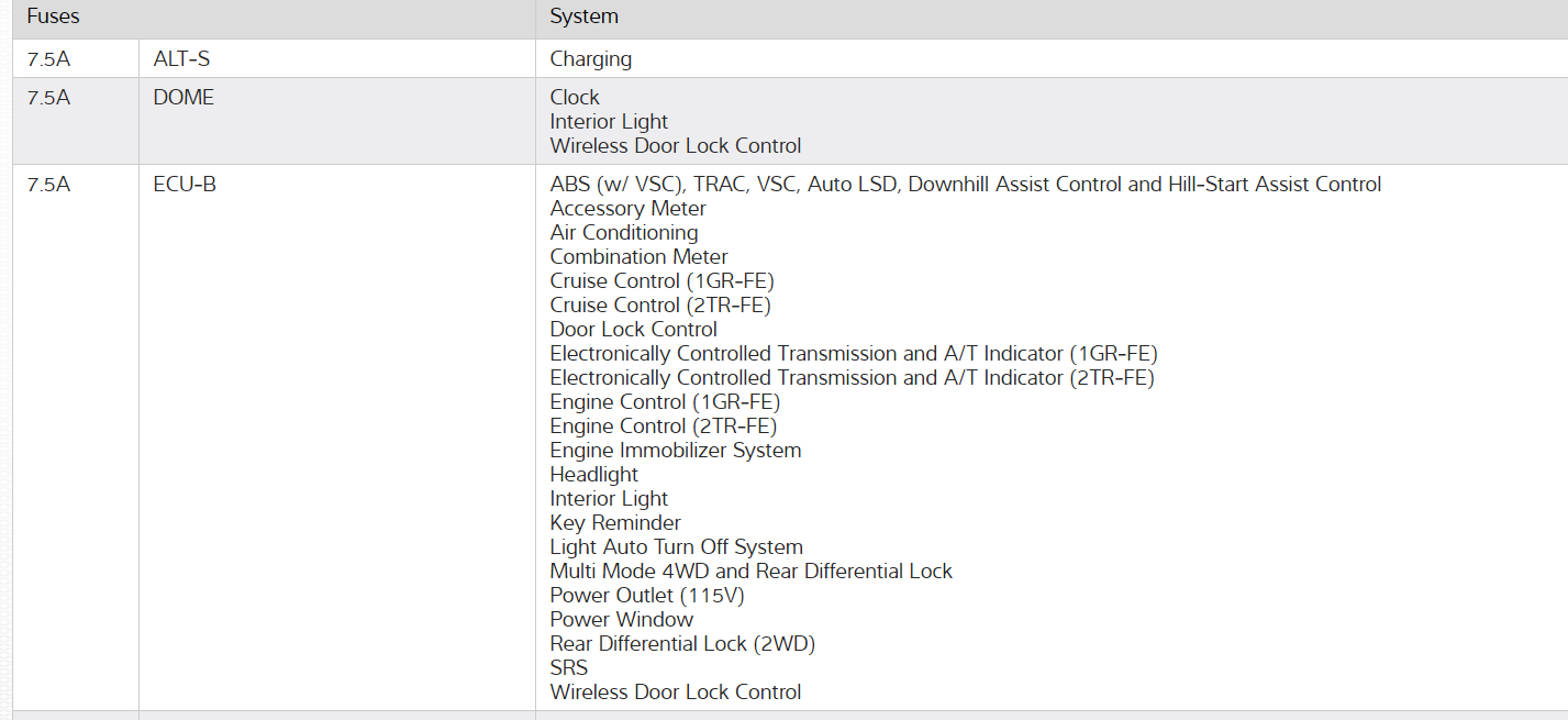

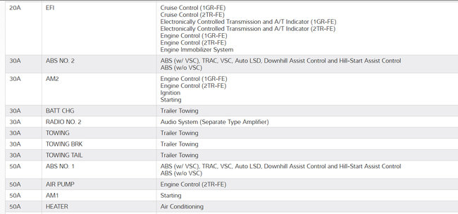

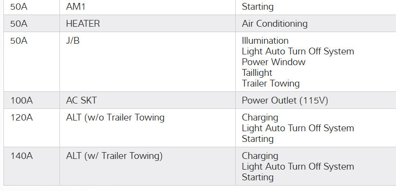

I checked a few of the fuses under the secret door on the driverside lower dash. None that I checked were blown. I wasn't sure what each of the fuses were for.
Is there a main fuse blown or is there a fuse inside the unit that needs replacing?
The abbreviations were not something I recognized. Do you know which fuse it could be or am I going to have to look at all of them to see which one is burned out?
Is there a solution for this?
Thanks for your answer,
Best,
Jim
Aug 16, 2013 at 5:30 PM
SATURNTECH9
  • 30,869 POSTS

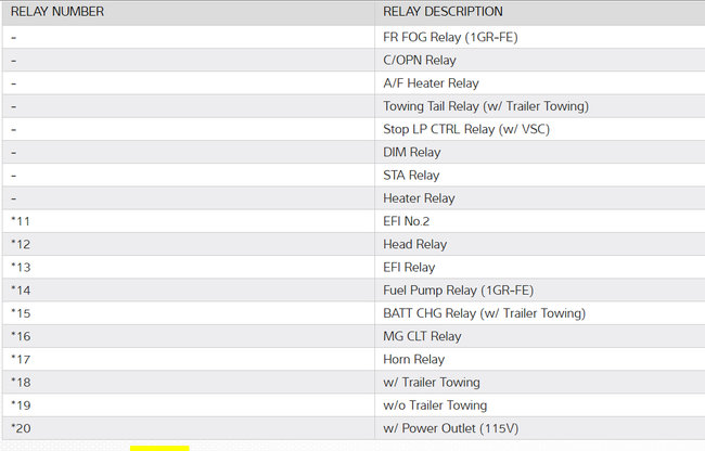

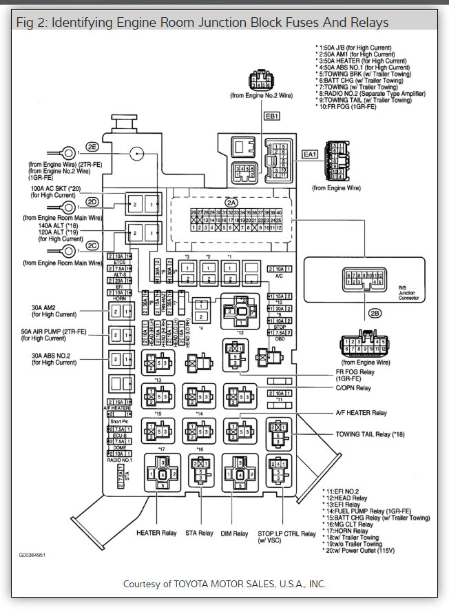

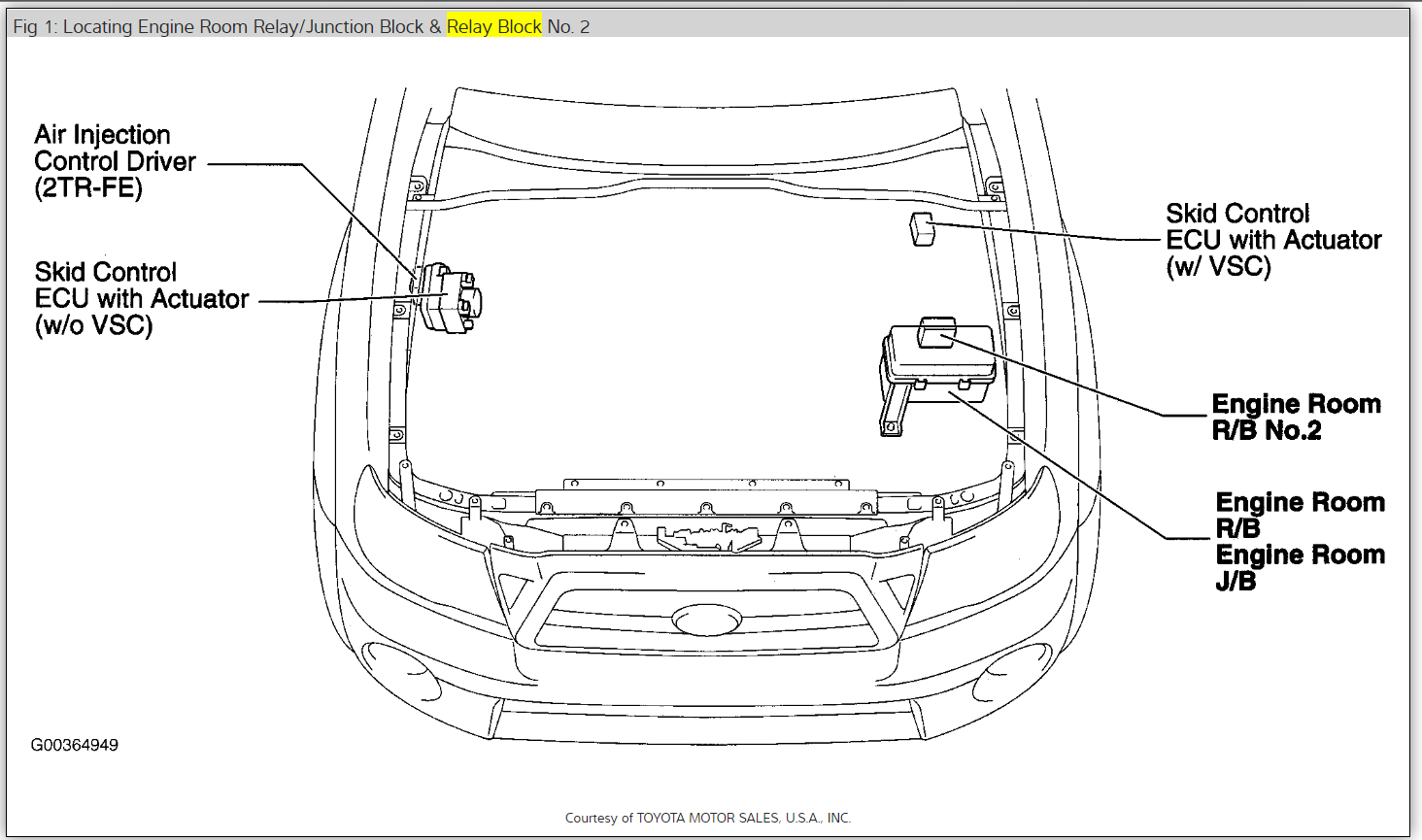

It sounds like you have a heater relay that is out but to be sure lets check out this guide. Check the fuse labeled ig1 in the fuse box on the left side of the dash.
This video can help as well
https://youtu.be/4UjfQKvrB6Y

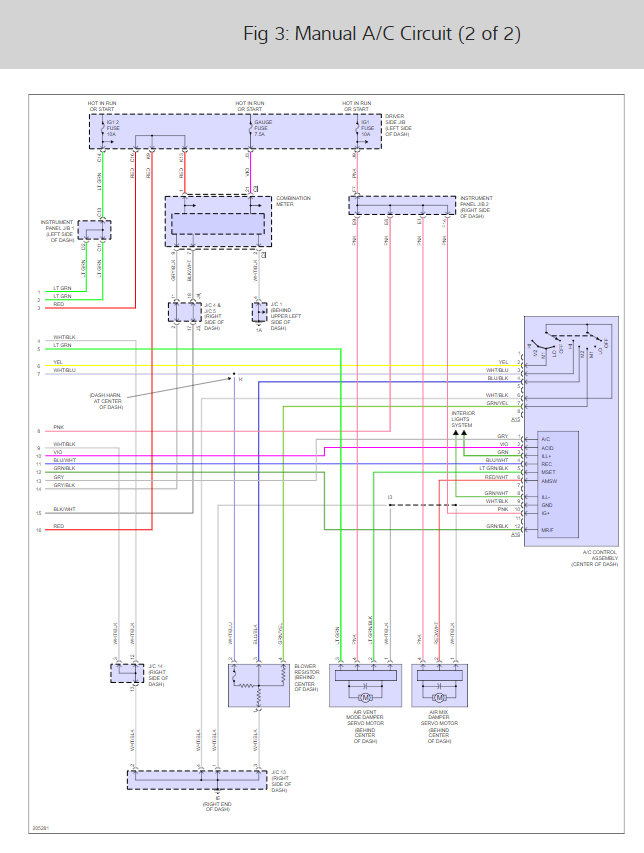

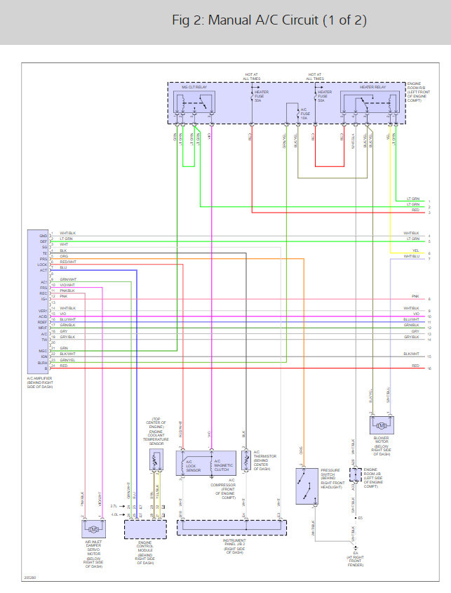

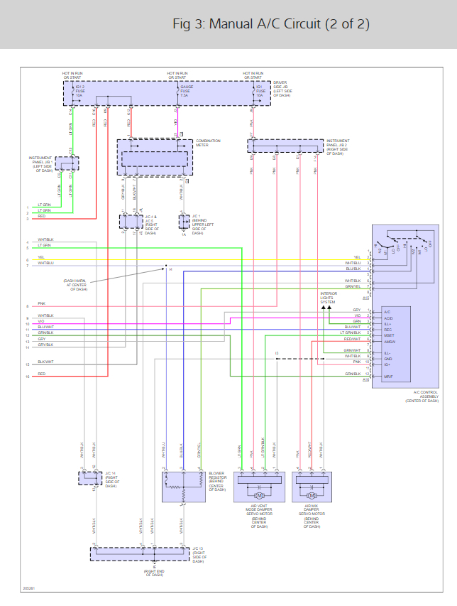

Here is the air conditioner wiring diagrams and the heater relay location so you can run some simple tests.
Check out the diagrams (Below). Please let us know what you find.
Aug 17, 2013 at 1:08 AM
JBRASIEL
Yep you nailed it! I replaced the heater relay now everything works what great site this is :)
