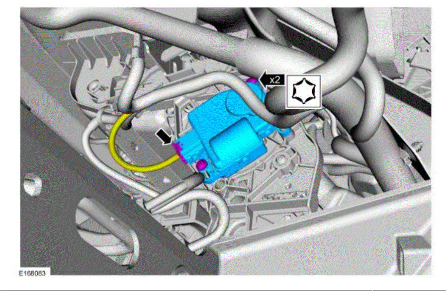

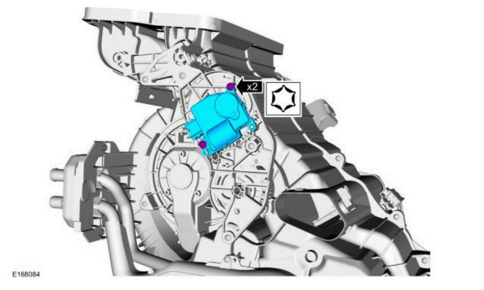

The A/C doesn't blow from the front or hand vents, it is stuck only on defrost mode and legs.

Good morning,
This sounds like the actuator is not working for changing modes.
https://www.2carpros.com/articles/low-or-no-air-flow-from-vents
I attached the procedure and some pictures for the replacement of the actuator.
Air Distribution Door Actuator
Removal
NOTE: Removal steps in this procedure may contain installation details.
1. Refer to: Driver Knee Airbag See: Air Bag > Removal and Replacement (501-20B Supplemental Restraint System, Removal and Installation).
2.
3. NOTE: If replacing the air distribution door actuating assembly, perform the following steps.
Refer to: Heater Core and Evaporator Core Housing - Vehicles With: Electronic Automatic Temperature Control (EATC) See: Housing Assembly HVAC > Removal and Replacement > Heater Core and Evaporator Core Housing (412-00 Climate Control System - General Information, Removal and Installation).
Refer to: Heater Core and Evaporator Core Housing - Vehicles With: Electronic Manual Temperature Control (EMTC) See: Housing Assembly HVAC > Removal and Replacement > Heater Core and Evaporator Core Housing (412-00 Climate Control System - General Information, Removal and Installation).
4.
5.
Installation
1. To install, reverse the removal procedure.
2. NOTE: When installing the air distribution door actuating assembly, make sure that each air distribution door gear or lever is correctly aligned with the actuating assembly.
