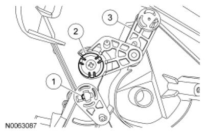

ATISHREDDY93
When I try to change the mode it gives me cracking sound for few seconds and stops. And AC still blows in the defrost.

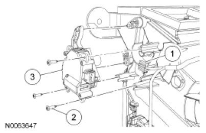

Based on your description, the mode door actuator is bad. Here is a link that discusses and shows in general how one is replaced:
https://www.2carpros.com/articles/air-vents-stay-in-the-defrost-position
Next, here are the directions specific to your vehicle for replacement of the part. All attached pictures correlate with these directions.

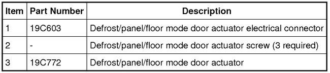

Mode door actuator and linkage
1. Remove the 3 defrost/panel/floor mode door actuator screws.
2. Disconnect the defrost/panel/floor mode door actuator electrical connector.
3. Remove the defrost/panel/floor mode door actuator.
4. Manually operate, and inspect the defrost/panel/floor mode door linkage for incorrect placement or damage.
Mode door actuator linkage only
5. Remove the mode door linkage.
1. Depress the tab and remove the panel door lever.
2. Remove the floor/defrost door intermediate lever screw and floor/defrost door intermediate lever.
3. Pull straight outward to remove the floor/defrost door lever.
6. NOTE: When installing the mode door actuator, make sure that the panel door lever and floor/defrost intermediate lever are correctly aligned with the mode door actuator cam.
To install, reverse the removal procedure.
