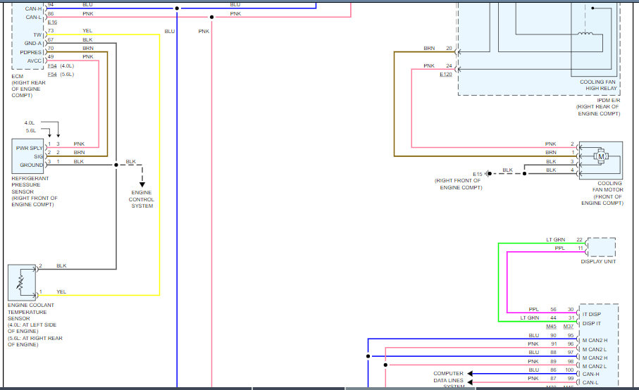

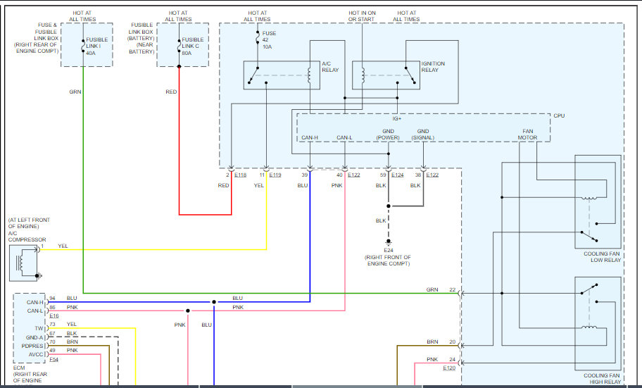

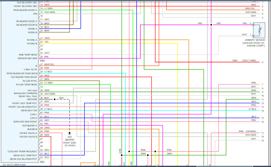

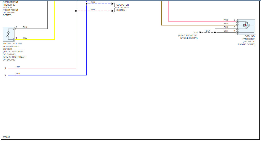

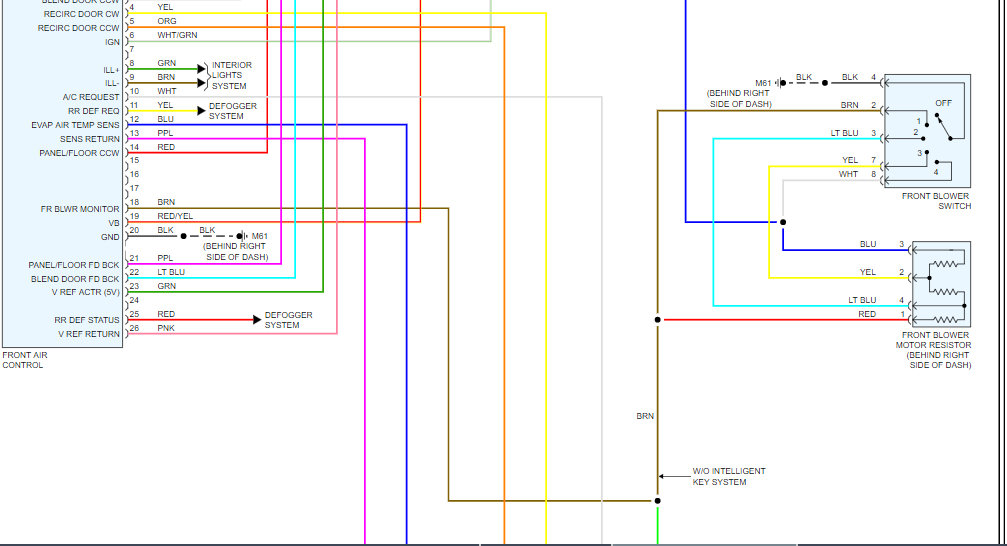

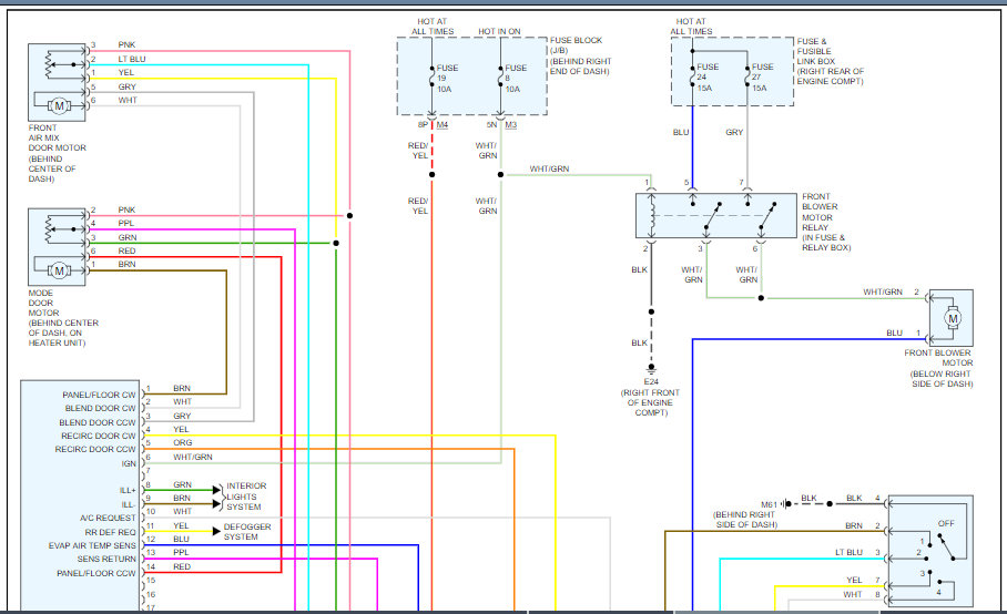

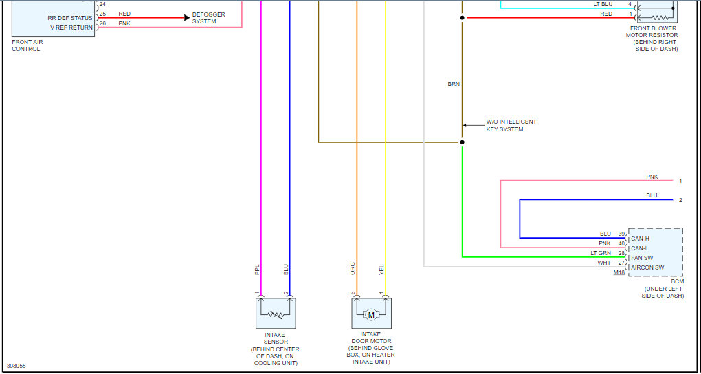

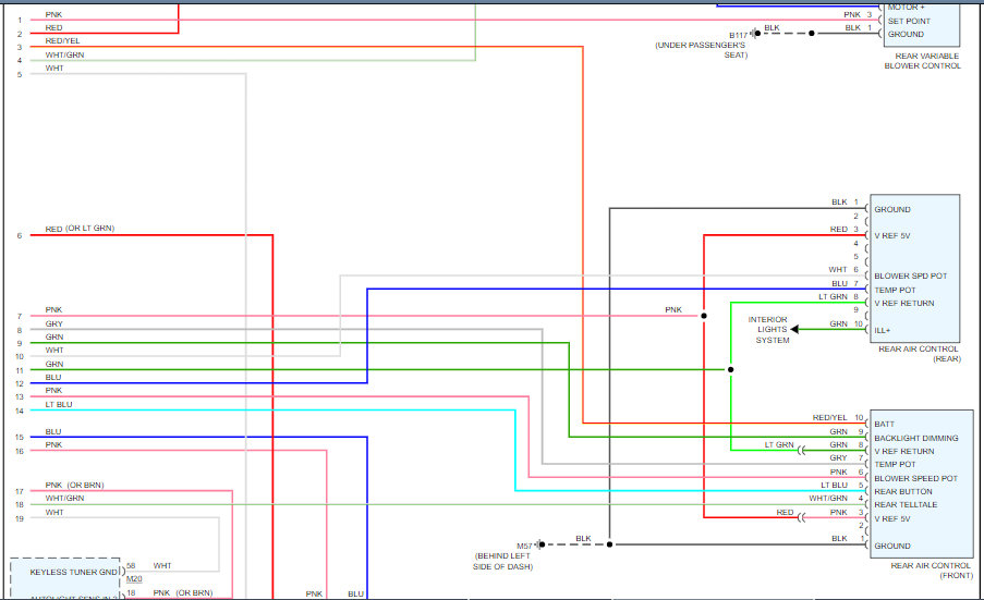

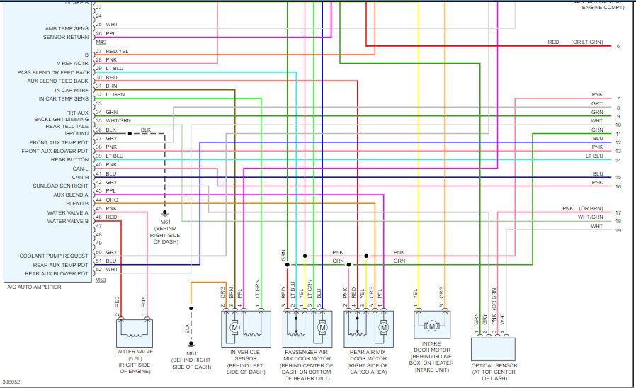

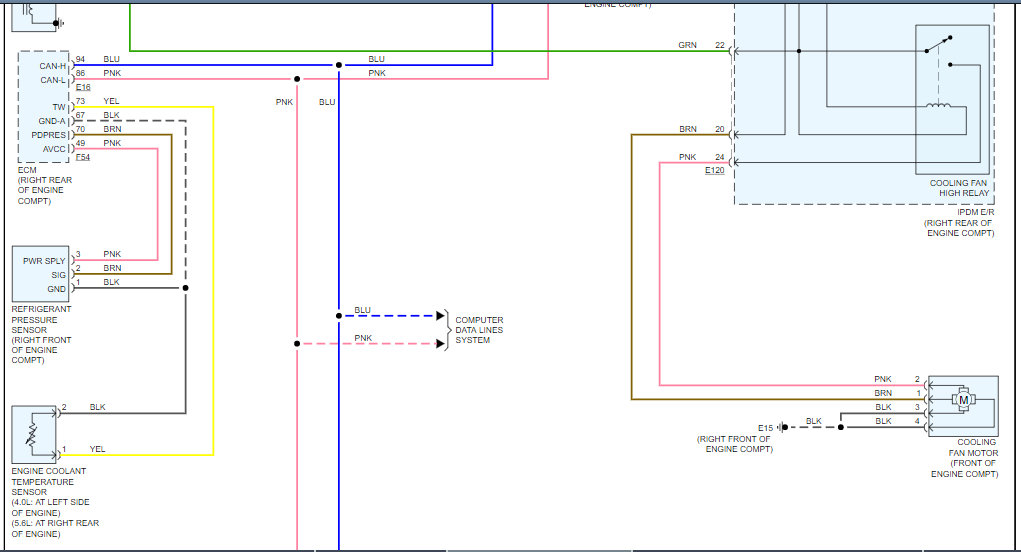

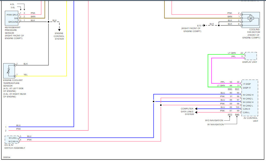

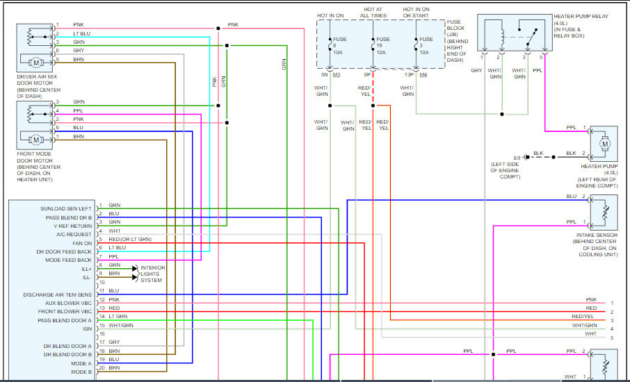

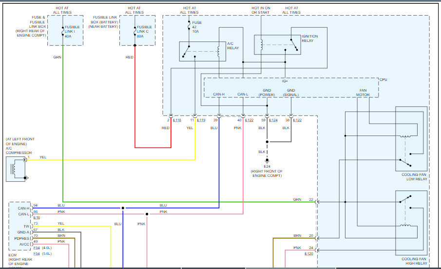

A/C clutch is not engaging. Coolant pressure is high. Did not add any to system. Just replaced fan motor resistor. A/C was working before. Could you please give the wiring diagram for this system? Thanks for your help.
May 19, 2021 at 5:43 AM
DANNY L
  • 5,648 POSTS
Hello, I'm Danny.
Here is the information you requested. This is a tutorial showing how to test electrical wiring:

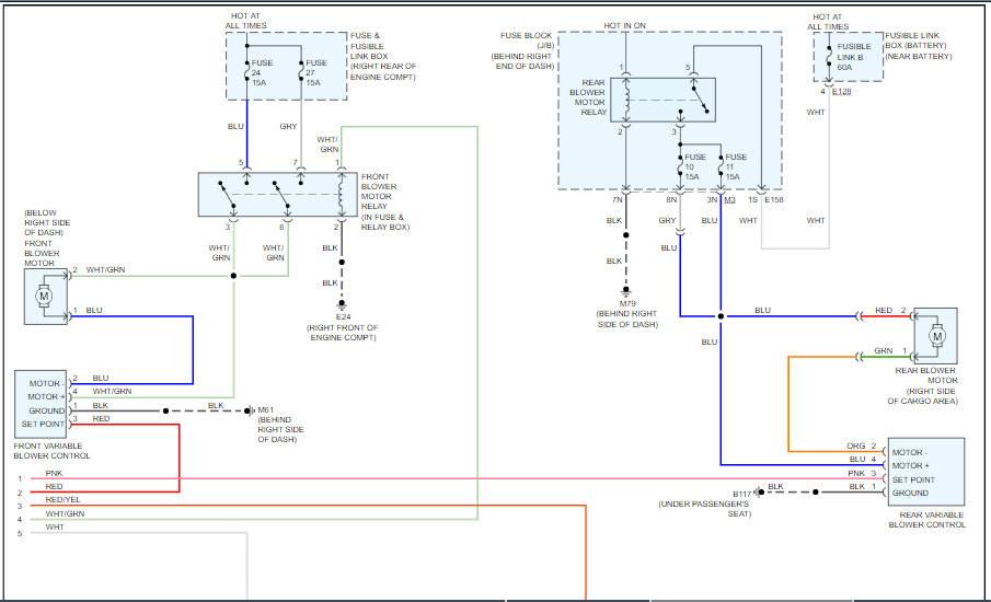

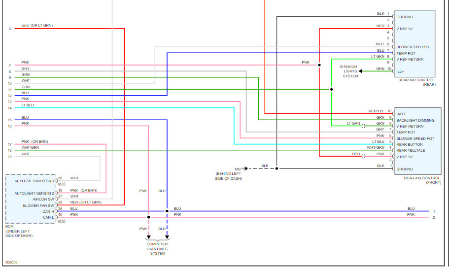

I've attached pictures below of a the ac-hvac wiring diagrams for your vehicle. I've cut the pictures into 3 pieces each for you to view larger. The first 9 picture are for automatic hvac controls and the last 5 are for manual controls. Hope this helps and thanks for using 2CarPros.
