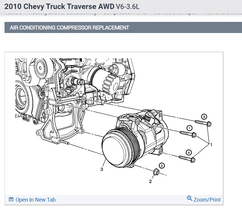

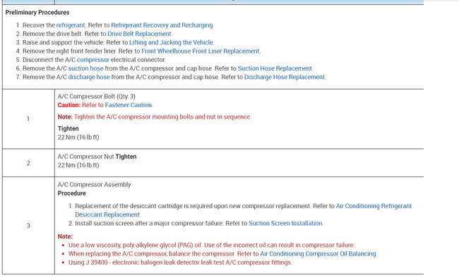

Here is a generic guide to help you step by step with instructions in the diagrams below to show you how on your car:
https://www.2carpros.com/articles/replace-air-conditioner-compressor
You will need this video as well:
https://youtu.be/4EqdrBVb0sY
