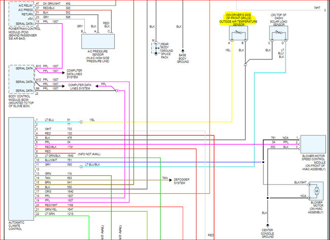

The A/C is not working, I think it's the climate control sensor for exterior. The digital readout says OC the blowers are working and when I get something different on screen it is negative 40 so blows hot air. I need an illustration of where sensor is located.

Hi Billy,

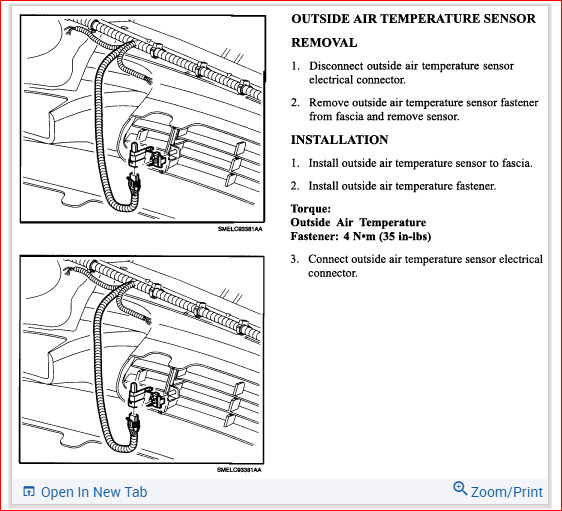

If you have one of your temp sensors reading -40 degrees then you are correct that this is why your HVAC blows hot. However, I want to make sure I understand where you are seeing this -40. Are you seeing this on your vehicle display where it shows you what the outside temperature is? If this is the case then this information comes from the ambient temperature sensor.
From what I am seeing on your vehicle the ambient air temperature sensor is located in the grille on the driver's side. Please see the attached documents.

Hey thanks. I hit a deer a while back my wire for sensor was just hanging down under the car but the actual sensor was gone and there's not a place on my grill that looks like it's been broke. with this diagram I should be able to figure it out again. thanks
