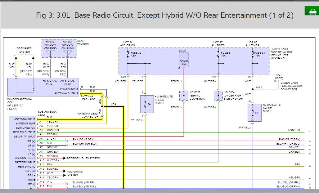

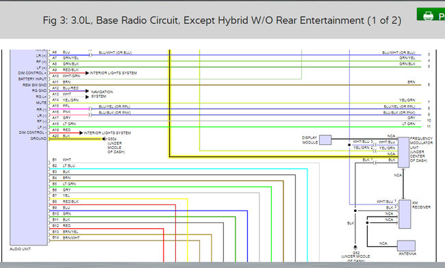

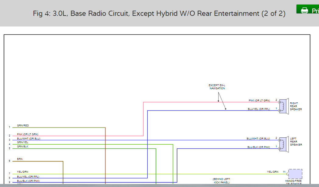

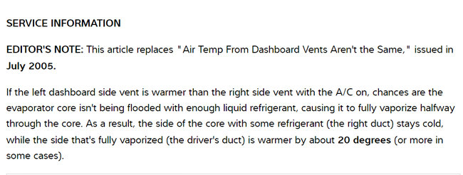

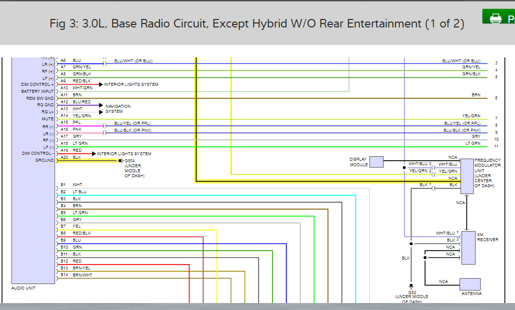

At first the A/C would just randomly blow hot on the driver side but after a while of messing with all the settings it would eventually kick in and blow cooler. Not as cold as the passenger but not scolding hot as it was. It’s now just completely running hot and now the passenger side is running warmer nut not as hot as the driver side. I have not attempted anything with it yet. Also could be completely two separate issues but every now and that my radio will cut out and make alien noises and not put out sound until i punch and hit the center console where the hazard button lays.
May 28, 2019 at 11:15 AM
SCGRANTURISMO
  • 4,897 POSTS

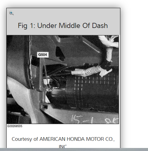

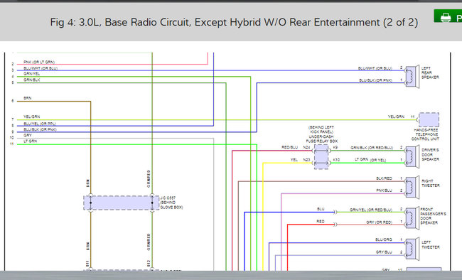

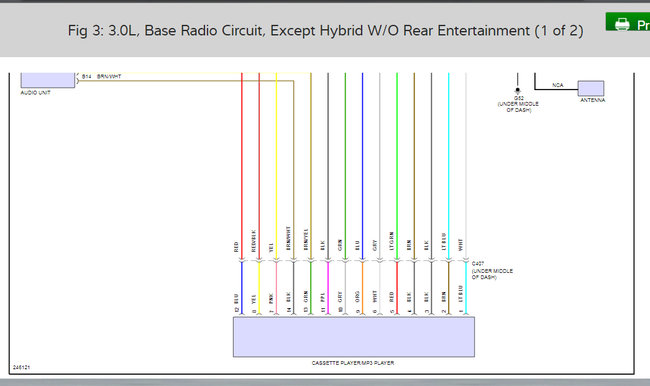

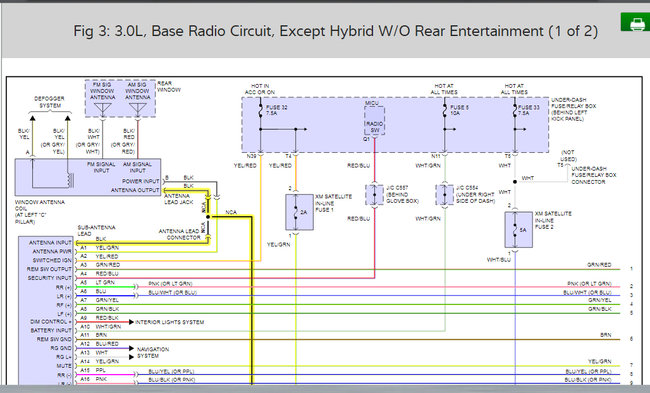

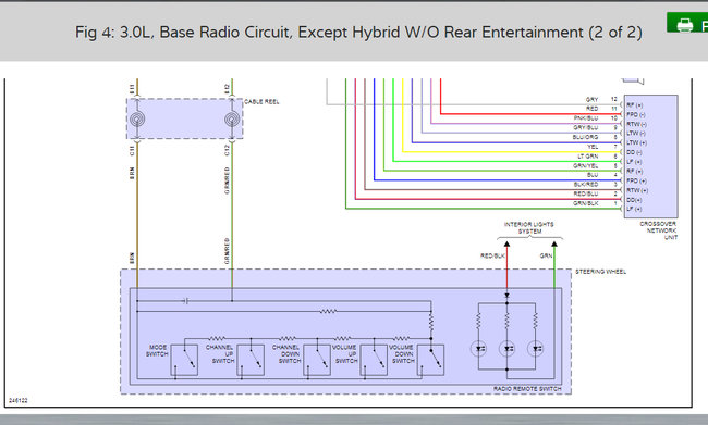

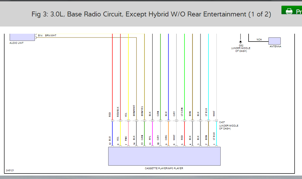

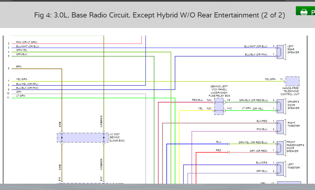

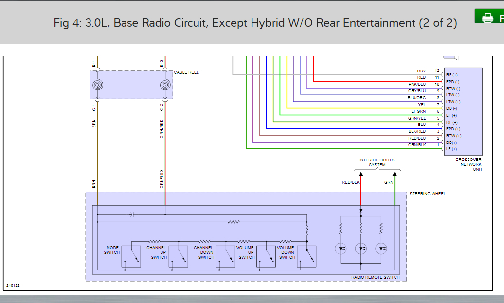

Your vehicle's A/C system sounds like it is running out of Freon. Freon is what your vehicle's A/C system uses to make the air cool. In fact what your vehicle's A/C system is really doing is transferring the heat from inside the cabin of vehicle to the outside of your vehicle, but that's another conversation for later. The issue with your vehicle's stereo sounds like either a loose ground wire or possibly a loose antenna connection. I have included a wiring diagram of your stereo in the diagrams down below. The ground and antenna wires are highlighted for you. I have also included a description and a picture of where G504 is in your vehicle. Please go through this information and get back to us with what you are able to find out.

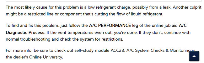

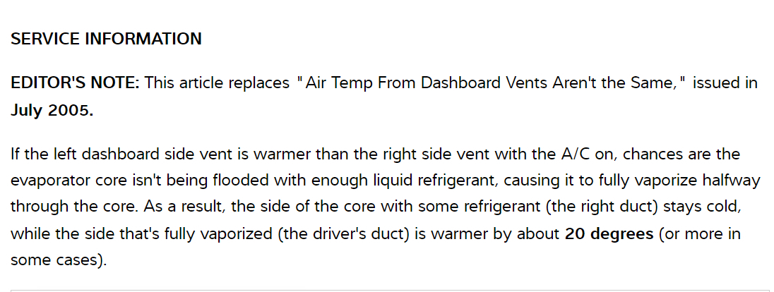

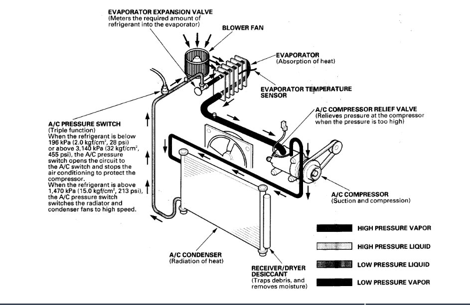

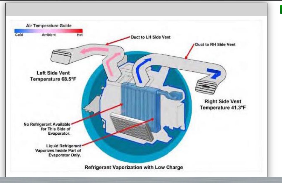

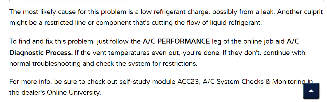

I ran the self diagnosing for the A/C and the dtc code O for me. What does that mean and how can I fix that?
May 28, 2019 at 10:47 PM
SCGRANTURISMO
  • 4,897 POSTS
Hello again,

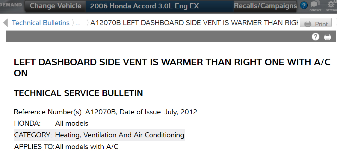

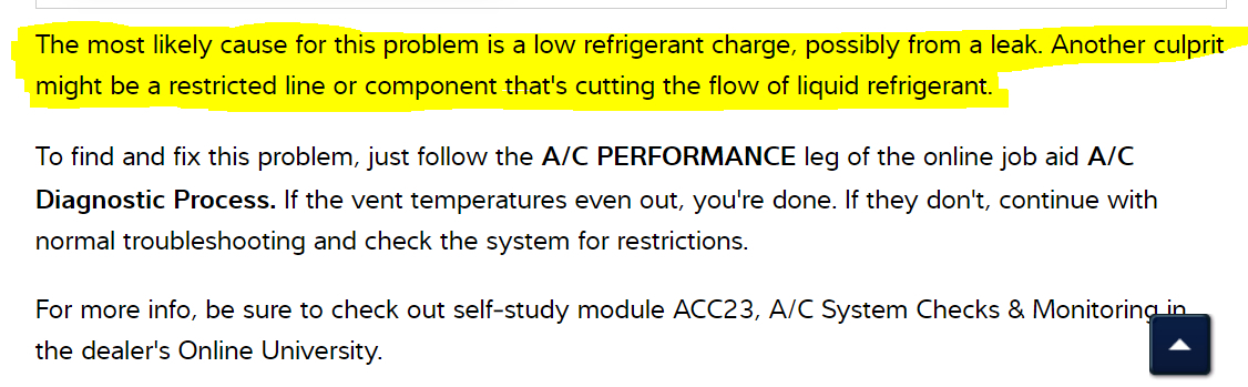

While doing some more research for your vehicle, I came across this Technical Service Bulletin (TSB) for your vehicle. I have included it in the diagrams down below as well as a diagram of your vehicle's air conditioning system, showing the lines that are discussed in the TSB. Please go through this guide and get back to us with what you are able to find out.
