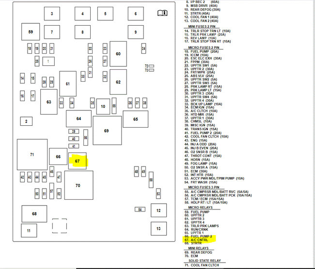

A/C relay location needed for reinstallation
2015 GMC SIERRA
85,000 MILES • 6.2L • V8 • 4WD • AUTOMATIC
BADFRANKIE
Truck listed above is an All Terrain. Pulled out A/C relay and didn't realize there were two ways it could go until I saw the diagram on side of it by then I had forgotten how it was and the fuse box does have the numbers on it or I can't find any. please help. thanks and Godbless!

The relay should only fit one way. If you look at the attached pic below, I highlighted its location. That is the under hood fuse/relay box on the left side of the engine compartment
