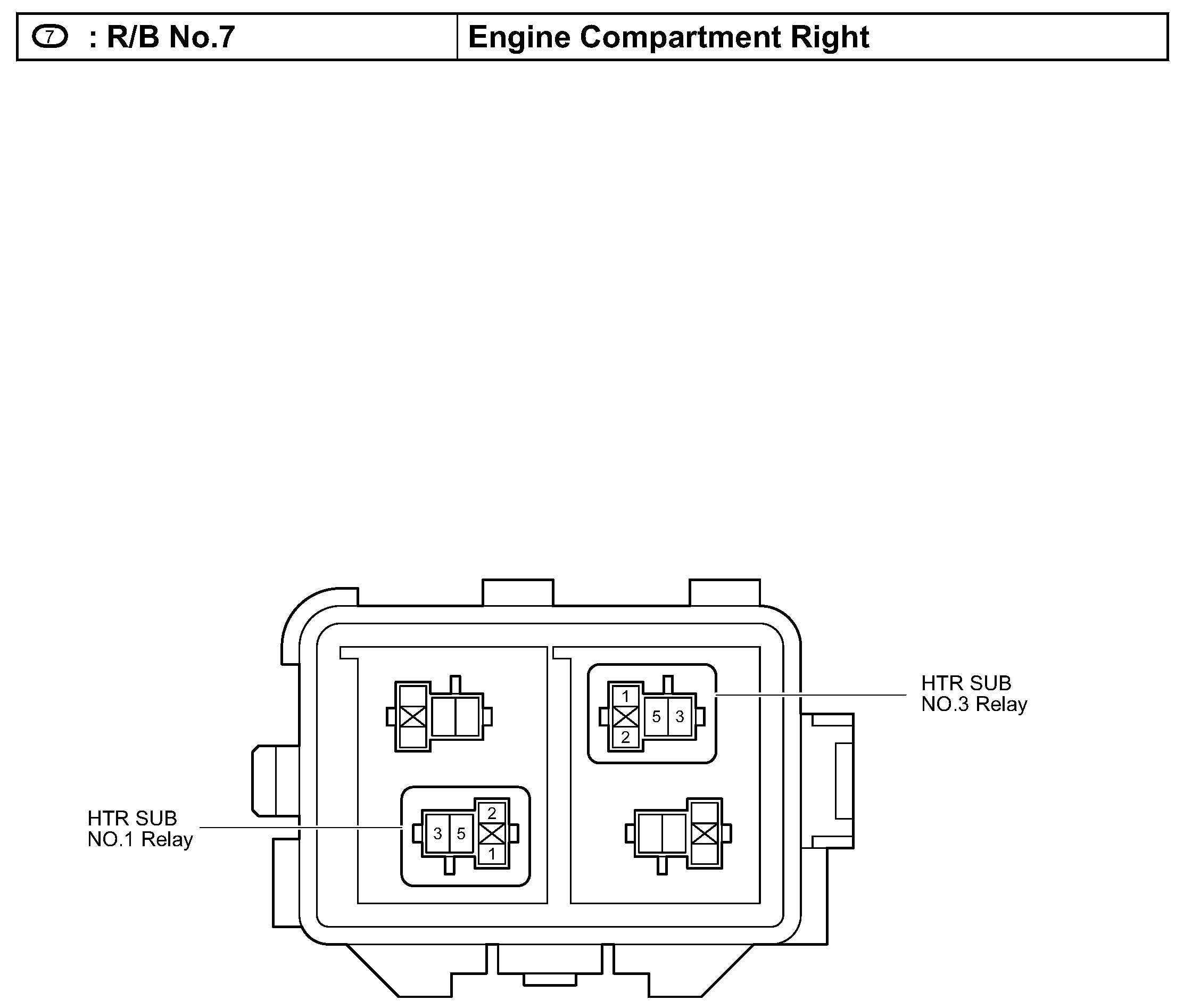

2009 Corolla 1.8L Forums indicate the AC relay will be in the engine fuse box, but it is not there (HTR 50A, M/G CLT).
Where should I look? Thanks
May 30, 2019 at 8:51 AM
STEVE W.
  • 15,200 POSTS

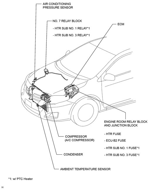

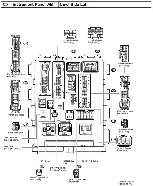

Welcome to 2CarPros. It should be in the relay block on the passenger side under the hood or in the junction box on the left side of the dash. It depends on which AC system you have and which plant the car was built in.
Jun 1, 2019 at 12:07 AM
FF
Thanks switched out relays but compressor not responding at all.
