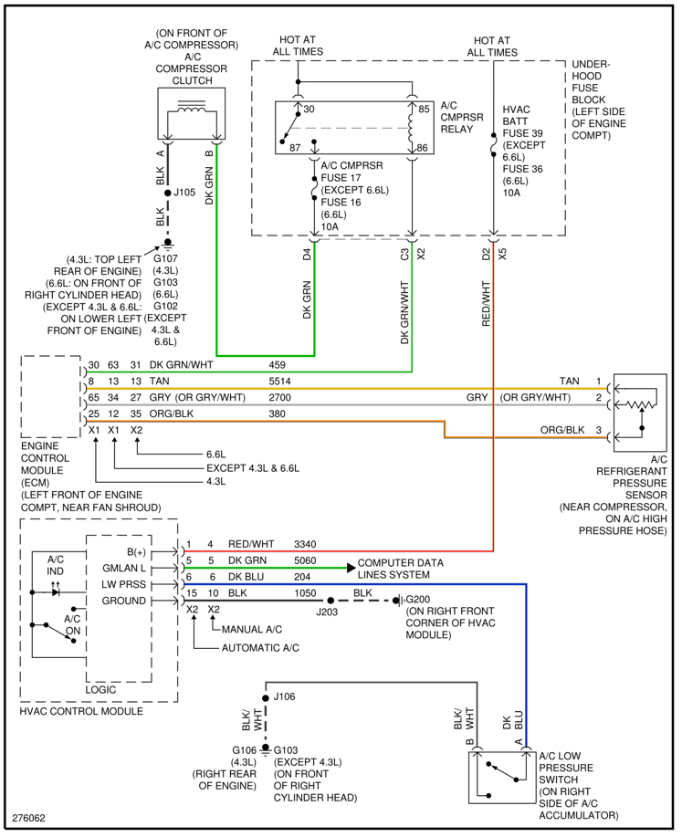

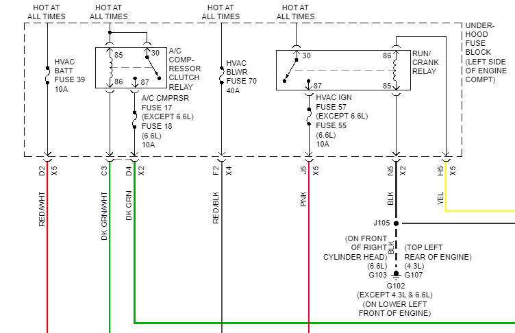

Hello, have the truck listed above 1500 and have no power to A/C fuse or relay under hood, no power from ignition switch as well to pin 86 I believe (upper left of relay). don't know where to begin?
May 25, 2023 at 1:58 PM
BORIS K
  • 836 POSTS
The A/C compressor relay is supplied directly from the under-hood fuse block with constant 12V on terminals 85+30
See image below
Terminal 86 is a switched ground from the ECM on dark green/white wire
Terminal 87 is 12V out to fuse
Suggest checking connections at under-hood fuse block for possible corrosion.

As previously indicated, the ECM only supplies switched ground to terminal 86 at the AC relay.
Terminals 30 and 85 have constant 12V supplied internally by the engine fuse block.
The ECM has no means to switch off this 12V supply.
The AC fuse will only get 12V supply once the relay has been switched on.

Have you checked the refrigerant charging level of the AC system? Low refrigerant pressure can cause the AC relay not to be activated.
Suggest to check live data in the ECM for AC pressure switch and live data in AC control module (HVAC). The ECM and HVAC module rely on plausible inputs of both switches to allow the ECM to switch a ground to the AC compressor relay to allow the AC compressor clutch to switch on. See image below.
