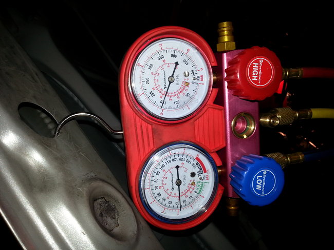

So, all went okay during the evacuation and recharging. There were no leaks. No oil came out at all (I suppose because all the parts were new and the oil I added during installation was still in the liquid state). I did the recharging using a can tap and a set of gauge manifold. Humidity was high and the temperature was about 75 to 80 F. At the end of the procedure, the Low Pressure reading was around 38 and the High Pressure reading was around 165 .

Okay, the high side is spot on but the low side is high. It should be 25-30 pounds.
How cold is the air coming out of the vents?

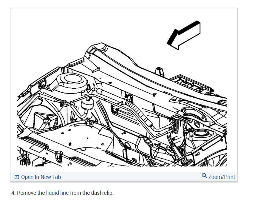

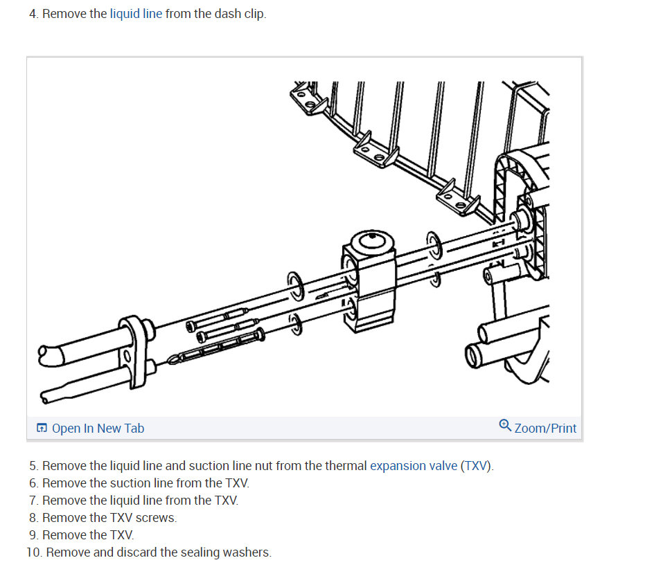

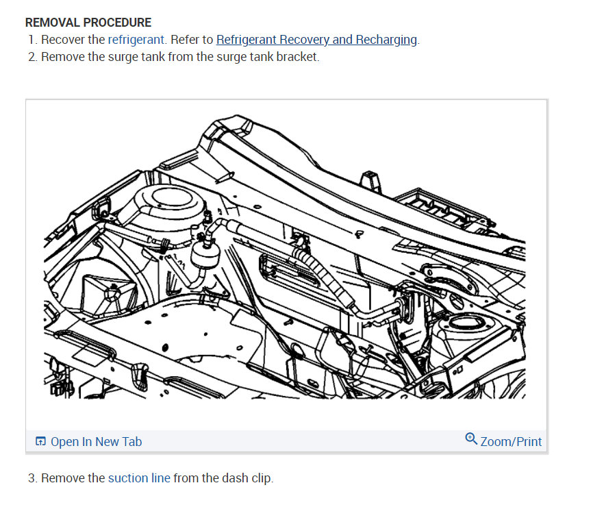

The TXV or expansion valve is the reason the low side pressure is too high. I attached the procedure for you for the repair.

Yes Roy, I took this image right before it took the last 2 ounces of refrigerant. The image does show it was 28 to 30 and not 38. The A/C is cold but I did not measure the exact temperature. I will measure it and send it to you.

Great. The pressure looks good.
The temperature at the vents should be 60% of the ambient temperature.
