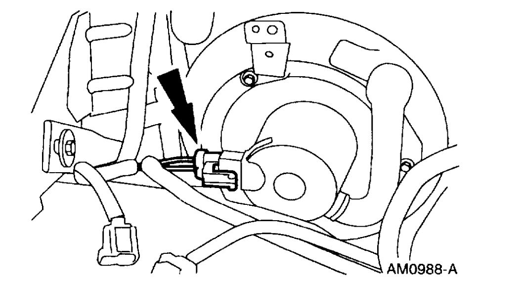

Hit a bump hard got a flat tire and then the A/C quits blowing inside car.
May 27, 2018 at 9:45 AM
Good afternoon.
I would suspect the connection for the blower motor may have been disturbed. Check the connection for proper mounting and see if there is any damage to the connector or the pins.
It is located on the right front outside and low back by the windshield.
