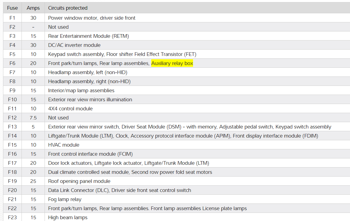

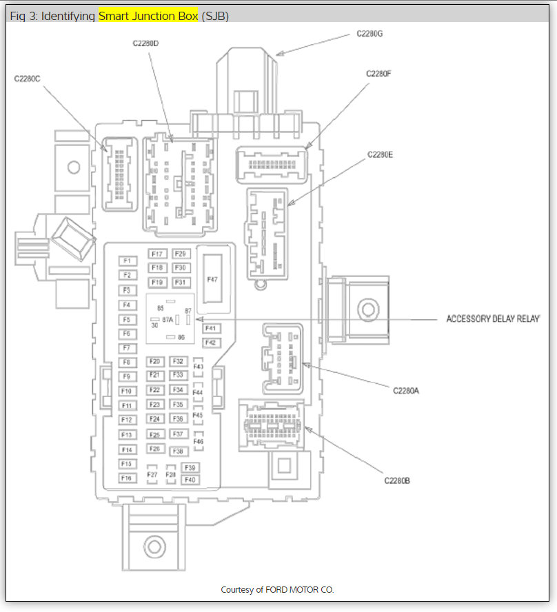

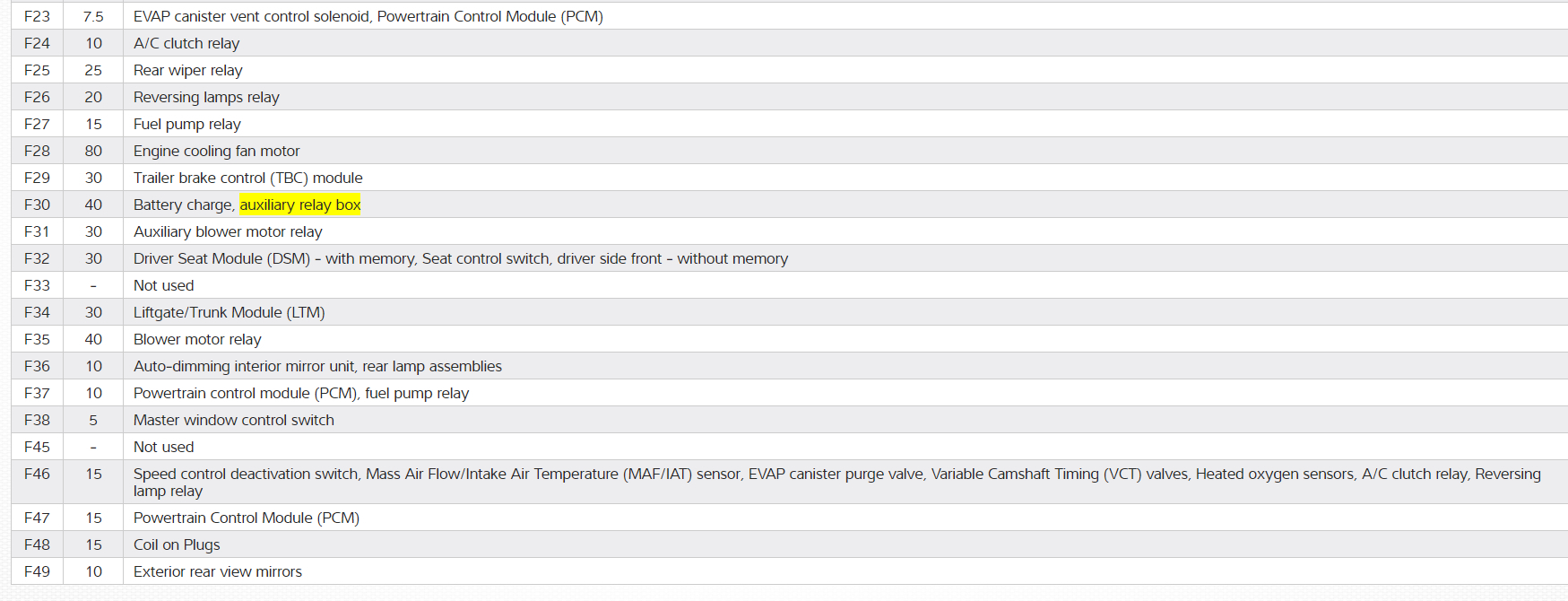

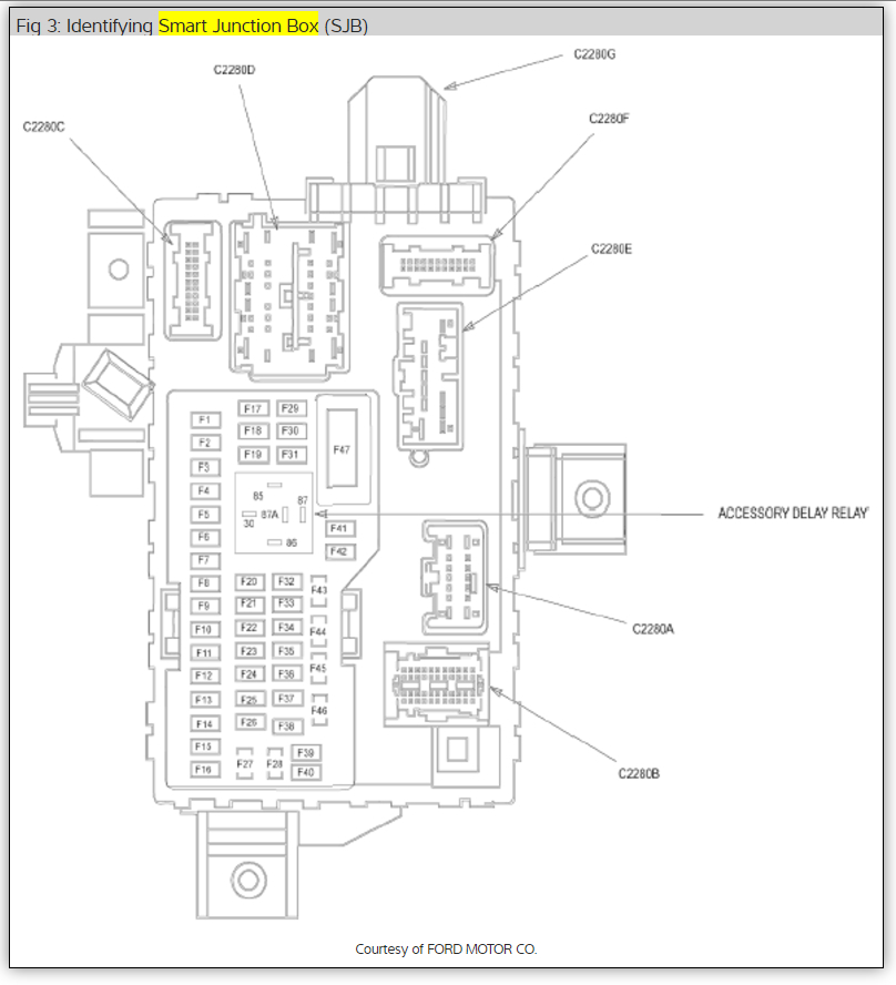

The driver side temperature was warm when it was cold in the rest of the vehicle. When we replaced the blender door on the driver side now the car is hot everywhere no AC anywhere. please help
Sep 9, 2017 at 2:31 PM
  • 55,224 POSTS

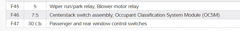

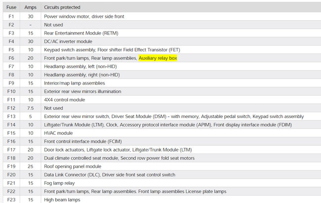

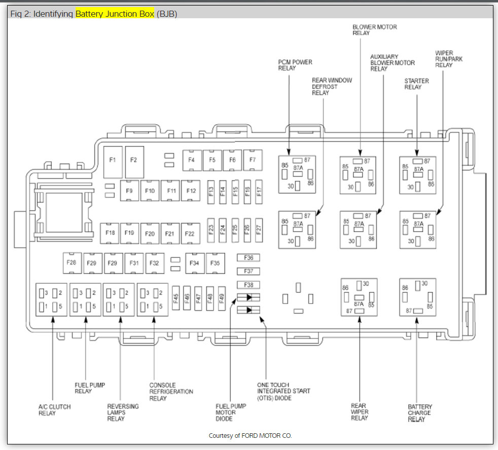

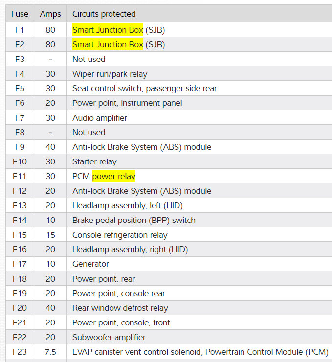

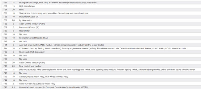

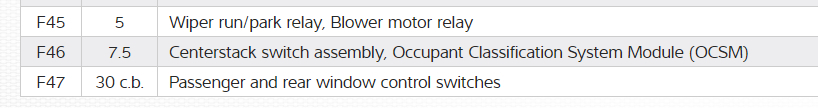

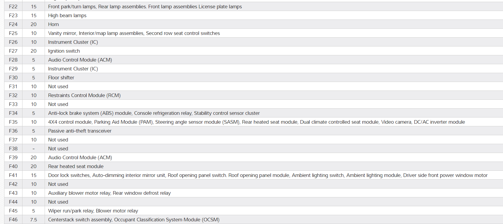

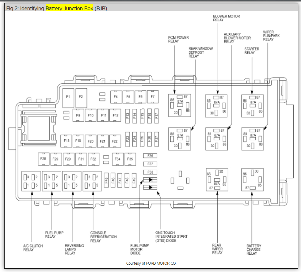

It sounds like you may have blow a fuse. lets start by checking we can go from there.
Here are is a guide and some diagrams (below) that will help us get started:
