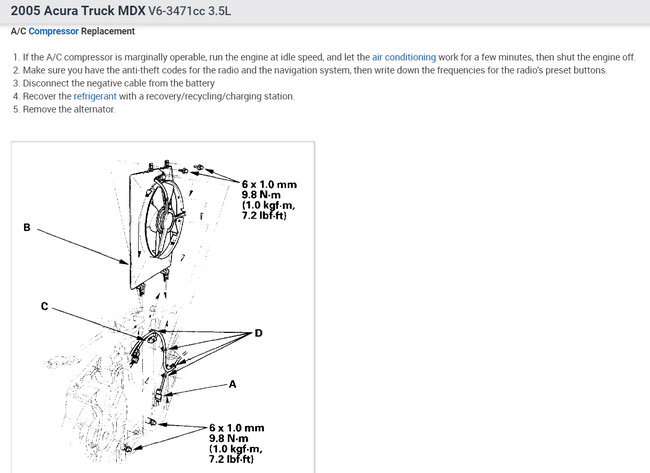

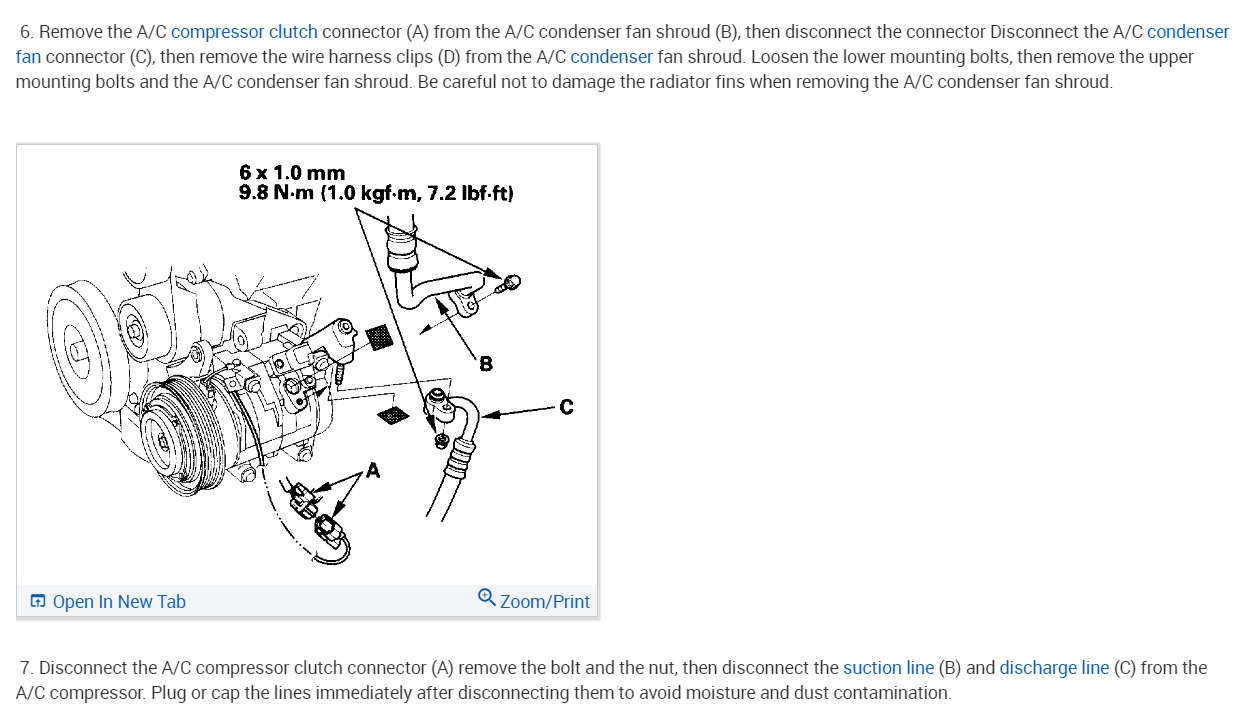

Added little bit of Freon, now static pressure is 75low/100high, and with A/C on 70low/170high at 90 degrees. What could be wrong?
Aug 21, 2023 at 7:03 AM
Experienced Mechanic
55,710 POSTS

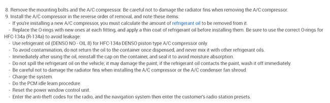

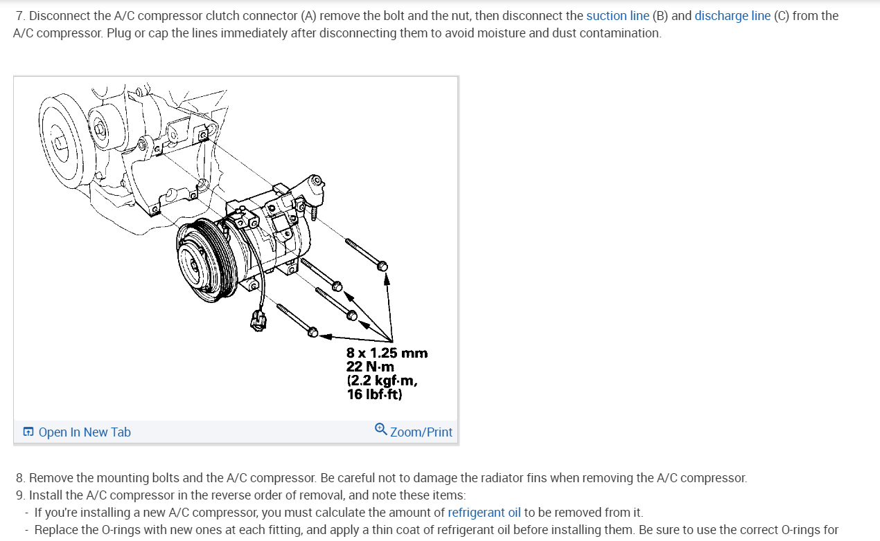

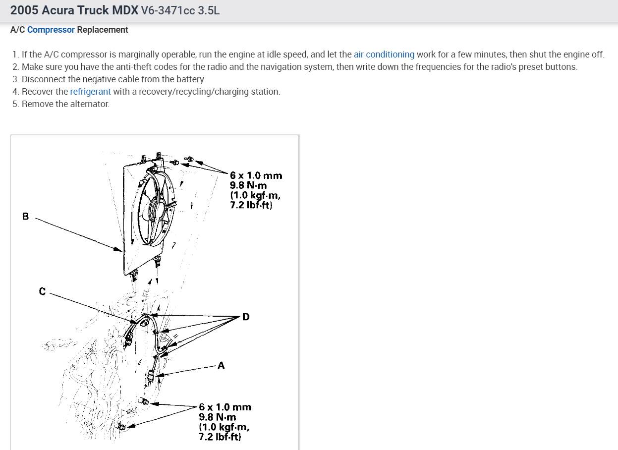

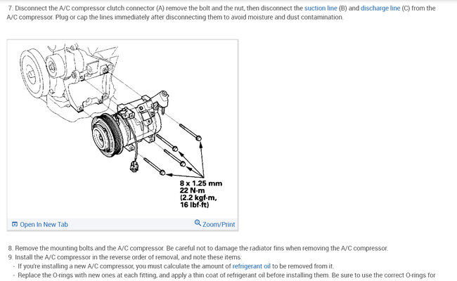

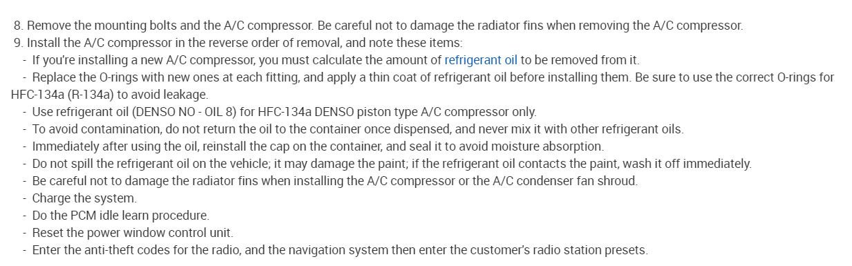

You have a bad A/C compressor, here is a generic guide to help you step by step with instructions in the diagrams below to show you how on your car:
https://www.2carpros.com/articles/replace-air-conditioner-compressor
and this video will help:
https://youtu.be/4EqdrBVb0sY?si=7vkyDTTO6gm0Zbx7
