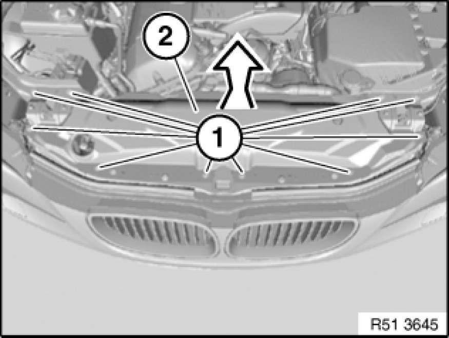

Okay so the issue I am having I have been told is common among BMW's but I still would rather ask to be sure. Here is the issue, when starting the car for the first time of the day or starting it for the first time after being off for awhile when you turn AC on it is not very cold, or even cool. It is not warm/hot at all though, no matter how long I let it warm up it will only get some what cool. Once I put the car into drive or reverse and start moving the AC will then get cold and stay that way. Running it does not effect idle or engine power in any noticeable way. I am wondering what could cause this. I checked my coolant levels and added some, but other than that I am not able to find any cause of this.

I have to be honest, if the car is hot and not being driven, chances are the AC condenser is not being cooled by movement. The job of an AC condenser is to convert the AC gas into a liquid form by cooling it. If the vehicle is sitting, it really cannot do a good job of converting the gas into liquid.
The AC condenser is located in front of the radiator. I have attached a picture for you to see. Make sure it is clean and not contaminated with dirt, leaves.
If you find that is clean, then I would suggest having the system evacuated and recharged.

While all that Joe says is true BMW has had many issues with the electric cooling fans and their controls. If you turn the AC on cold while sitting still you should hear the condenser/cooling fan start and run. I would bet it is not moving. The issue then is that you need to determine if it is the fan or the control circuit. That is tricky on these because the fan has dual controls, a pulse width modulated signal and a full power high speed section controlled on if the coolant temperature gets high. To actually test it you need a way to activate the fan at various levels and look at the signal to the fan as you control it. Some people opt to just go find a replacement used fan and install it if they do not have the scan tool and O-scope or test meter to see what the signal is doing. It is hit or miss, if the problem is the fan, it works, if it is in the controller, you bought a fan but still need to test the controller.
