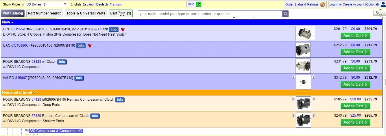

I noticed two different types of A/C compressors for the 2003 Frontier. One is for supercharge and the other one non-supercharged. The only difference I can see is the compressor for supercharge has a six groove pulley whereas the non-supercharged has a four groove pulley. Is this the only difference? Also mine has a heat switch so when I order a compressor need the heat switch? I would think so in order not to confuse the ECM computer. Thank you for the replies and been most helpful. It indeed is a bad compressor.
Thursday, July 4th, 2019 AT 9:43 AM
  • 52,797 POSTS
Use the one that is called for your truck. It must be exact.
From the looks of it, yes, that is the difference.
