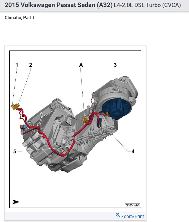

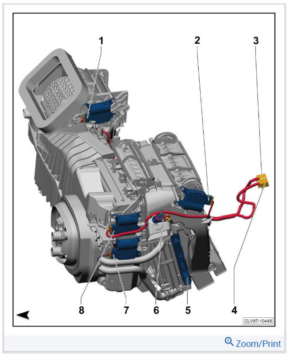

AC was working, sometimes when turned off it would continue to blow cold air like it was not turned off. A couple of times there was this loud noise sounded like a hose come loose, but could not find any hose loose. AC continued working. Now it is blowing hot air and when AC turned off it stays engaged. Help please.
Can you post an diagram of the relay? Trying to find location of that and the thingy that is supposed to turn when going from hot to cool. (Actuator?)
Aug 23, 2018 at 7:24 AM
  • 55,423 POSTS

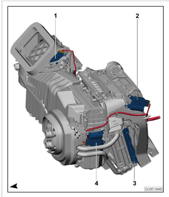

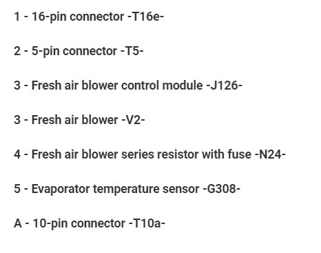

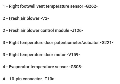

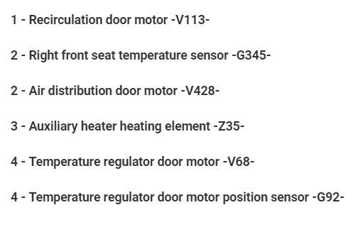

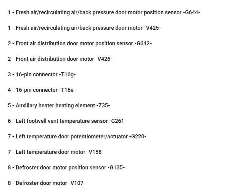

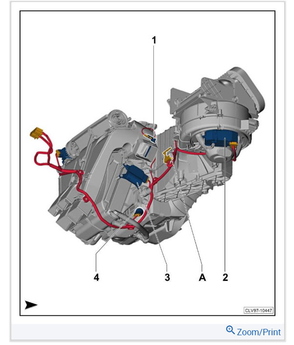

It sounds like the temperature blend door actuator is having an issue. Here is a guide the show you step by step what you are in for with diagrams below to help you see the location of the temperature blend door below:
Here are all the blend door actuators for you car (below). Please let us know what happens.
