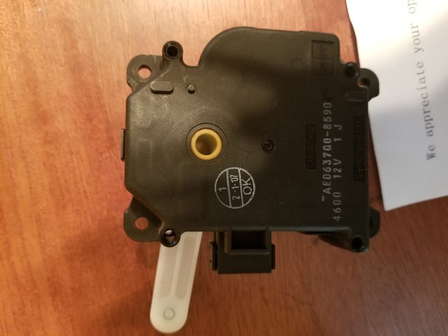

I changed the actuator on the passenger side right behind the radio and the A/C wont blow through the front vents still. can someone please help me out?

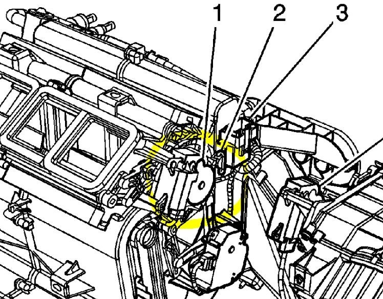

There are several actuators behind the dash.
The mode actuator requires the dash to be removed.
I attached a picture of the actuator. Is this the one you replaced?

The one right behind the radio is the one I got changed out and the guy that did it said they have another actuator on the driver side. could that be the problem? I'll post a picture of the one I swapped out.

It sounds like he changed the blend door not the mode door.

Good morning,
I answered this before for you and you never responded.

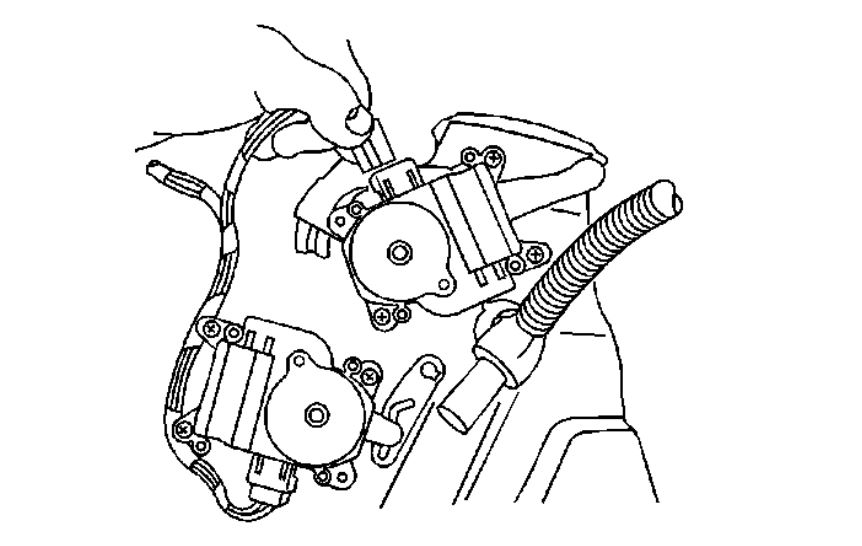

Did you replace the one that I attached with a picture? There are many. The dash has to be removed to gain access to the actuator.
I attached another picture for you. Is the one I circled the one you replaced?
