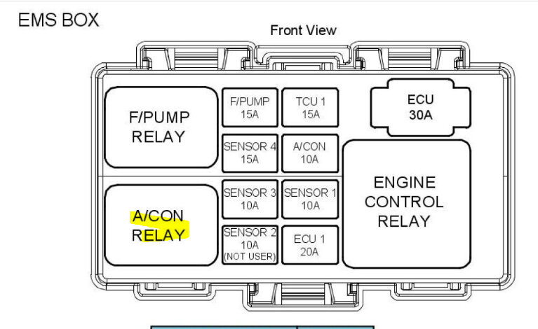

Put on gauges everything checks good as far as refrigerate goes and pressure. Fans working no leaks. Clutch on compressor works and cold air when you first start car. Lines are also cold. Drive it about 2 or 3 miles and clutch quits and warm air. Let it set for a while and have same scenario.
May 16, 2023 at 3:02 PM
  • 110,194 POSTS

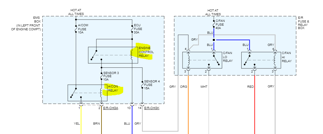

It sounds like it could be a faulty relay. The A/C relay is located in the EMS box under the hood.
See pic 1 and 2 below for locations. Switch the A/C relay with a different one in the box having the same part number. See if that eliminates the issue.
If there isn't one to switch, here is a link that explains how to test a relay.
Let me know what you find.
May 16, 2023 at 8:51 PM
LARRY A
  • 5 POSTS
Switched out relay with one identical. Just got home from work so the clutch was not working. Clutch still didn't engage with relay switched. I even tried jumping switch and would not engage clutch. But it will probably work after the car cools down.
