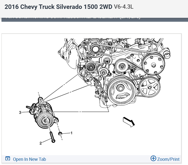

Ac is blowing hot. All fuses seem ok clutch engaged and pressure is 120psi low side 130psi high side
Aug 19, 2026 at 5:45 PM
  • 55,746 POSTS

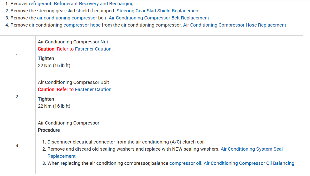

You found the problem, those pressures mean the AC compressor is no good so you need to replace it, Here is a guide and a video to help yo and instructions for your car in the images below. Here is a generic compressor replacement guide, go over it first before you begin.
https://2carpros.com/articles/replace-air-conditioner-compressor/
Here is a video to watch as well.
https://www.youtube.com/watch?v=4EqdrBVb0sY
Let me know how it goes.
