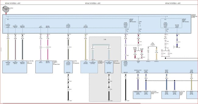

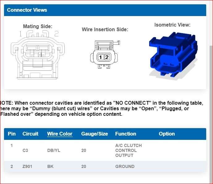

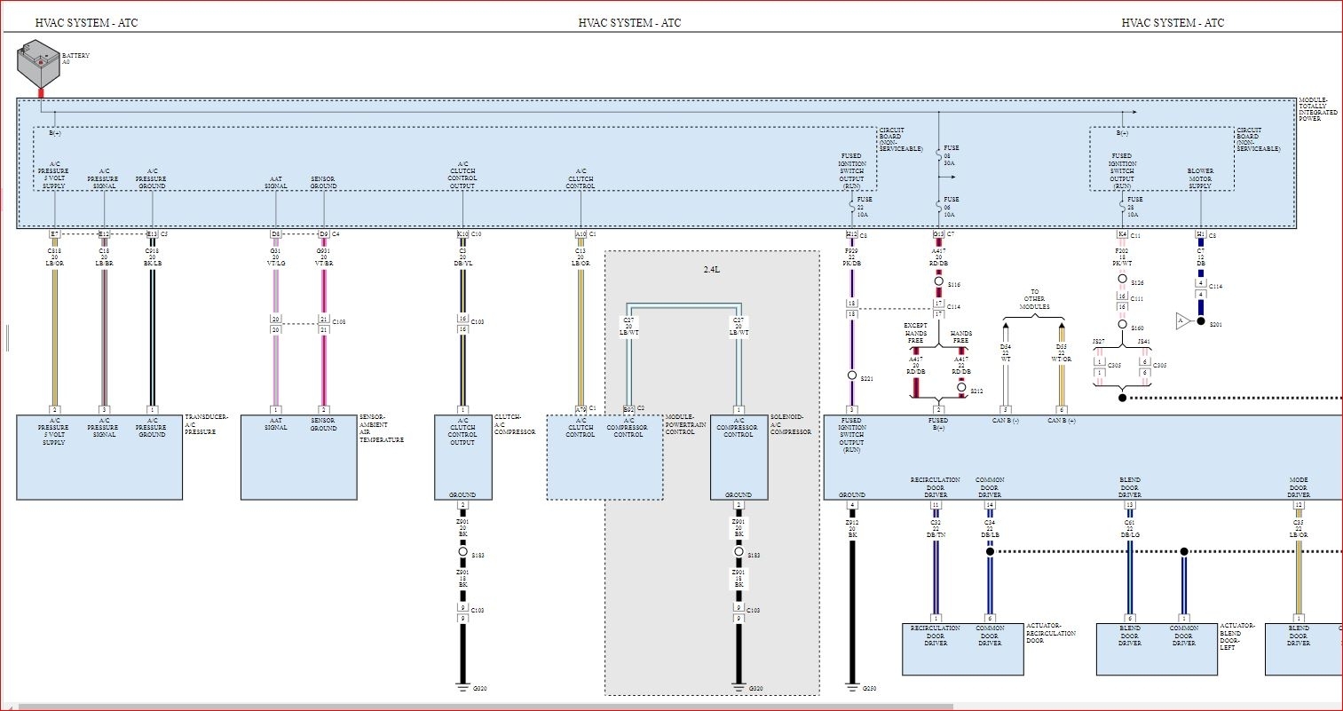

Looking for A/C relay so I can manually engage compressor so I can charge system.
Jun 5, 2019 at 2:21 AM
Hi DGray75,
This vehicle has what is called a TIPM or totally integrated power module. There are no relays for the clutch. It is contained within the module on a non serviceable circuit board.
You would have to jump power directly to the compressor. However, if you turn it on and start filling the system, the compressor should kick on once you get a minimal amount of pressure then the compressor will short cycle and pull more in and eventually run as normal.
Here is a guide that helps explain this:
https://www.2carpros.com/articles/air-conditioner-how-to-add-freon
Also, just make sure you have evacuated and pulled the system into a vacuum if you had it open. You need to get the moisture out of the system. Let me know if you need more Information. Thanks
