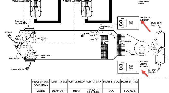

Air conditioner is a single control system. It is blowing cool on passenger side vents but warm on driver's side and center vents. Mechanic says it is only has one actuator so is ruling that out. Any ideas?
Jul 12, 2016 at 7:47 AM
HMAC300
  • 48,601 POSTS

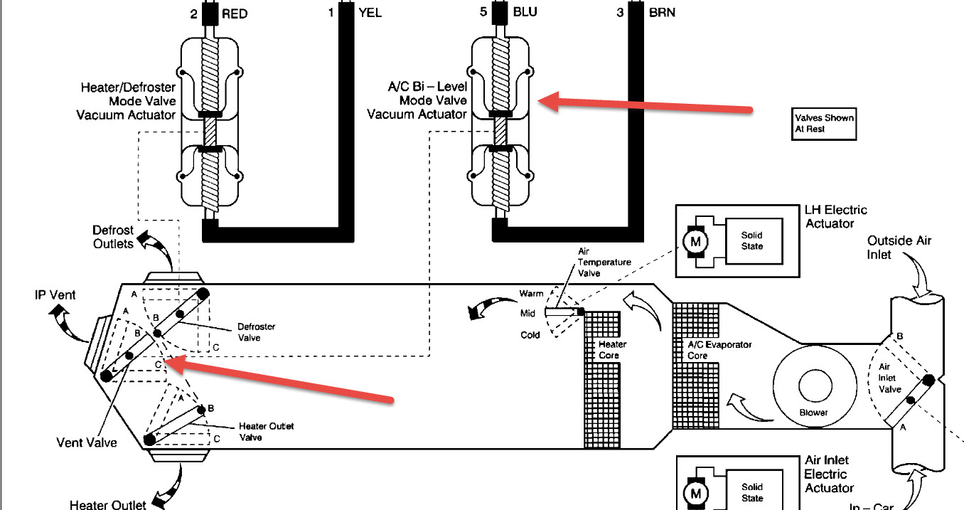

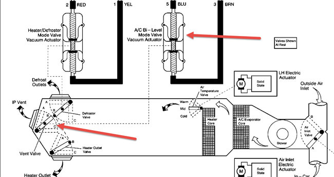

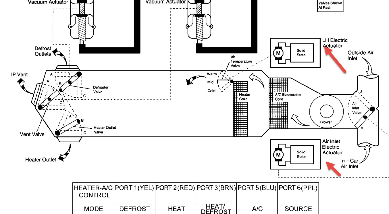

actually it has two actuators and half the system is run by vacuum, check for a vacuum leak or the vacuum motor in picture is not opening door for ip vent.
