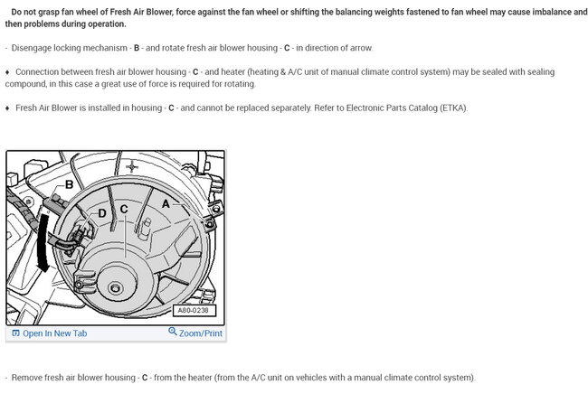

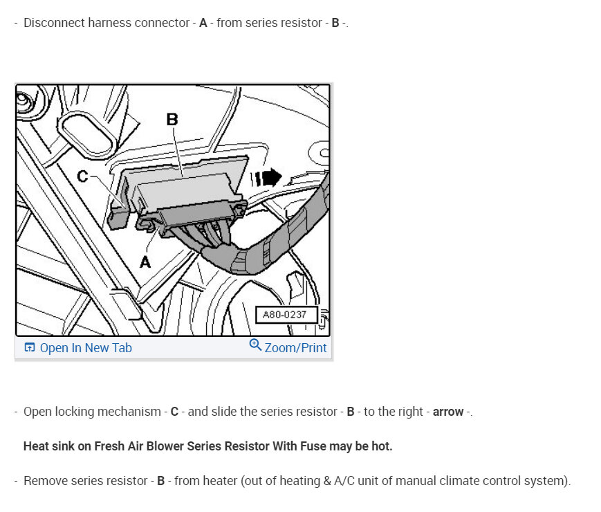

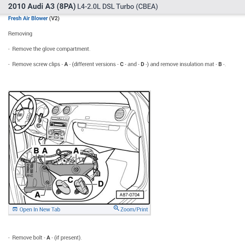

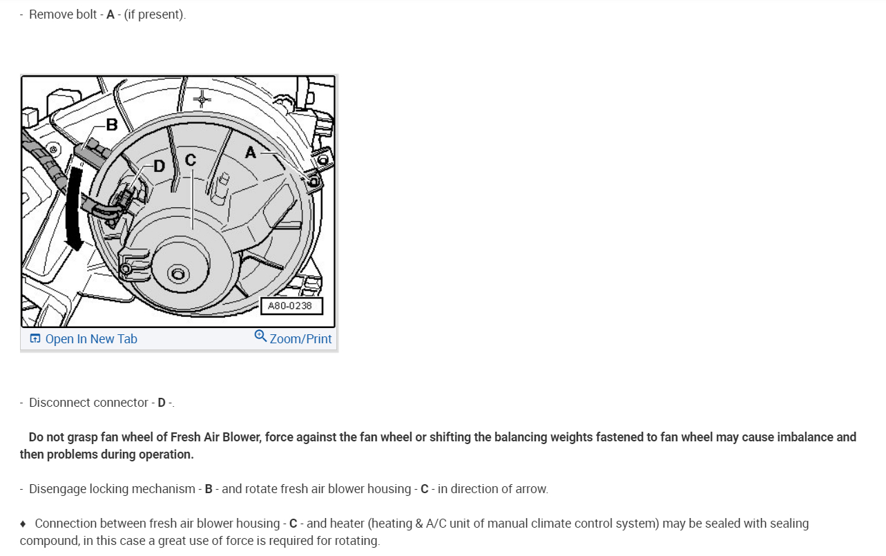

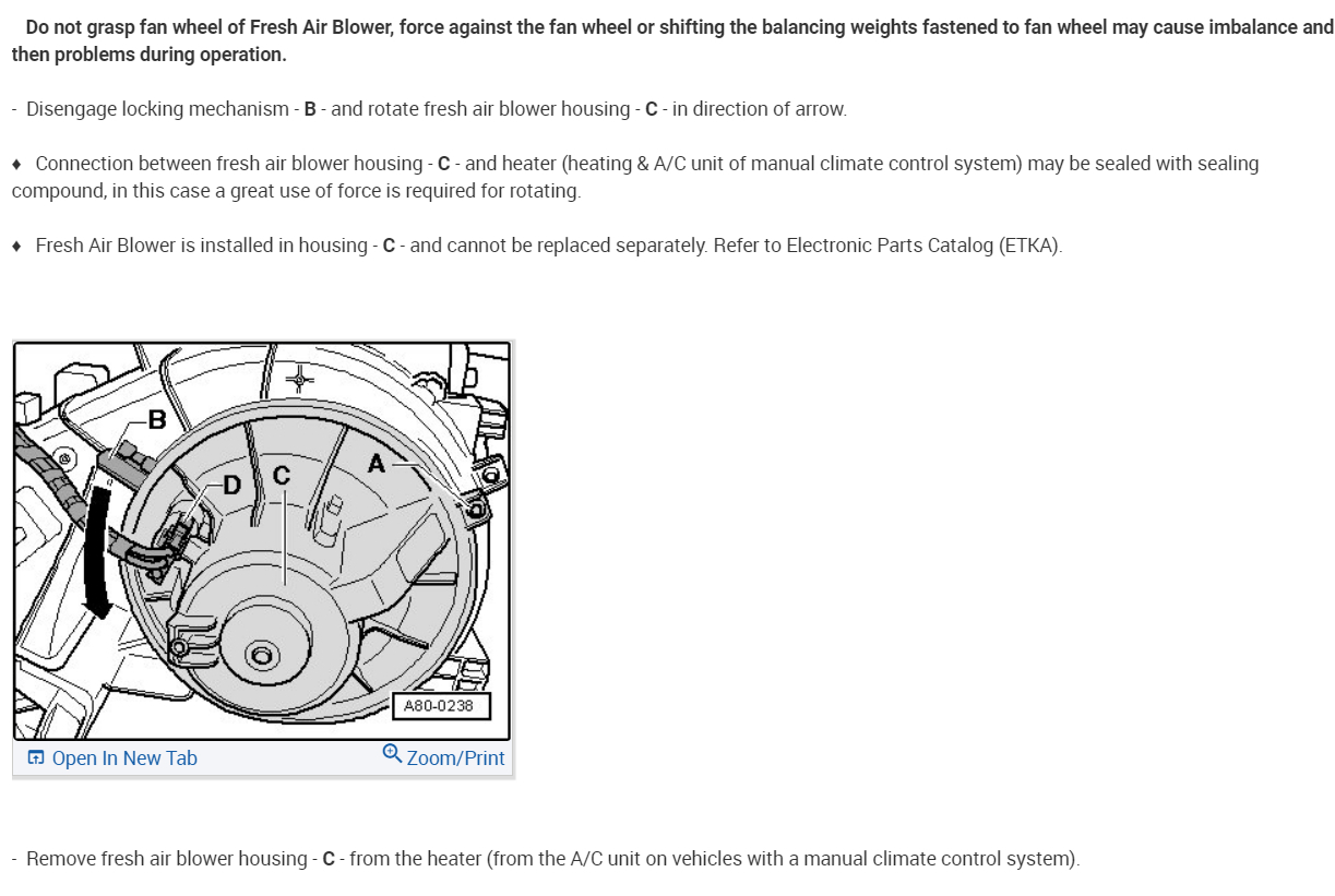

The A/C compressor is engaged but the fan motor is not running. fan motor does work in mornings but not in the afternoons.
Jun 28, 2023 at 2:44 PM
  • 55,781 POSTS
This is a common problem when the blower motor starts to go out or you have a bad connection at the blower motor or control module. Here are the locations and a guide on how to test the blower motor power and ground to help confirm the failure. Here is a generic guide to help you step by step with instructions in the diagrams below to show you how to use your car.
https://www.2carpros.com/articles/blower-fan-motor-works-on-high-speed-only
