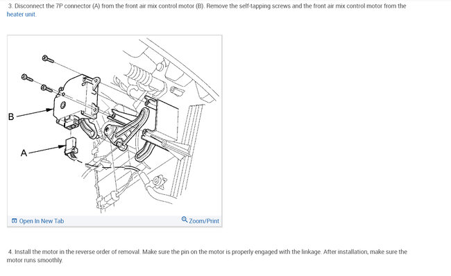

I have heat and A/C in the rear of the van, and I have heat in the front but no A/C. What could be the problem? Please help.
May 29, 2023 at 6:06 AM
  • 55,399 POSTS

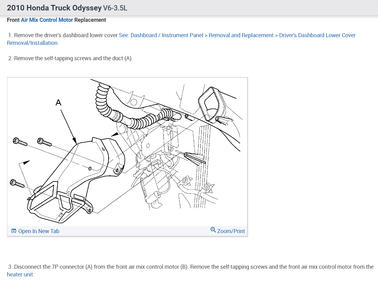

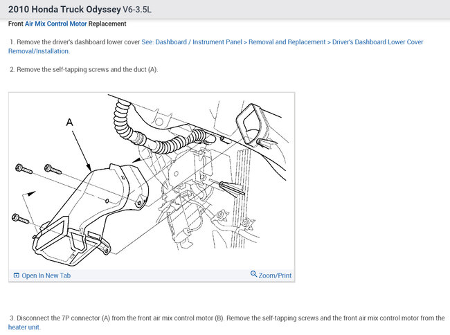

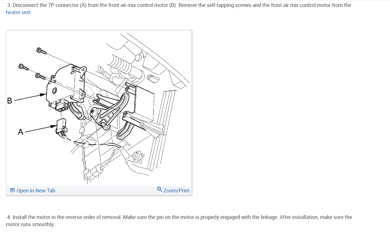

It sounds like the front air mix actuator motor is not working here is the location so you can get a replacement to help fix the problem. Check out the images (below).
May 30, 2023 at 5:33 AM
JEREMYSHORT
I looked at my van today and found that there was USB cord hanging down from the radio that was jammed behind the actuator levers not letting them move I moved the cord and tried it now the A/C works as it should.
