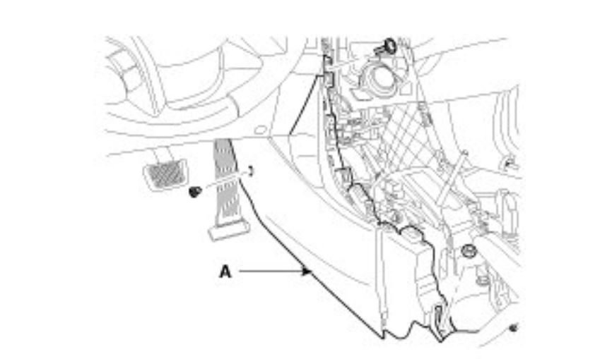

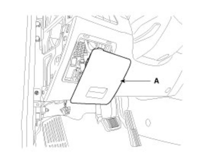

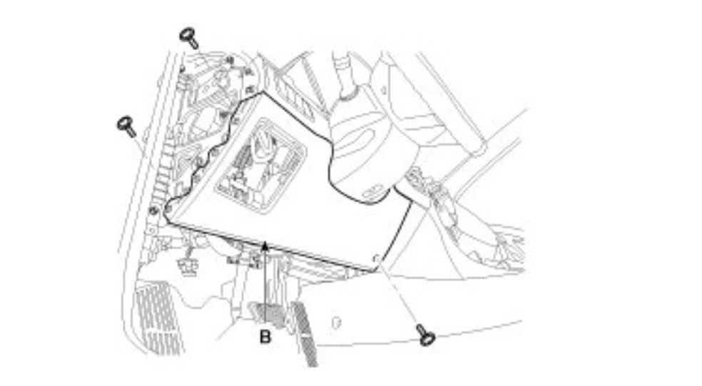

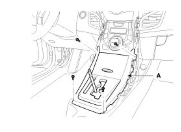

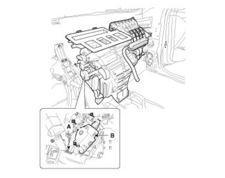

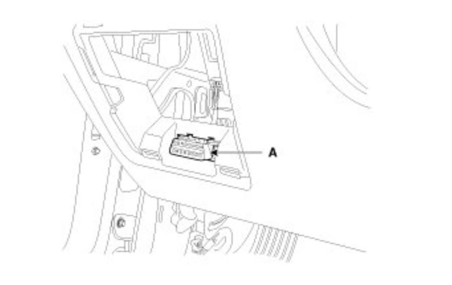

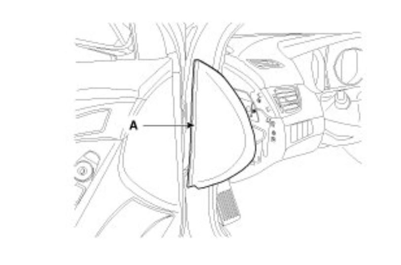

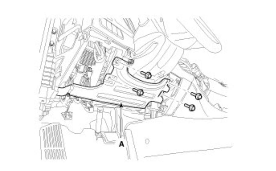

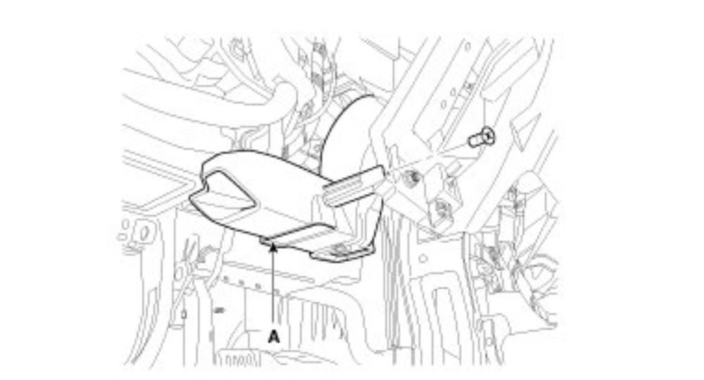

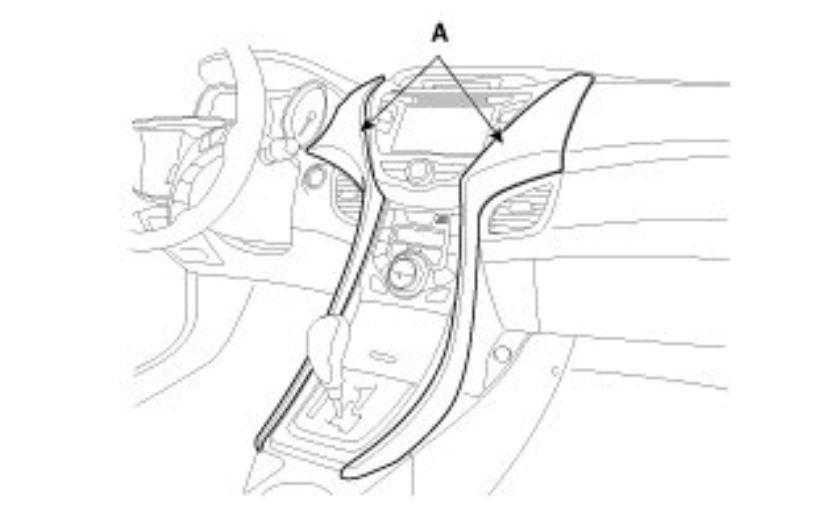

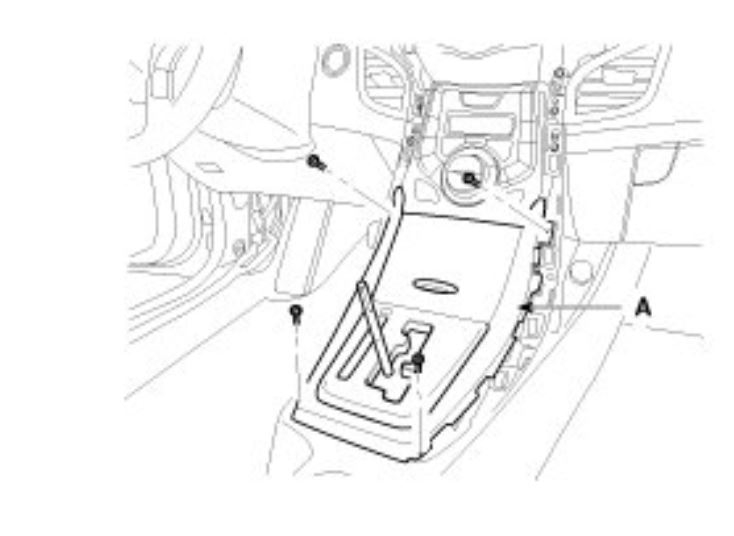

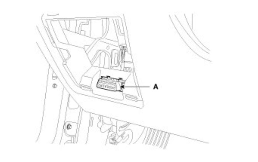

location of the ac blend door actuator? A/C problems.
Jul 2, 2019 at 2:53 AM
Good afternoon,
I attached the procedure and pictures for you for the repair.

2. Using the screwdriver, remove the center garnish (A).
3. Loosen the mounting remove the console upper cover (A).
4. Remove the center console assembly.
5. Loosen the mounting nut and clip remove the extension cover (A).
6. Remove the side cover (A).
7. Disconnect the fuse box cover (A).
8. Loosen the mounting screw and then remove the crash pad lower cover (B).
9. Disconnect the diagnosis connector (A).
10. After loosening the mounting bolts, then remove the reinforce panel (A).
11. Remove the shower duct (A).
12. Disconnect the temperature control actuator connector (A)
13. Loosen the mounting screw and then remove the temperature control actuator (B).
14. Remove the side cover (A).
