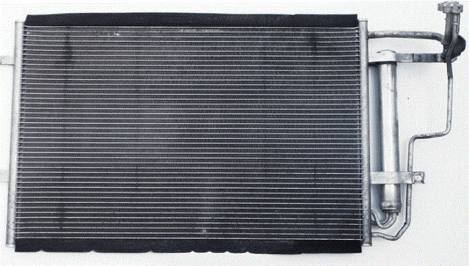

A/C blowing hot air while parked, but blows cold while driving
2014 CADILLAC SRX
115,465 MILES
ALCUS MISKELL
I put it on an A/C machine, and everything was fine.

Two things to check. First, does the condenser fan (at radiator) turn on when the system is turned on? If it does, check the condenser in front of the radiator and make sure it isn't being blocked from air flow and isn't dirty. The condenser looks like another radiator. See pic below. If it is dirty, spray it off with a garden hose to clean dirt and debris.
Additionally, here is a link you may find of interest:
See pic below.
