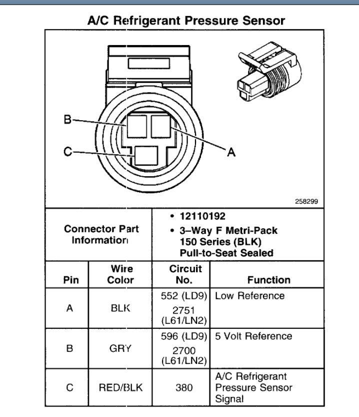

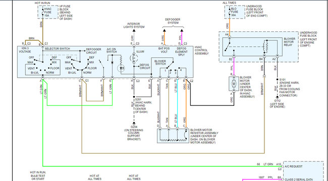

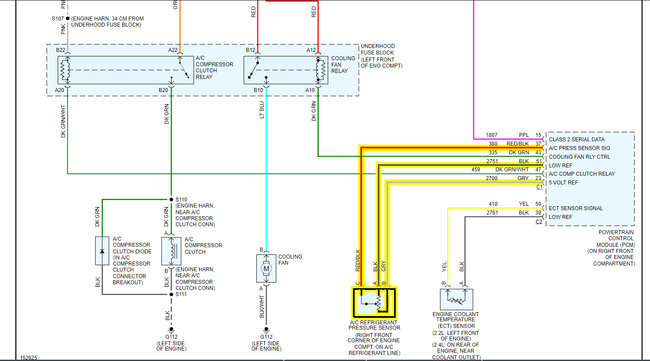

Bought new pigtail for the pressure switch the colors are different. on the car is black white and red with black. the new one is black white blue what goes to what??
Jun 10, 2021 at 2:30 PM
Good morning,
I attached the wiring diagram and the connector diagram for you to view.
The connector diagram tells you the location of the wire for replacement. Just attach the wire to the terminal marked for the color.
