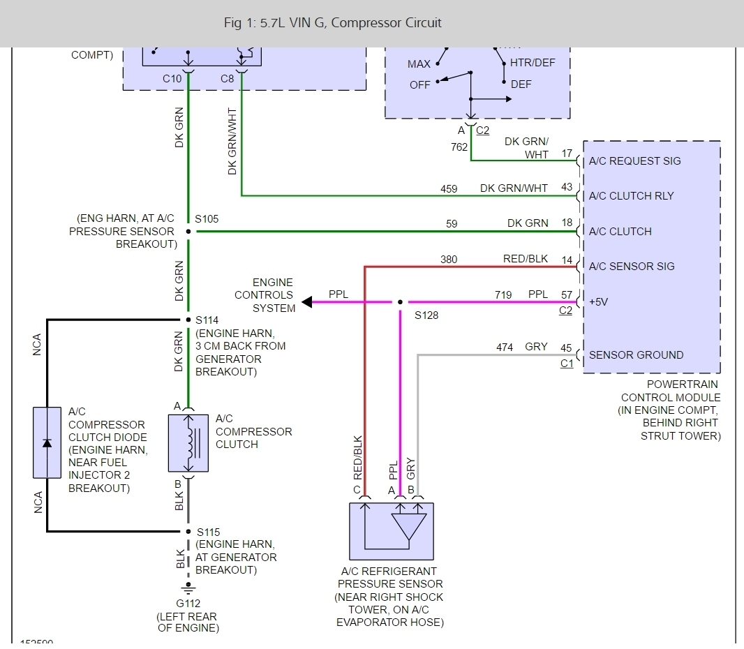

It is a three way pressure switch, use this wiring diagram to help you.

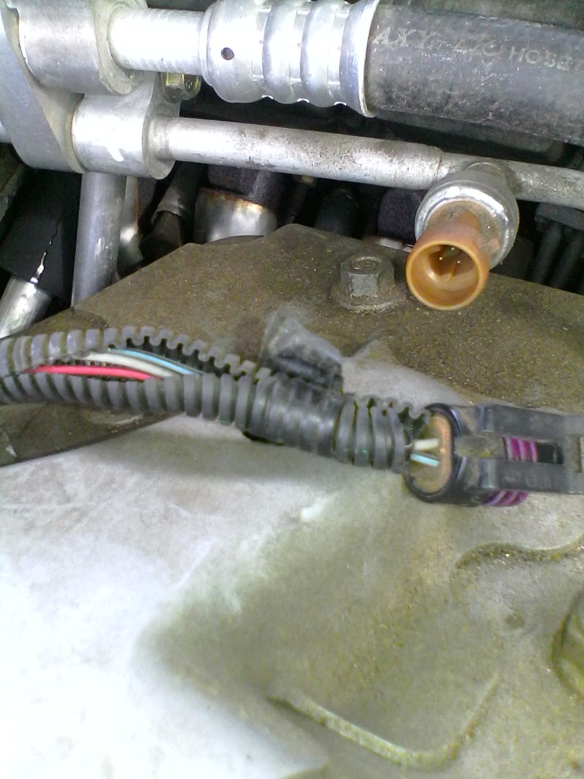

is this it? will the ac leak if I take off ? does it un-screw? thanks all i appreciate it
Sep 1, 2016 at 6:53 AM
WRENCHTECH
  • 20,761 POSTS
It may have a schraeder valve under it to hold the refrigerant but I wouldn't take the chance that it may not. I would evacuate the system first.
