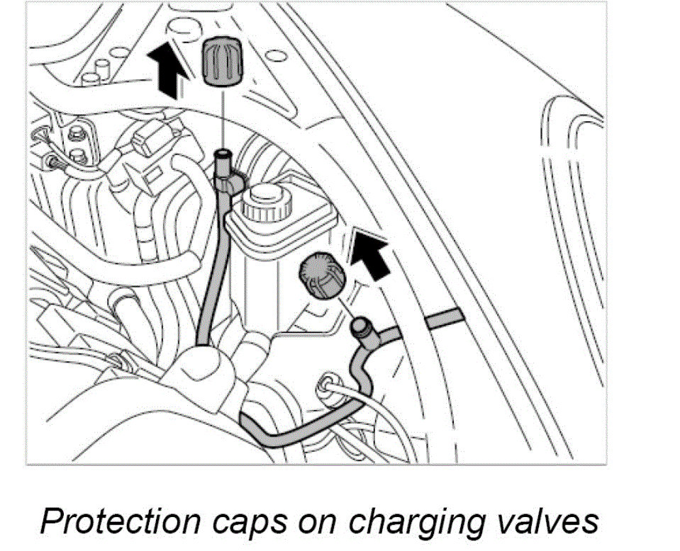

Where are the A/C ports located?
2010 PORSCHE PANAMERA
86,000 MILES • V8 • 4WD • AUTOMATIC
BHAMDOC1973
  • 2,007 POSTS
I think it's a bit low on freon. The passenger is so cold, the driver is halfway. Where should the gauge be on these?
Mar 16, 2022 at 11:29 AM
  • 110,241 POSTS
The low-pressure port is located on the driver's side under the hood near the inner fender. See pic 1.
The pic shows the locations of both the high and low-pressure ports. Here is a link you may find helpful when adding Freon:
https://www.2carpros.com/articles/air-conditioner-how-to-add-freon
Note: The freon will be added via the low-pressure port. The cap covering the port should have an L on it.
