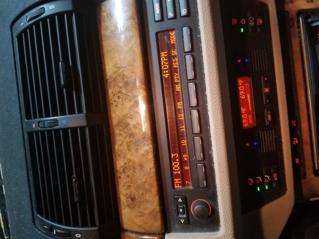

My AC in my car is not blowing out any air. However, my panel is working. What do I need to check on to fix?

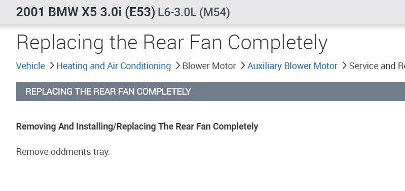

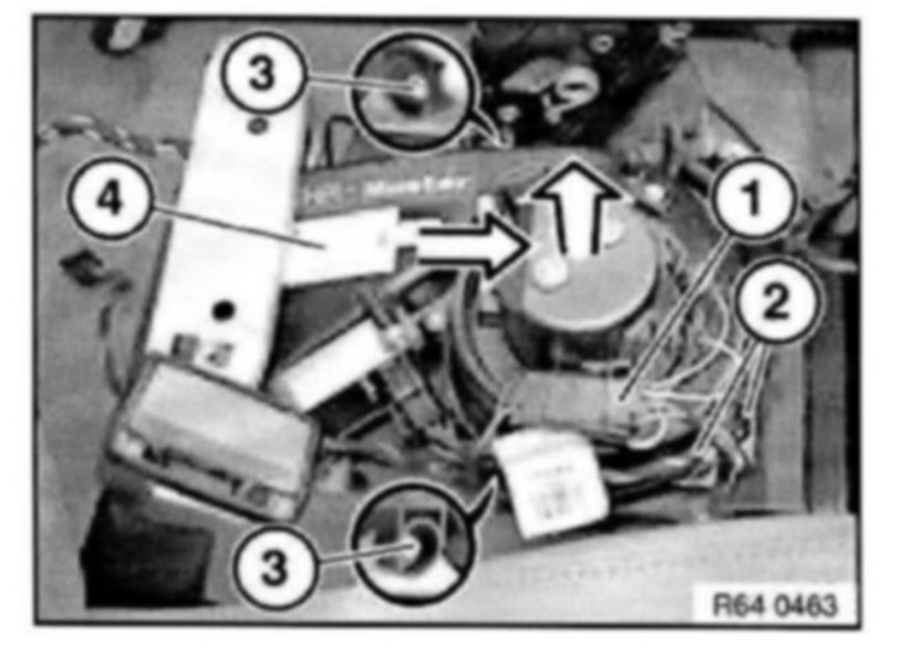

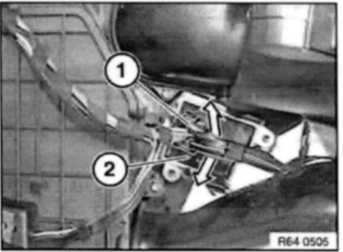

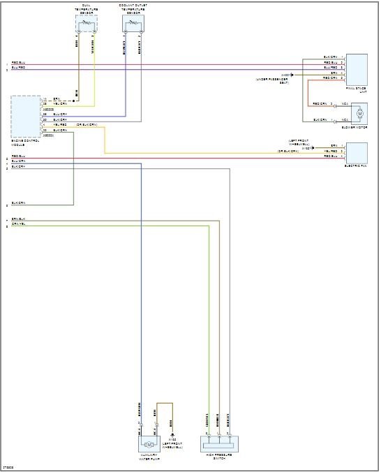

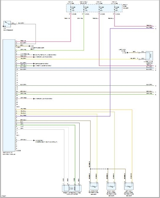

Here's what I have for the removal and installation of the blower motor on your vehicle. I have included it in the diagrams down below. You might want to check the"Final Stage Unit"they go bad often in BMW's
Thanks,
Alex
2CarPros
Monday, April 8th, 2019 AT 7:31 AM
VICTOR ANGUSTIA
The image does not look like the blower motor for a BMW x5 3.0.

The final stage is suspect. The failure you report is typical and replacement if recommended.
