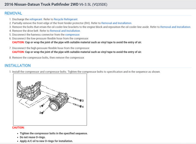

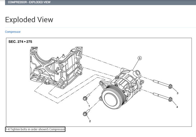

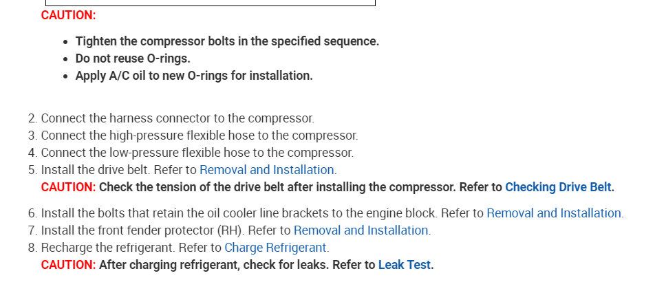

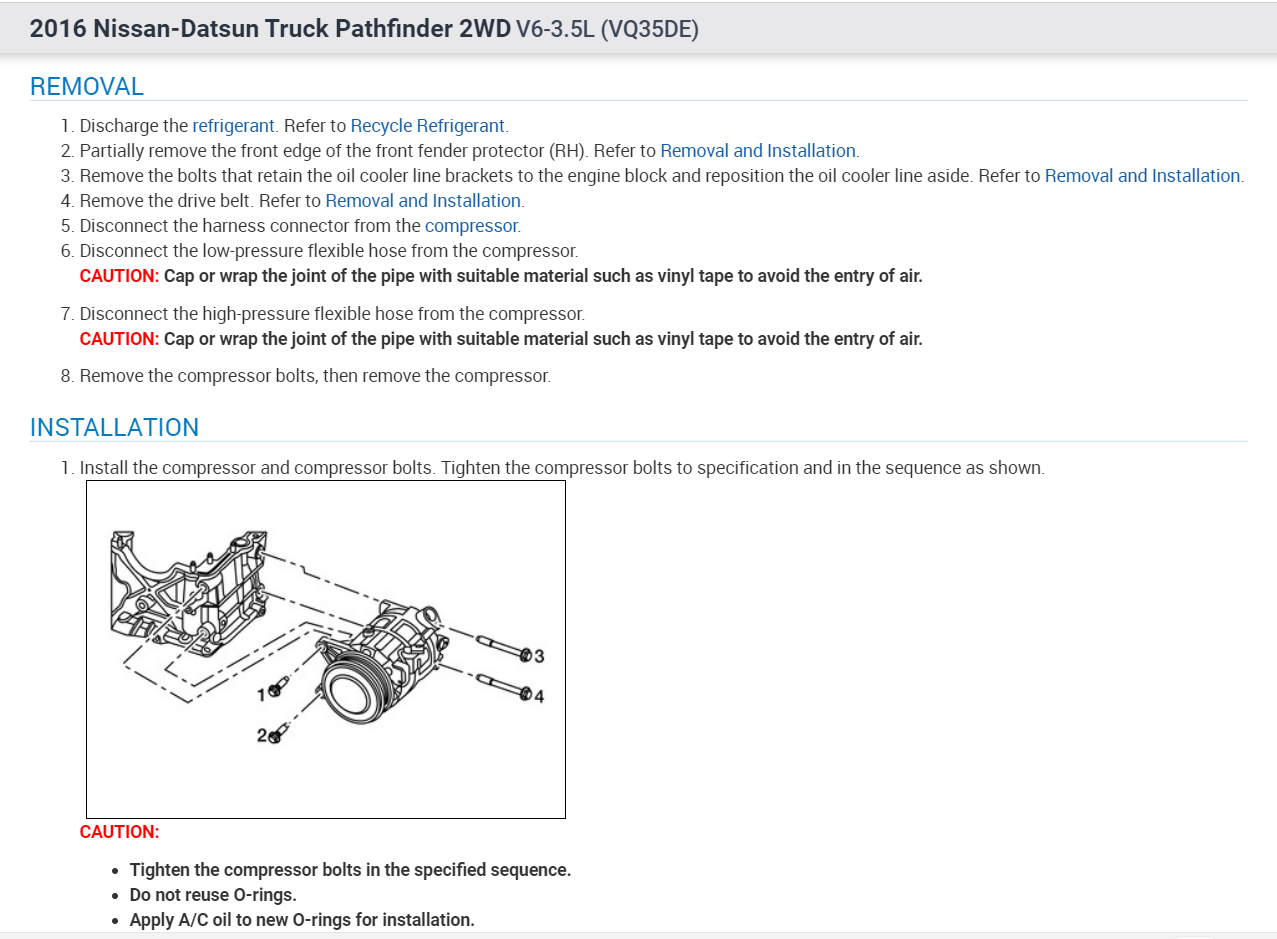

This generic guide and video will help you see what you are in for when doing the job which you will need to run to the auto parts store for to rent a gauge set and vacuum pump. I have included the location and instructions for your car in the images below.

Compressor, R&R 1.6 Hours shop time.
Does Not Include: Refrigerant Recovery or Evacuate and Recharge A/C System
