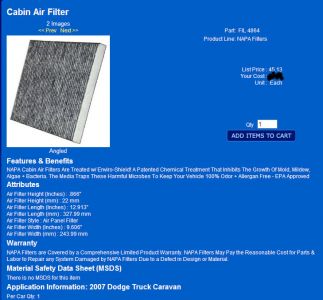

did you change the cabin air filter?
There are different cleaners on the market, some don't work or some don't get in deep enough to the are needed.
I would contact the shop that did the work and ask why it didn't work. They may well do it again at no charge. That is where I would start.
May 11, 2020 at 4:49 AM (Merged)
CLYDE FORD
The service people told me this model does not have a cabin air filter.
SERVICE WRITER
  • 9,123 POSTS
They may be right....
https://images.2carpros.com/forum/automotive_pictures/30961_car_3.jpg
and NAPA is wrong.
