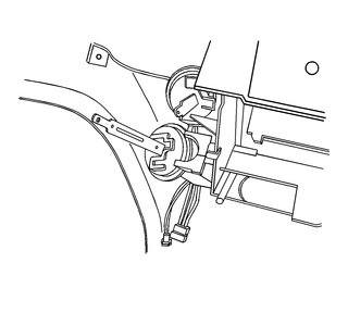

The actuator is located under the dash of the vehicle and not the easiest to get to. Here are the directions. The two attached pics correlate with the directions.
Do me a favor. Before you begin, let me know if the air flow ever changes or if it is always coming from the defrost and floor vents.
2016 Chevy Truck Express 2500 V8-6.0L
Mode Valve Actuator Replacement - Lower
Vehicle Heating and Air Conditioning Air Door Actuator / Motor Service and Repair Removal and Replacement HVAC - Manual Mode Valve Actuator Replacement - Lower
MODE VALVE ACTUATOR REPLACEMENT - LOWER
Document ID: 1748516
Removal Procedure
Remove the I/P carrier. Refer to Instrument Panel Carrier Replacement.
Release the tabs from the lower mode actuator.
Remove the lower mode actuator.
See pic 1
Installation Procedure
Install the lower mode actuator.
See pic 2
Press lower mode actuator on until you hear tabs engage.
Install the I/P carrier. Refer to Instrument Panel Carrier Replacement.

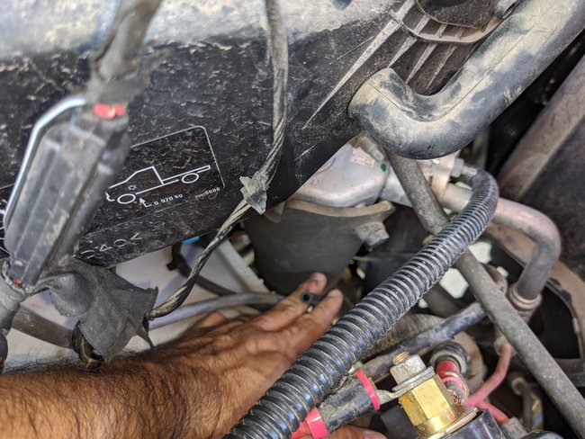

FLORIDAVE
Hi Joe

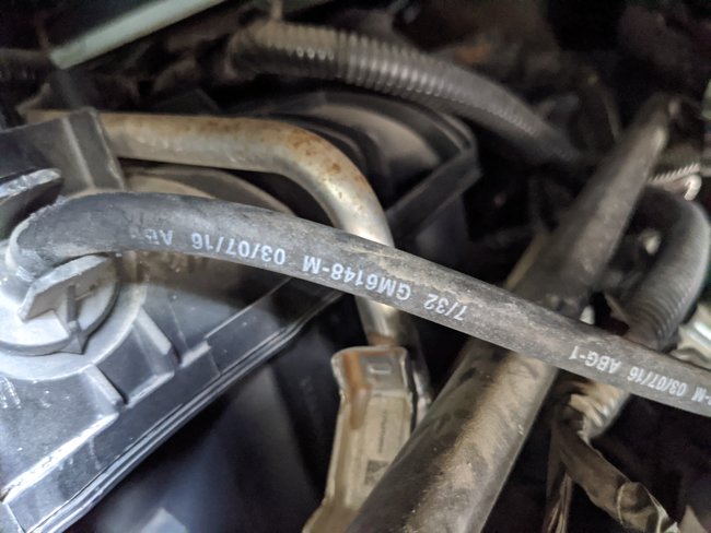

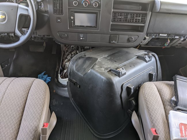

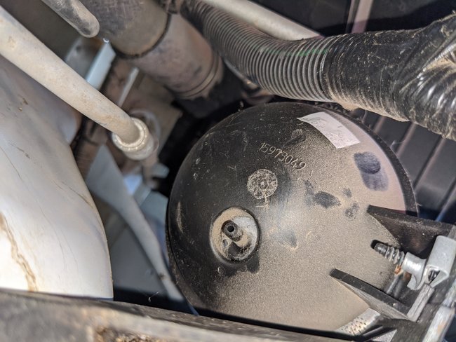

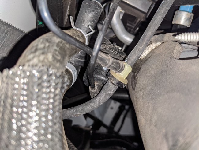

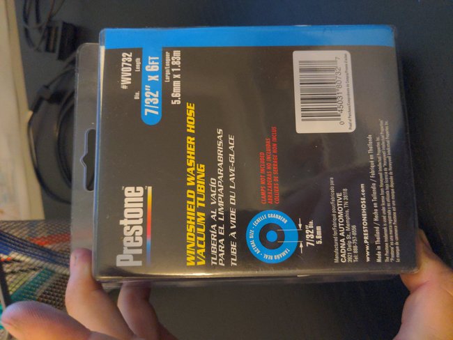

Good news, I found the vacuum leak, I found it by removing the engine cover from inside (1st pic) exposing the engine, I found a vacuum hose on top of the engine that was very brittle and disintegrating (2nd pic) and I ended up buying a new vacuum hose for $3.50 (third pic), I followed this hose to some kind of three way vacuum splitter (4th pic), one of the hoses from this three way was just hanging in the engine compartment (5th pic), I looked nearby and found an open vacuum port on some device I'm not sure (6th pic), when I turned on the engine the AC started blowing out of the right vents, when I change the knobs the vents change correctly and I notice a sighing sound that I presume is the vacuum actuators. I'm very satisfied with how things went and I appreciate your help, this problem has been solved.
Jul 29, 2020 at 3:34 PM
  • 110,194 POSTS
Good job, Dave, and you are very welcome. I'm glad you got it fixed. The last pic you attached is a vacuum reservoir. That is specific to the HVAC system, so you certainly found the issue. That reservoir is to prevent the actuators from changing direction when you turn the vehicle off. It only allows vacuum to go one direction.
Regardless, I'm glad it's working for you. Please feel free to come back anytime in the future if you have questions. You're always welcome.
