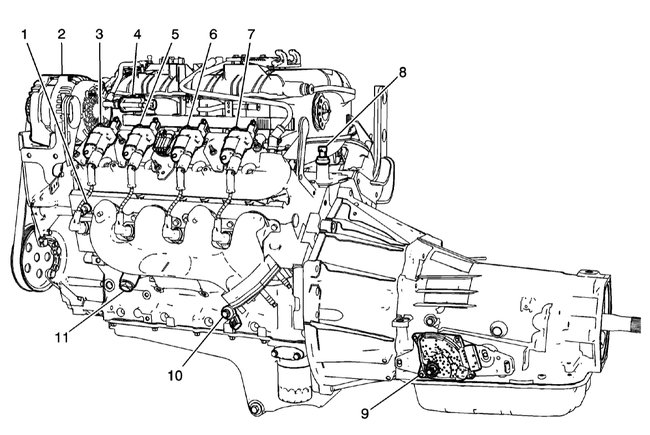

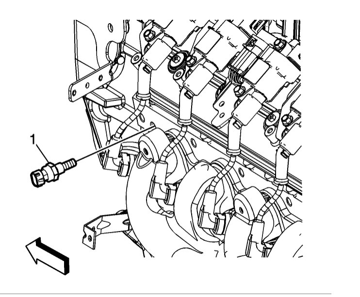

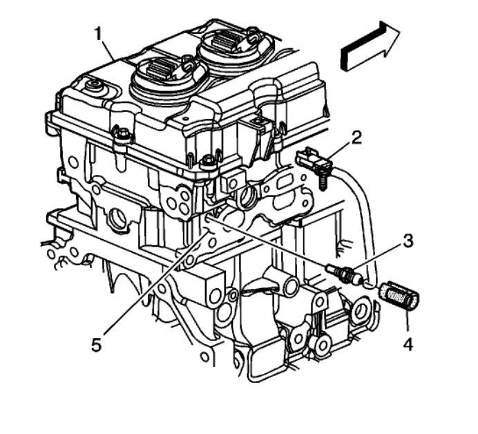

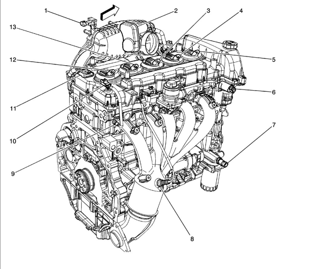

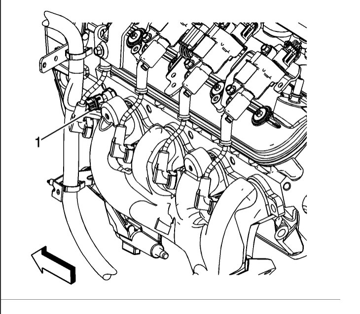

The computer thinks that the engine s overheating and turns the a/c off becasue the engine coolant temperature sensor is gone bad. Here is a guide to help you see what you are in for when doing the repairs.
https://www.2carpros.com/articles/coolant-temperature-sensor-cts-replacement
Here is the location for your car (below)
Cheers
