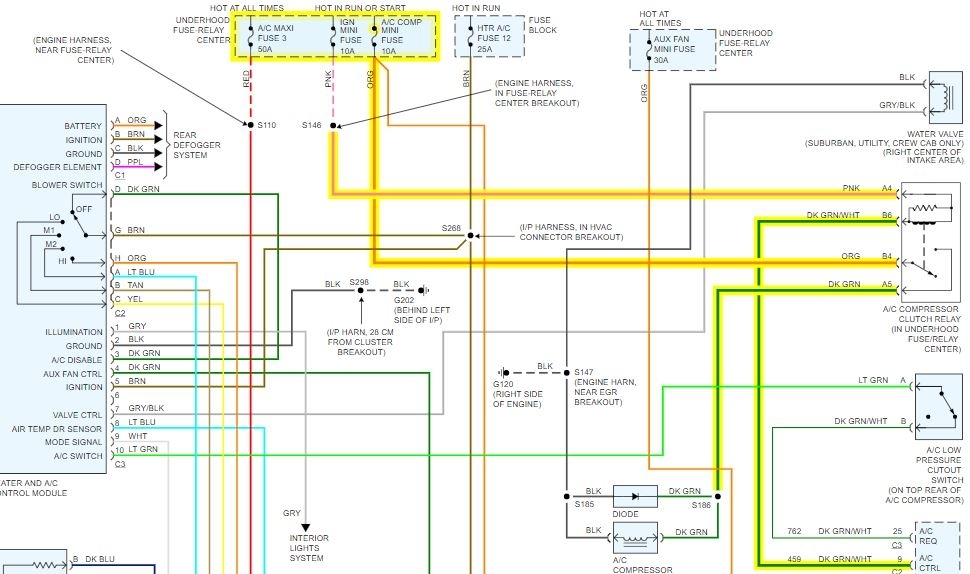

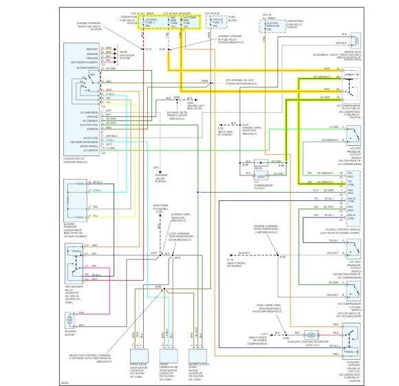

You will need a test light or voltmeter to some checks.
I attached a wiring diagram. Remove the relay and turn the key on. You should have power to 2 terminals.

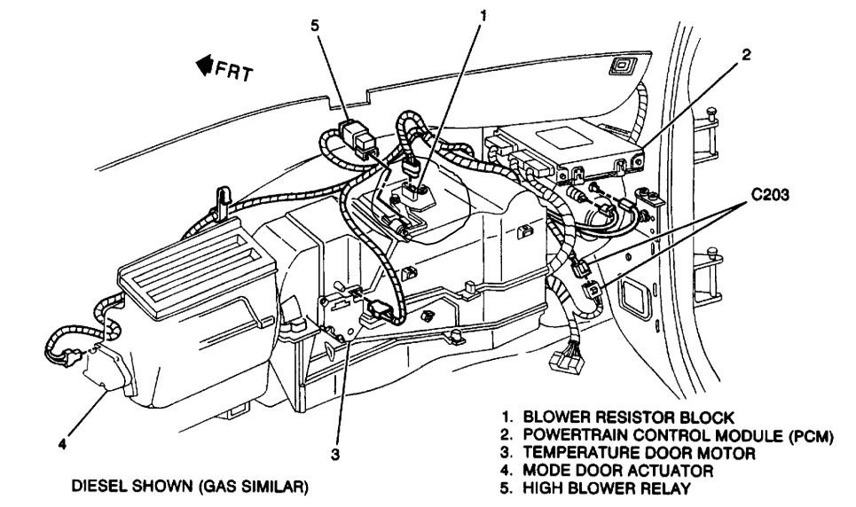

I just ran a test and it has 32 psi on low and 150 on high side. I put a new door blend actuated on but it doesn’t seem to be working right. It blows air through all the vents and the heater and defrost works but only on high.
Saturday, July 13th, 2019 AT 1:37 PM
  • 52,797 POSTS
The blower is from the blower resistor. That should take care of that.

It still needs the paper clip to run. Used a voltmeter to 2 terminals and got plenty voltage “12”. Tested the diode it is good. Getting power to both switches on the compressor, the one in front by the clutch and the one in back of the compressor.

Did you replace the low-pressure switch as I post a while back?
Sunday, July 14th, 2019 AT 1:12 PM
RAYMONVEE
  • 8 POSTS
It’s also new, yes I did.
Sunday, July 14th, 2019 AT 1:51 PM
  • 52,797 POSTS
If you have to bypass the switch with a paper clip the switch is bad unless the low side pressure is below 20 lbs.
If the pressure is at 32, as you posted, then the new switch may be bad.
