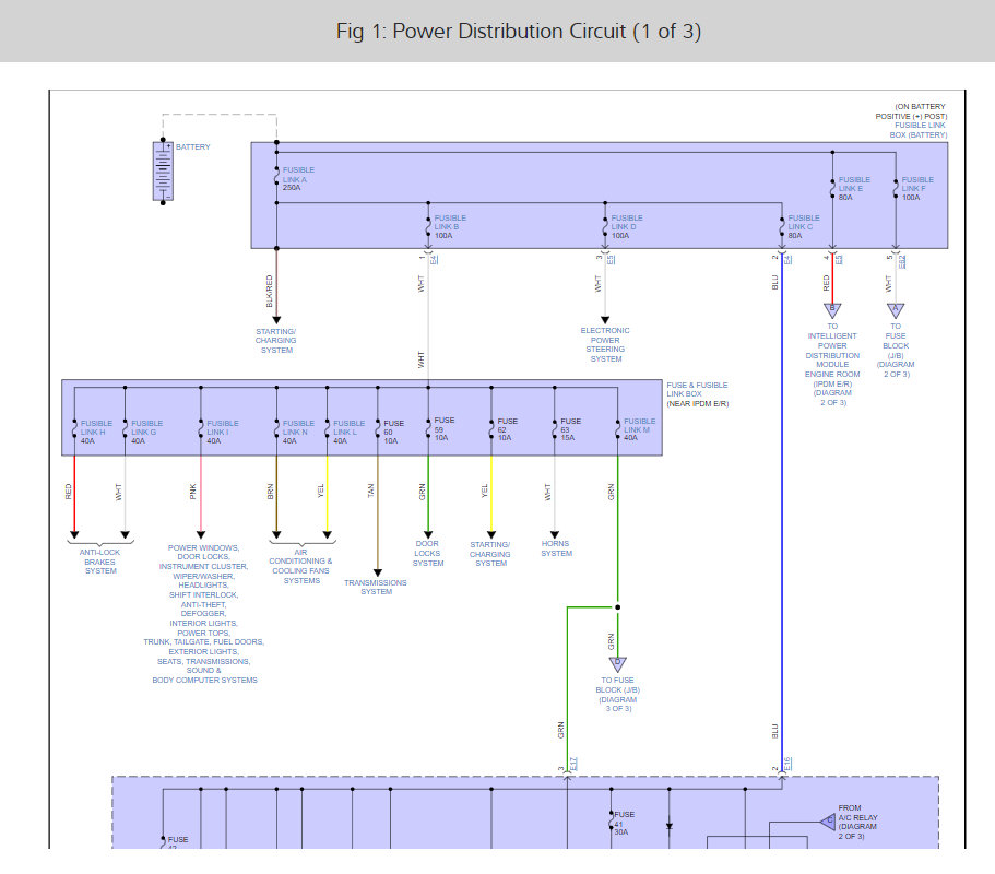

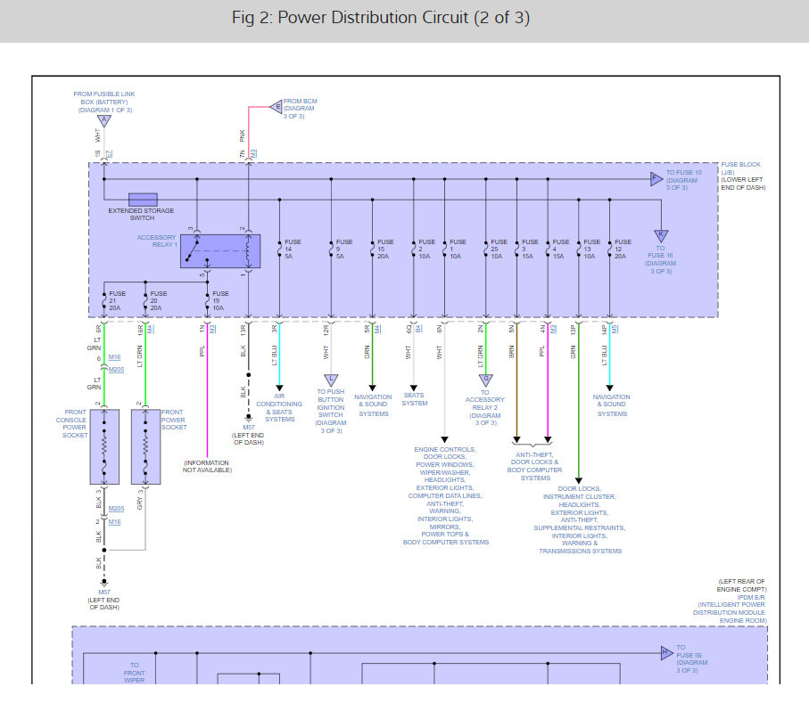

believe my compressor receives power however, the clutch is not engaging. I have performed the Nissan diagnostic, and everything seemed fine. After testing the power to the A/C fuse, which worked, I noticed that about half of the fuse box was out. I believe this may be why my radiator fan and A/C are not working. I attempted to replace some of the fuses that are out, but i have gotten no success. Please help!
Dan
Jul 5, 2022 at 1:15 AM
  • 55,579 POSTS

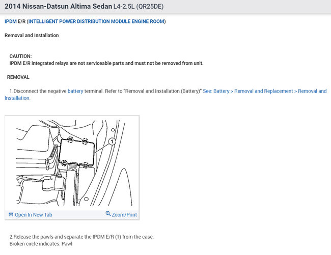

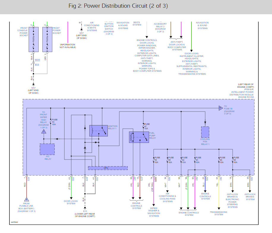

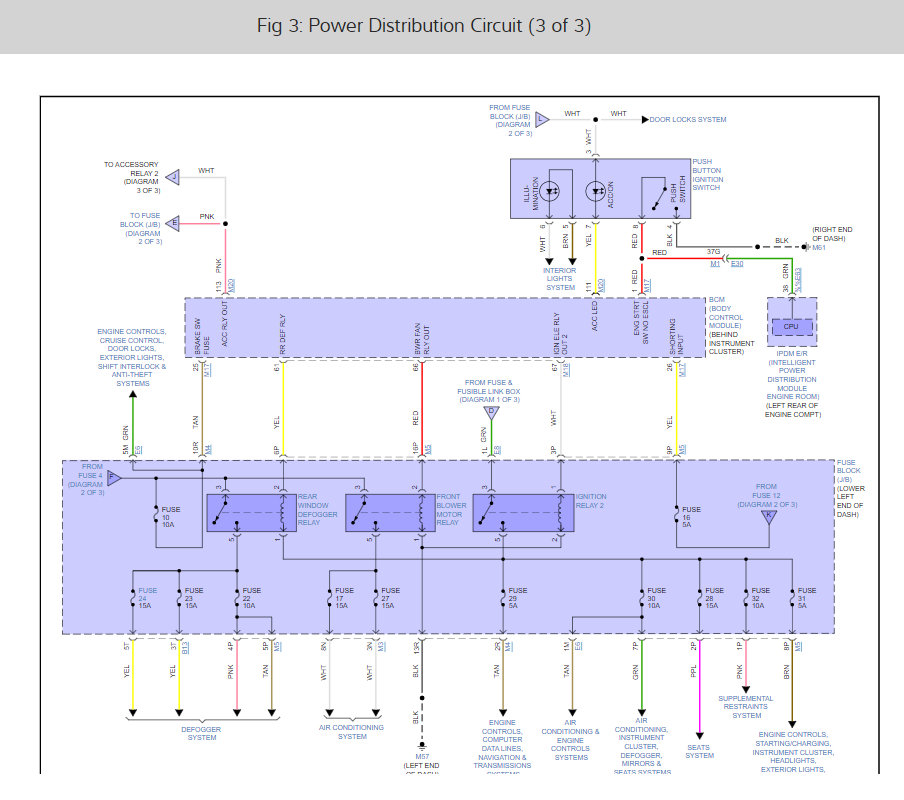

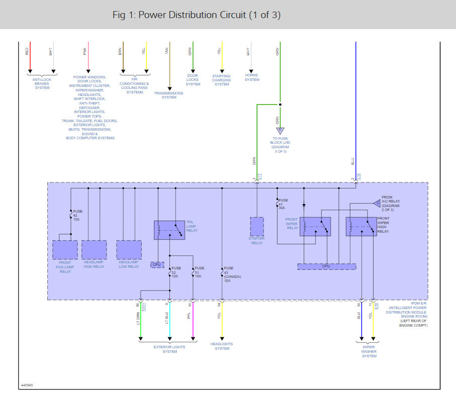

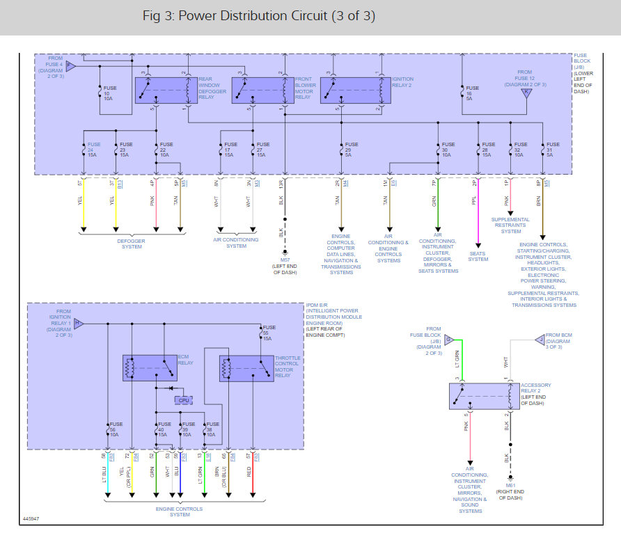

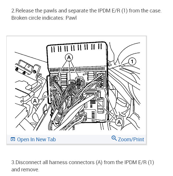

Here are the power distribution wiring diagrams with the fuses that need to be checked first with a guide to help, but I have seen the IPDM go out which is common but to be sure let's do a CAN scan which is the future of automotive repair you can get a CAN scanner from Amazon for about $30.00. here is a video to show you how and a link to a scanner from Amazon. I have included how to change the IPDM out in the diagrams below just in case you need it. It is easy because it-self initializes.
